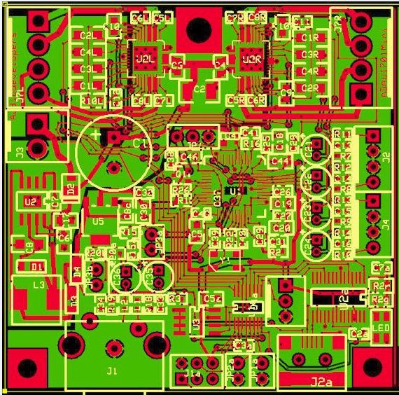

As promised, the first half of the design files - the Eagle files, including schematic/board/library. Files require Eagle 6.2 or later. There's a readme file in the eagle files zip which is a very rough draft of a manual - I wrote it originally to state the license, but kept on writing 😉
There's also a PDF file attached here with the schematic - this may not be 100% correct to the PCB (part designators may be different) but it might be handy to look at. Refer to the .SCH file for the official copy.
The design posted is almost identical to the "V0.99" prototype PCBs which I ordered, with a couple of very slight changes - I moved the DSP I2C connector slightly to the right (the terminal block interferes with it on the prototype), I removed the PCB order tracking number and I updated the board version from 0.99 to 1.00.
I still have to finish the SigmaDSP and AVR code before I release them. Biamp modes and equalization will probably not be working when I do release them - I'm planning to biamp my GT-1001/GW-1058 Boominator when it's built and I will have a suitable crossover/equalization setup ready at that point, but I can't provide the same for anything built with HP-10Ws etc.
Everything here is released under a Creative Commons CC-BY-SA 3.0 license. Hack away!

Well, decision time.
The current hardware will never be made into a product. The ADAU1592 chips are now officially obsolete, I can't buy them anymore. And the current method of changing DSP filter coefficients, which involves reprogramming the microcontroller, is unreasonable for 99% of people who would ever use the card.
I'll keep on using this card for my own purposes (the original design intent...) and if anyone wants a blank PCB and feels like sourcing parts themselves, I'll mail a card in an envelope for a few bucks.
If there's enough interest, I'll put in the work to make something that's a lot more consumer ready. I'd love to make a full sealed metal box with an IP rated connector or two on the outside (I've found some nice IP-rated D-sub connectors) that you can plug into a PC and set up, tweak live, etc. I'll warn though, it might not be cheap!

I've got a couple reasons for taking a digital approach with the original card - (1) ridiculous expandability/adjustability with the DSP (no need to replace components, etc), (2) repeatability (high order filters are tough to adjust), (3) power (DSP can replace dozens of op-amps, multipliers, etc and pull a lot less power in the process) and (4) I spent 8 years writing DSP code for a living, so I'm biased 😉
Anyway, I'm shifting gears on this project. I'll be working on a more customer-friendly Boominator card, or maybe even a few different versions of them with a different set of features. These will be made available for public consumption, I promise 😀

A few things happened:
- The card isn't user friendly at all. To make changes to the DSP processing, you need to buy an expensive DSP debugger, AVR programming pod and do a lot of work.
- The ADAU1592 class D amp chips used on the card are obsolete.
- I'm using this card myself (I originally designed it for myself), I'm content with it and I don't really have any motivation/reason to design another one.
- I worked on a few other design concepts for a while, including looking into bulk manufacturing of an "official" Boominator card. Unfortunately I couldn't bring the price point down to a low enough point where anyone would want to buy it. These cards would be made by the dozens, not the thousands, which means paying for domestic manufacturing - which is much higher than the chinese manufacturing costs everyone's used to.
I've posted the hardware design files on page 11 under a CC BY-NC-SA license, and I'll locate the software files sometime and release them. So anyone's free to take the design, modify it, and run with it.
