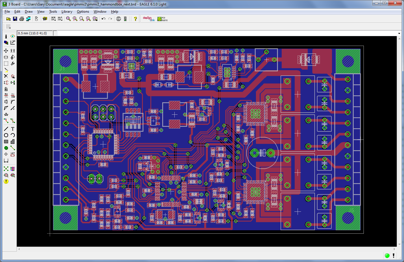

Snapshot attached of where it sits.

And parts availability on a couple of the DC/DC bits has forced me to rip up part of the design. It'll be done soon, I promise 😀

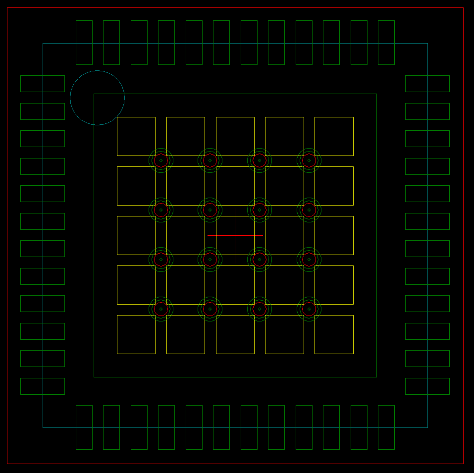

My only comment would be move the thermal vias apart a bit to allow solder between them, and to size the pads so that you can get a solder mask dam between the pins, this is critical for these devices to avoid shorts between the pads. Beware though most PCB manufacturers will cry and try and remove these solder mask dams when they front end engineer your Gerber data.
If you can find it IPC-7093 is an excellent spec covering all aspects of these type of components.
The picture shows the footprint I use for 7x7,mm QFNs' the yellow squares are where the solder paste is deposited, the thermal vias used are 0.25mm finished drill size with a 0.6mm land (IPC-class 3 compliant). This allows us to get the recommended 50-70% solder coverage of the thermal pad, and minimises the amount of solder that disappears down the vias.

Cool - thanks for that info.
Right now my smallest drill is 0.508mm, limited by the board house I planned to use. After reading your post, and talking to the PCB guy at my workplace, I think I might jump board houses.
Glad to help, I've layed out loads of boards with these type of devices, they are fast becoming the only choice with some devices. They are excellent for getting the heat out of the actual chip, they fix them to the thermal pad. But from an assembly point of view they are a pain, but having an x-ray ATE system helps. With the power devices getting a good joint between the thermal pad and the board can be critical for heat dissipation. The thermal pad to case works well, even though they are expensive, also allows you to have a totaly enclosed product to IP67, very waterproof. If you have a look at engine ECUs and similar, the cases are now being moulded with heat fins as an integrill part of the enclosure, free heatsinking and easy assembly, the pads also have some give so you dont stress the board. I always add mounting hole near any devices that require the heatsinking and where the pads are, you dont want the board to bend with theses components, the lack of any legs means the solder joints can be easily stressed if the board bows.
It a nice looking design.

A bit more info...sorry
by coincident someone asked a question about thermal design on a Electronics/PCB forum I frequent, so I thought the links I put up there will illustrate what I have said in more detail. The last link is specifically for QFN's and is a good read.

Thermal data for some vias...
0.5mm finished 0.025mm Cu plating min 176 degC/W
0.7mm " " " " " 102 degC/W

Whew. Layout almost there. Things left to do:
- Figure out QFN/MSOP-EP thermals
- Silkscreen. The thing's so densely packed that it's going to be a headache
- Pick a cheap but suitable board house to get the PCB made
- Probably start pouring some top side planes (power/ground/etc)
- Add some ESD protection to the control inputs/status outputs
- Clean up the schematic to make it 'shareable'
I upgraded my Eagle install to 6.1, using the freeware license. Turns out that the freeware tools only let you edit the first schematic sheet, and this project has two schematic sheets. Dunno if it's a bug, but you can actually edit the 2nd sheet via cloning and copy/pasting from the first page - pain in the *** to do, but it works. Hopefully Cadsoft leaves this 'feature' in there, otherwise I gotta find a way to move everything onto the first sheet.

Latest update:
I'm adding a header to allow plugging in an ADI "USBi" interface, allowing realtime adjustment/tuning of speaker parameters. I might also try to sneak an I2C EEPROM into the design for the SigmaDSP to boot from, allowing retuning without reprogramming the Atmel, though space is tight for that.
Still not sure what to do about QFN heatsinking. Vendors are recommending 0.3mm holes for heatsinking, minimum drill on the board is 0.5mm which is a limitation of most "hobby sized" board houses I normally deal with. I'm even contemplating moving that up to 0.6mm so I can get Olimex to build the board and save a few bucks. I'll probably swiss-cheese under the QFN and just fill the whole mess with solder by hand, and when/if volume manufacturing of this board happens, I'll work out a 'proper' QFN footprint then.
As for volume manufacturing, I really couldn't be bothered to invest time/money in taking orders, ordering parts, finding an assembly shop, etc - I'd sooner let someone else handle all that. If I can get enough interest from people, I might even pitch the idea to Sparkfun:

Board layout is DONE. Not quite cellphone dense, but it's close. Had to angle the board name/version/author in order to fit it on the board. The board name "BOOMINCARD" is just a placeholder, it's midnight here and I'm too tired to think of something more clever right now.
Smallest drill is 0.6mm, allowing the board to be built at Olimex. Two boards fit on a 30 euro DSS panel. Not optimal for manufacturing, but for prototyping, it's fine.
I added a 6 pin header which has the SigmaDSP reset and I2C pins. This allows the SigmaDSP code to be modified on the fly with SigmaStudio if you have a "USBi" interface. On that note I'm going to try building a USBi clone myself, but I think Analog Devices would kill me if I attempted to sell them.
Schematic... I created 2 schematic sheets in Eagle Hobby, then upgraded Eagle to version 6 which I don't have a hobby license for... and I can't get everything back onto one sheet. Once I get that figured out, and get the schematic cleaned up a bit, I'll release the design files. I'll hopefully get that straightened out in a couple of days.

I'm planning to tin the part by hand, tin the board and fill the vias under the QFN with solder, coat everything in tacky flux and use our BGA rework station (bottom heat + top hot air) to solder the part. This is only being done for two prototypes that I'm building, anything beyond that is getting built by machines.

Update: Board isn't done. Putting together a parts order now, just realizing I goofed on the LC output filter capacitor choice. Seems 1.5nF and 1.5uF are two different things, and one of them is a lot bigger than the other... d'oh. On a positive note, it looks like PCB+parts for two cards are going to be less than $100/card. Hoping that given enough volume, I can manufacture a card for the same.

Having a more detailed glane at the PCB are there a couple of little switchers on there for different voltages?
There's three:Having a more detailed glane at the PCB are there a couple of little switchers on there for different voltages?
- Top center/right: LT3652HV MPPT battery charger
- Top left: LT3680 DC/DC for +5V USB output.
- Dead center: LTC3103 DC/DC for +3.3V audio bits. Atmel AVR is run off a separate +3.3V provided by a small LDO.
