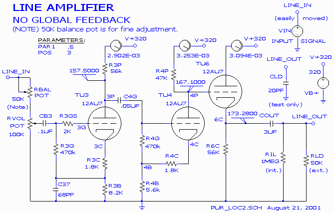

Purist 2 Line Amp
I built this Purist 2 Line Amp but omitting the first stage. I thought I don't need too high the gain.
The details are in http://www.normankoren.com/Audio/Spice_preamp_2.html#Purist
The difference between this with similar circuitry is that the first stage employs local feedback to reduce the distortion.

Hi Jonny,
My first post to this forum - How does your line amp sound? I've been very impressed with Norm's analysis of tube circuits and was wondering how you like the circuit. One fine day I'd like to build a copy of his "TENA" power amplifier - if I can ever get time!
