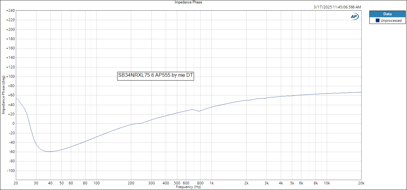

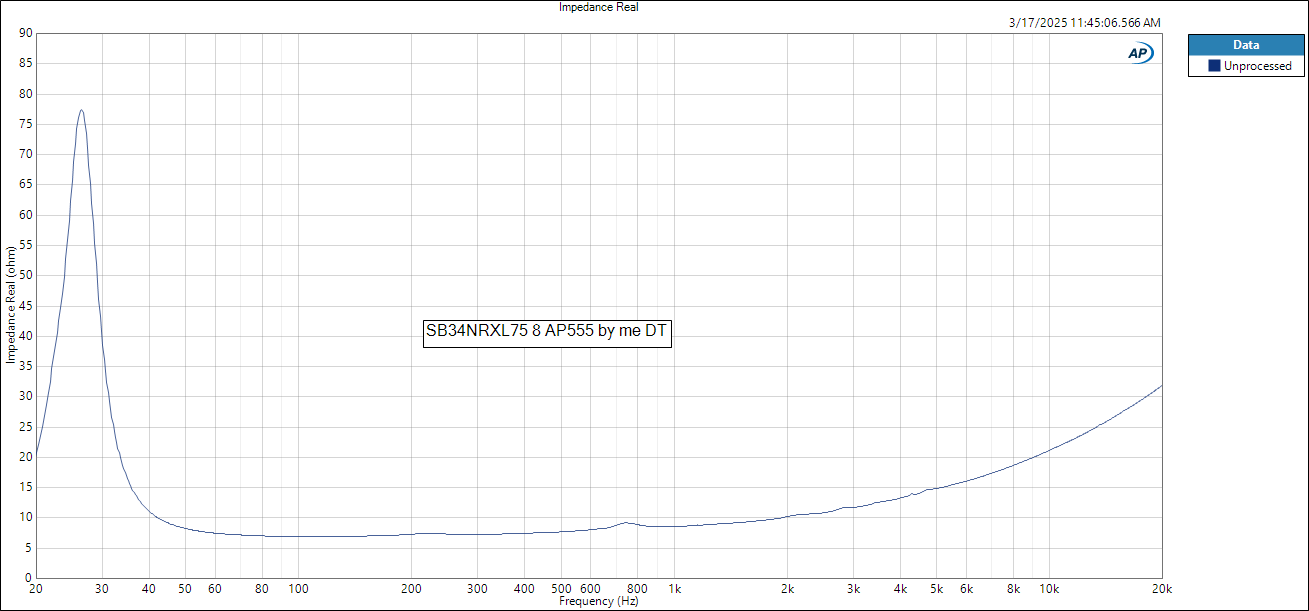

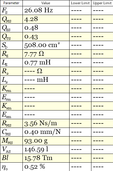

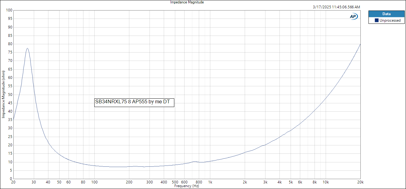

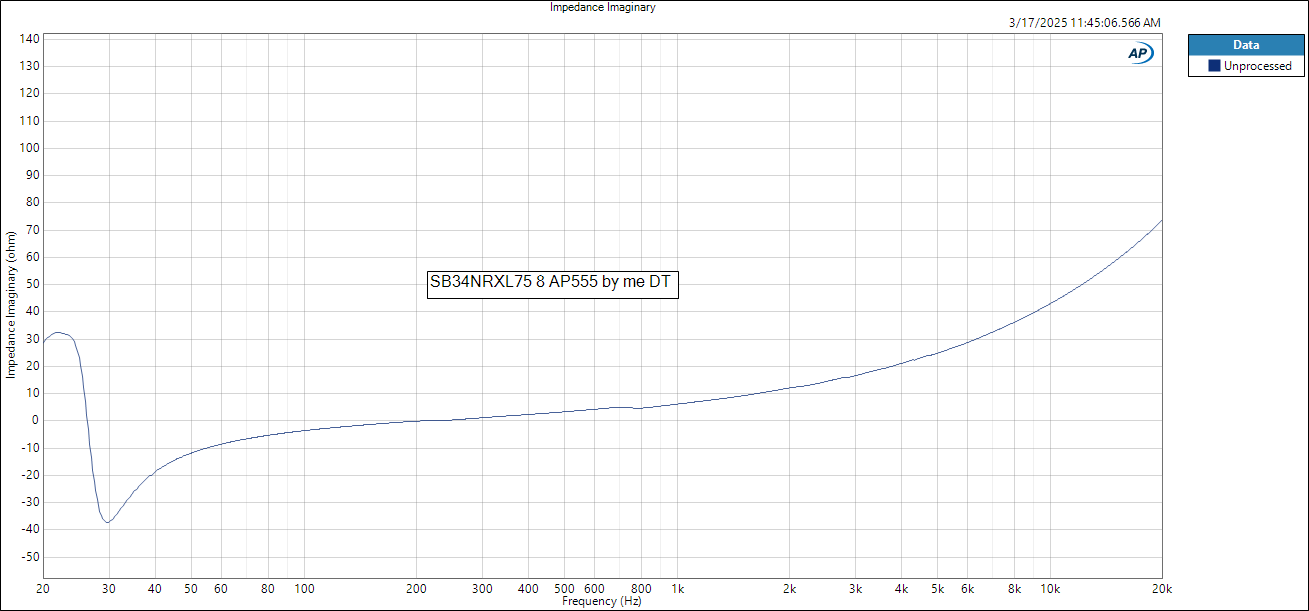

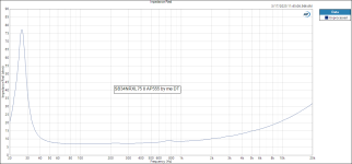

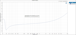

Hello All,
If you read the SB Acoustics SB34NRXL75-8 data sheet it notes that the T/S Parameters are measured after the driver is broken in.
I am not so sure about the break in, warm up sure makes a difference.
I made 10 or 20 measurements at 2 volts, the measurements settled in and held steady as shown in the plots below.
The driver on my bench:
The resonate frequency is 18% higher than called out on the factory data sheet.
Break in?
Time will tell.
Thanks DT
