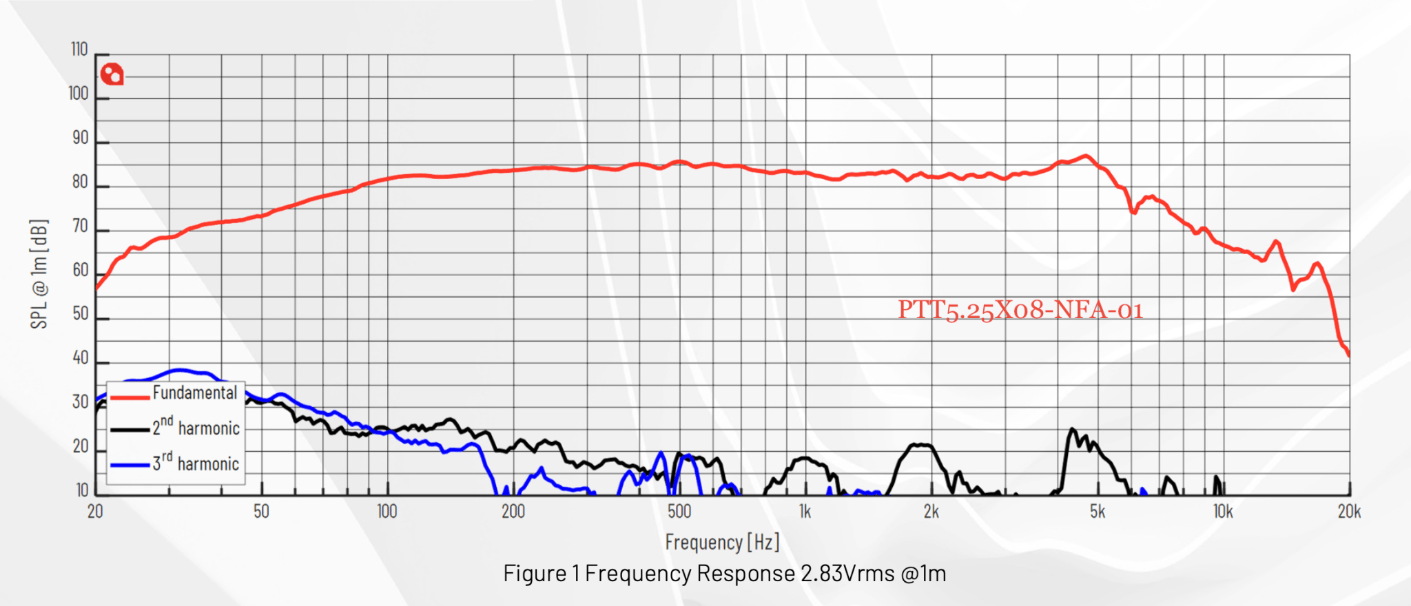

I think that half of what you are hearing is the mic system of my iPhone, which is optimized for Speech Intelligibility rather than Musical Accuracy.
The Purifi, to my eyes at least, has a shallow dip from 700Hz to 4kHz, and then a slight rise from 4k to 5kHz

Now I want to move onto more serious matters. Those measurements that Purifi posted are on an infinite baffle. That means on a baffle virtually approaching infinitely large, with none of the sound-waves being affected by the baffle edges or coming off the back of the test chamber towards the microphone.
Second, it is on-axis only. That is, directly in front of the driver.

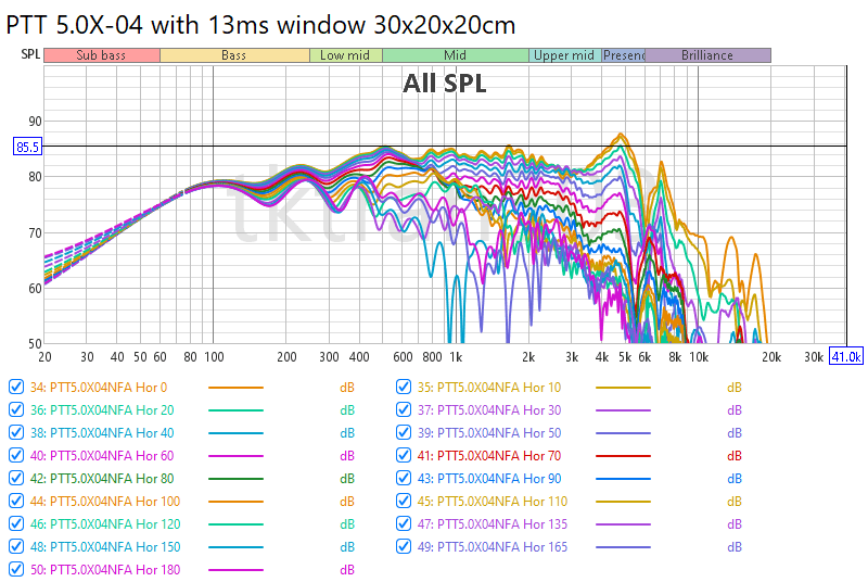

How big is your loudspeaker cabinet?
Here are some measurements of the PTT5.0X04NFA drive in a 12" H x 8" W x
8" D cabinet, with a 12"x8" rectangular baffle (no roundovers). If you cabinet is similar, your measurements will be similar.
As you can see, there is no droop after 700Hz; the baffle causes a peak. So between 500Hz and 2KHz it it pretty flat (+/- 1dB). There is indeed a peak at 5KHz. Furthermore, there is a loss below 500Hz due to baffle step. Adding another woofer, alone, won't help with the baffle step losses. You need baffle step loss compensation (2-way), or to low pass off one woofer above 500Hz (2.5 way)

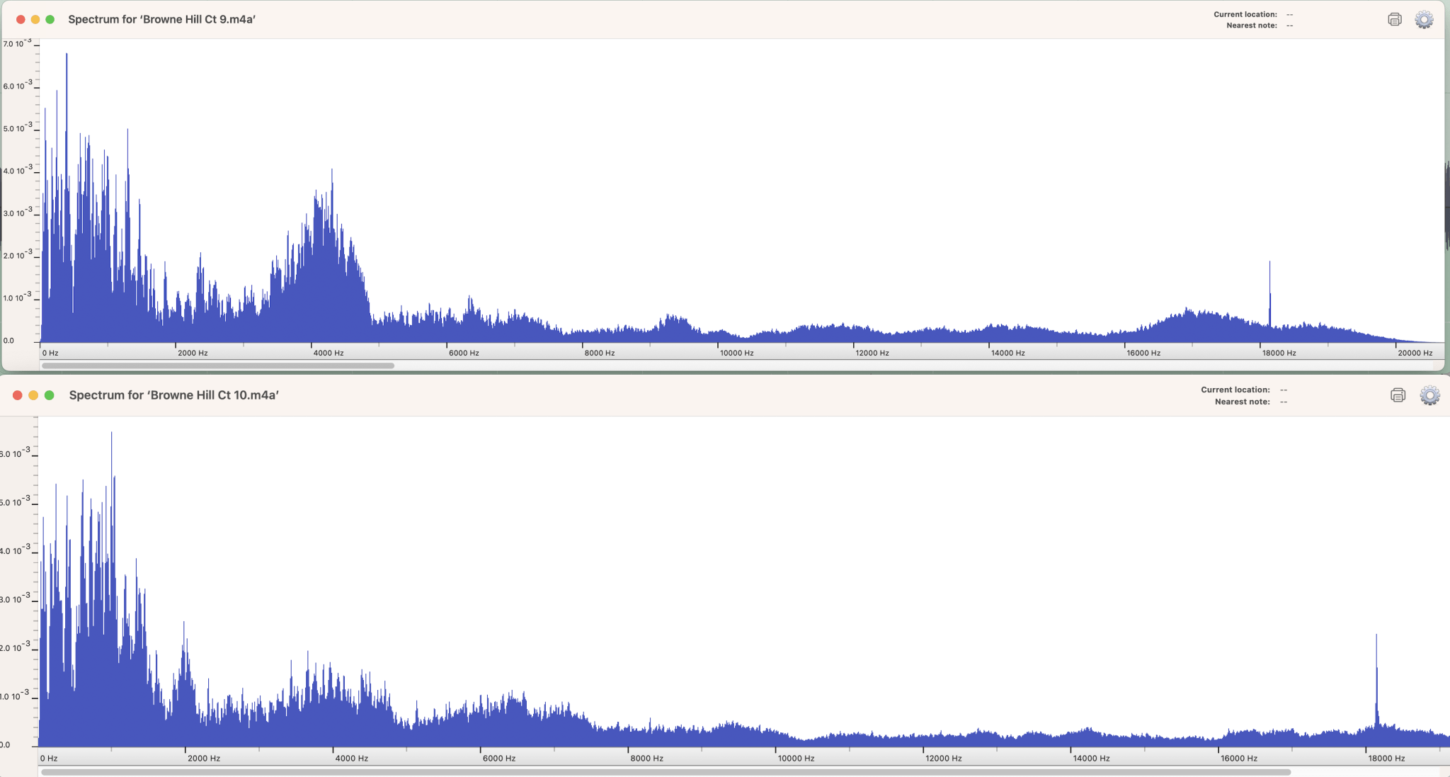

I did a quick Pink Noise recording 1m on axis and then I put the crossover on the woofer, and just as I expected, the overlap of the drivers had made a big peak centered around 4k. I somehow managed not to jump off the Newport Bridge. A very experienced conductor who has conducted all over Europe (and in New York and New England) once said to me, somewhat in exasperation, "You hear like a violinist. Violinists are always searching for the perfect note." As in, he did not think I am a big-picture guy when it comes to sound.

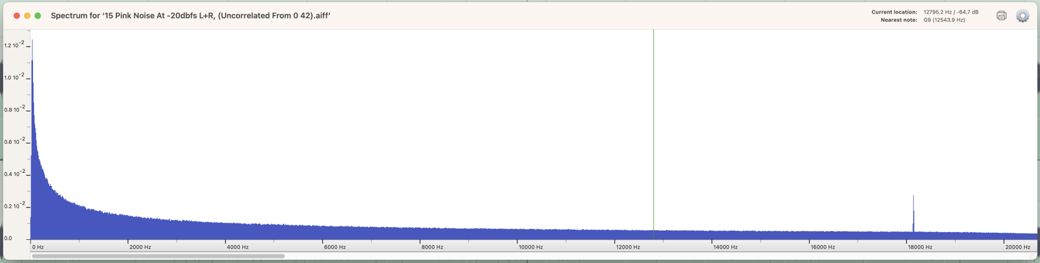

Oh, for comparison, here is a spectrum of the digital data for the StereophileTest CD2 Pink Noise, which is the best I have found.
With the crossover on the woofer, the loudspeaker sounded more like "Good Hi-Fi" and it had less of the "electrostatic" immediacy of the Running Wild version, and I am talking about frequencies all the way down to below middle C (Baroque bass lute).
The baffle is 8.5 inches which means that the distance from the center of the woofer to the (rounded over) edge is about the wavelength of 3.2kHz. So I have always known that there would be a baffle step issue. There's no question that Running Wild exacerbates female vocal sibilance.

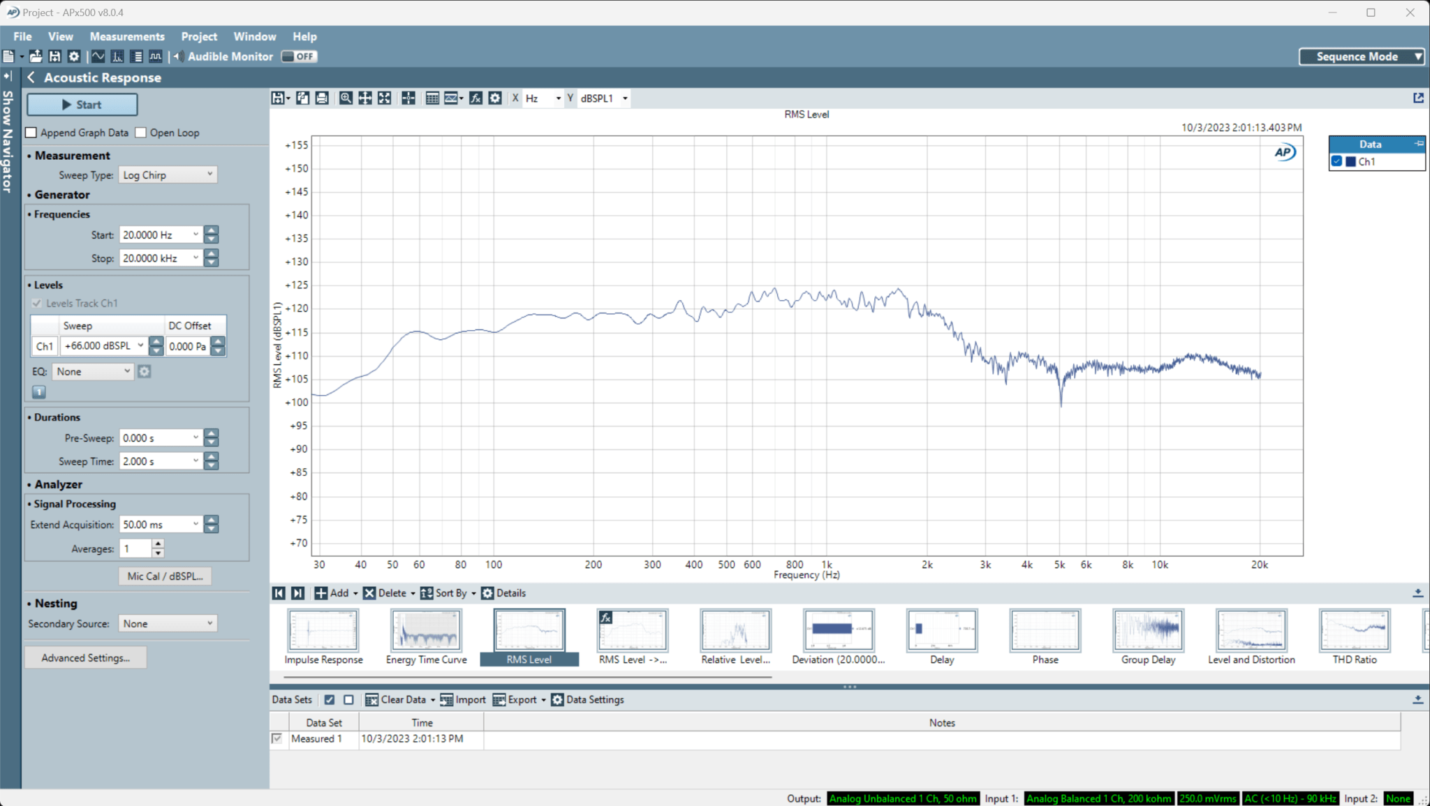

1) Jim Tuomy measured the Purifi/Fountek prototype:

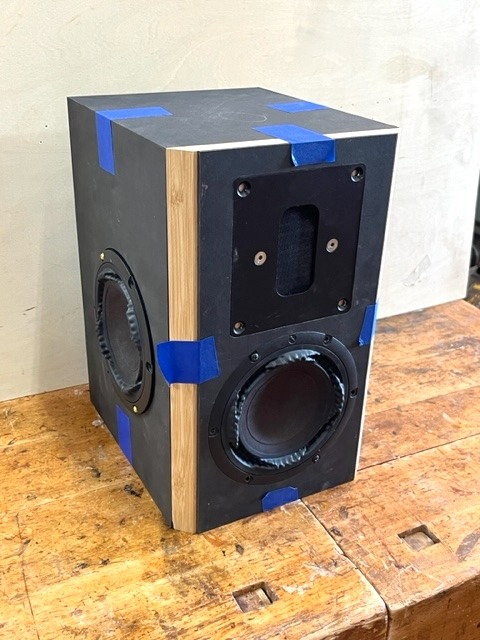

2) Jim let me know that he thought that the Fountek tweeter was not up to the quality of the Purifi woofer, so, we bit the bullet and switched the tweeter to the Beyma TPL-75 AMT, which is an amazing driver. The cost differential being $200/each, one would hope that it is amazing. Please note, the crossover at that time had three different sets of tweeter level-setting resistors.
Also please note, I of course know that the photo below is of the Beyma AMT with the since displaced Eton 5-312 woofer. The Eton woofer is there only for size. The cabinet maker lives some distance away and it was easier for him to use the Eton as a reference than for me to box and mail the Purifi woofer to him.
3) We then decided to switch from a port-with-cocktail-straws design to Purifi's recommended 2 X Passive Radiators. Which require a slightly larger cabinet. Jim Tuomy asked that we not offset the tweeter, so we changed that too. Also, this is the first cabinet where the shell and rear panel are solid Richlite, earlier prototypes had MDF shells. So this is a Richlite Stratum Bamboo composite front panel and a solid Richlite shell:
As soon as the cabinet maker finishes the rear panel mounting arrangements, we will acoustically treat the inside of the box and wire up the drivers and send the cabinet to Dennis Murphy of Philharmonic Audio for the crossover design.
We are hopeful that we can lower the crossover point from 2500Hz to 1800Hz.
