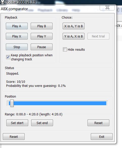

I time aligned OMNICRON/Pi to put this out of my mind, and just listened. ABX confirmed ability to hear difference. I didn't make subjective choice before results revealed.
Distortion spec for TLE2072 is certainly nothing special, but likely much better than distortion of recording chain. How this rolls into "sound" or "sound quality" loops into seeming endless topic, regardless of recording/playback chain.
For most, pure 2nd harmonic -36dB is somewhat above threshold of audibility with single tone stimulus. But being so far above TLE2072 spec strongly suggests poor plug and play implementation in swapping out 5532.

Poor "plug and play" sums this one up brilliantly. Given that many like the sound of equipment that lets say "emphasises" certain distortions I thought this would make an interesting test. Those with "cold sounding" amps might have warmed to the distortion added by the TLE2072. The stage is just the typical opamp output circuit in many a CD player, this one hampered by 5 volt rails although in stock form there doesn't seem to be a problem.

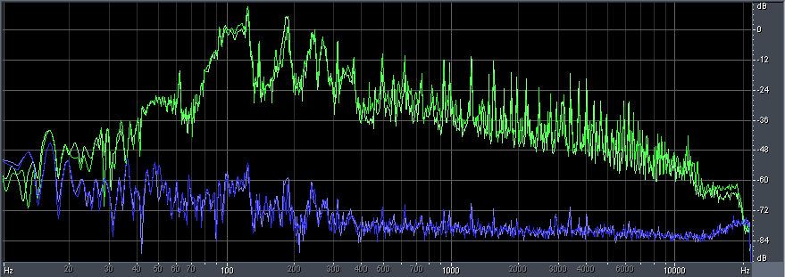

In case of 1kHz, and Audacity's 16k FFT limit, bin width is more than sufficient for resolving distortion limits of TLE2072 spec, and virtually any loudspeaker played at any level.
Sorry, sounds like empty phrases to me. Would you show any measurement like this made with Audacity?

I'm not advocating Audacity as tool of choice, but it is remarkably powerful, open source, and quite workable.
Here is 1kHz 0dBFS with 3khz -115dB with 1024 bin FFT:
A throwback to when digital tools were scarce, and very expensive. Since 1kHz is known stimulus a notch filter is applied, available as Audacity effect, and result becomes:
The notch filter is narrow and clean enough for resolving 2kHz harmonic too.
