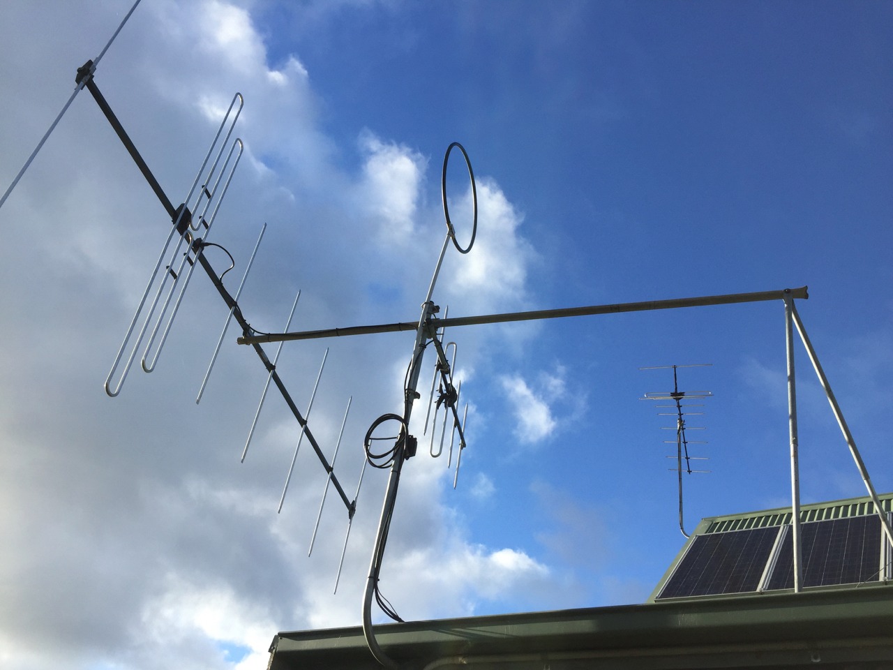

Thanks for the kink, they confirm what I said:
"...AM waves can be blocked by walls of concrete and steel, containing pipes and electrical wires- explaining why it’s so difficult to catch AM radio inside office towers and apartment buildings ... attaching a length of wire to the radio and hanging it outside as a makeshift antenna might also help..."
I have a screened loop antenna outside and it works just fine. It's the black ring middle top in the picture below.

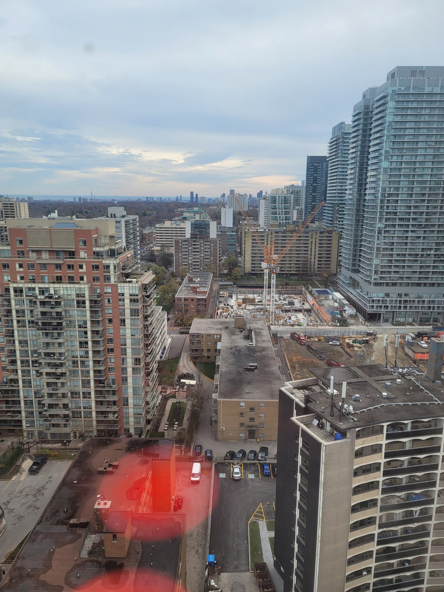

Nice array... You clearly live in a house and by the look of the sky you don't live in an urban city area... Here is a view from my window in November. As you can see, theres no room for any of that. I don't even have a balcony.
BTW, AM reception sucks in my car, too - at least until I get to the suburbs. AM sounds fine at my fathers house 12 km from here using the built in crappy antenna in the "7 tube and 3 diodes" table top radio I keep outside in the garage though.
True, I don't live in an urban setting now, in fact I am ~100km from the nearest city. However prior to this I did in fact live in that very city, and what's more owned a hifi store where I advised and assisted customers on how to get clean AM reception. Noise free AM requires a clean RF signal no matter where the the receiver is city, country or wilderness: the laws of physics hold for everyone in every place. BTW the signal strength in the city is likely 1000 times stronger than where I am now. What is important is that the antenna is outside of the faraday cage containing internal EMI noise generators where the receiver is (AKA your building, office or house). Clean reception can almost always be obtained within the intended service area of an AM transmitting service, with a suitable external antenna. The problem is not that physics is broken, but that AM radio reception is a lost art.
At my dad's house 12 km from here, I can use a garbage tie as a loop antenna and receive lots of AM in his living room on an 80's Pioneer system... I can receive AM outside but it isn't clean - there is 60Hz coming from everywhere when you live within a two minute walk of 20 condo towers 😀
The only way I could get a loop outside here would be to hang it out of the window on the wires and that would result in a letter from management asking me to remove it. Luckily, there's nothing on AM radio I can't stream or get on FM. They aren't even including AM in some new radios.
