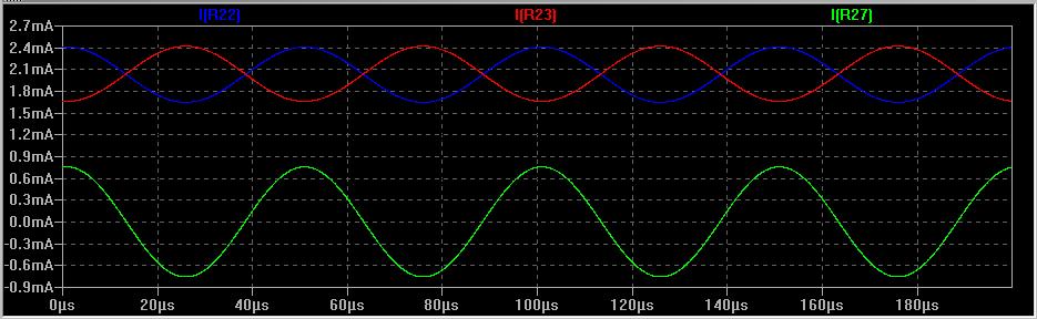

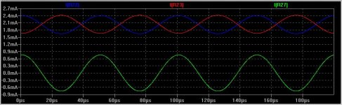

I think there is some confusion here about "balance" of the LTP leg currents.
The LTP's current balance is not effected at all by the input capacitance of the VAS (including Cdom).
So long as the base current of the VAS is small in comparison to the LTP tail current and the current mirror is adequately emitter degenerated, the average current flowing in each leg of the LTP will be close enough to identical.
As for the AC signal currents in each leg of the LTP with a current mirror "load", these are nicely complementary (equal in amplitude, opposite in phase), regardless of how much current is being delivered to the VAS to drive Cdom.
Attached below is a simulation result of a "Blameless" amp driving an oversized Cdom cap of 470pF 25Vp-p at 20kHz.
The red and blue traces are the currents in each leg of the LTP while the green trace is the drive current delivered to the VAS (predominantly to drive Cdom).
Note that because of the current mirror the AC signal current in each LTP leg only has to swing half the AC drive current required for the VAS.
Glen,
can you obtain a plot of the LTP emitter currents that flow and superimpose them on the collector load currents of that last graph?
I think you'll find that the emitter currents are not balanced.
Can you also show the VAS base current for your model?
I suspect it alone throws the LTP balance out by more than the 1% that Self says shows an increase in distortion cf good balance.
GK

AndrewT said:
Glen,
The VAS base current is approximately 10uA - over 400 times less than the tail current. The emitter currents of the LTP transistors will only vary from the collector currents by Ib.
For all sakes and purposes, the currents are balanced.

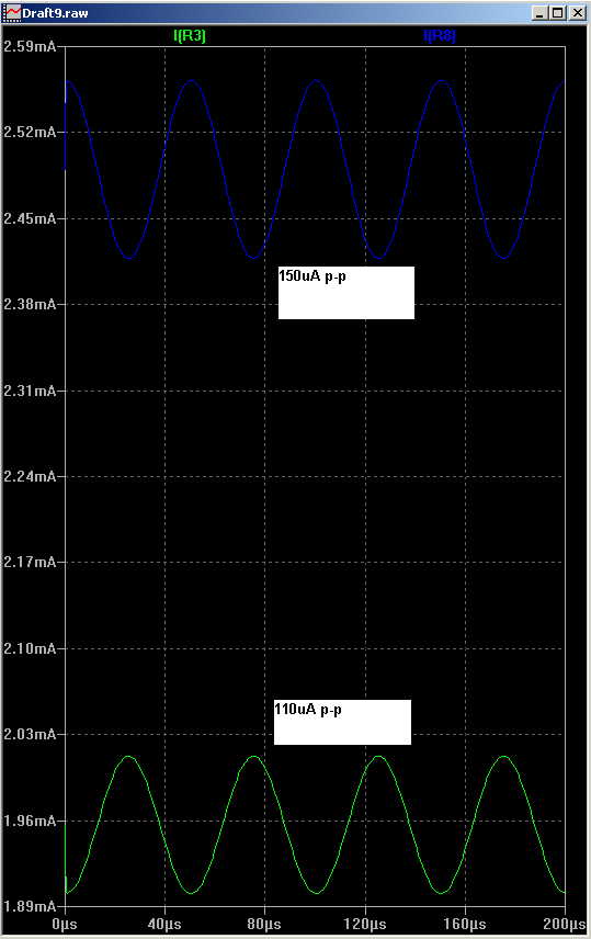

Well, by attempting to fix the DC imbalance by unbalancing the emitter degeneration of the current mirror you are just shifting the problem somewhere else.
Below is a sim of what happens when the current mirror is unbalanced to compensate to the VAS bias current. In this case I deliberately made a bad VAS with a bias current of 550uA to make the degree of error visible on the graph.
The green trace is the current provided to the VAS by the current mirror leg, the blue trace is complementary current provided to the VAS from the LTP leg.
The former has a DC value 550uA less due to the 550uA sourced from the VAS. The current mirror emitter degeneration resistors are 100 ohms and 73 ohms to make the collector currents of each LTP transistor equal.
The amplitude of the green trace is equal to the amplitude of the blue trace * (73/100).
The circuit is therefore incapable of providing an accurate complementary push-pull drive current to the VAS, a common-mode AC difference signal then circulates and the THD rises somewhat proportionally.
