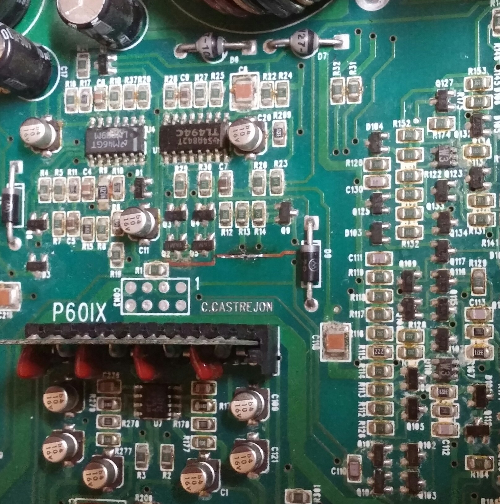

Punch 60ix
Board # 0764-f
Worked fine on the bench in stereo but, when installed mono, it acted like the power was "pulsing" as it would play shortly then off a fraction of a second and so on. The LED would dim and then brighten.
I found a burnt trace located in between the row of resistors R12-R14 and the crossover card.
Does anyone know what may be the cause?
I soldered the trace and it seems to be better now. I'll have to do more testing later. It did introduce a random "click" on the subwoofer preouts of my deck though. Reinstalled the original amp and the clicking remains...
60IX board
Uninstalled my head unit and discovered I may have used the power antenna lead as a remote by mistake. It may not have been the amp?
Disassembled it to find out the battery is dead in my meter with no spare. I may have isolated a defective diode before the meter went down but not sure. Back in my truck it goes until I get another chance to look at it.
