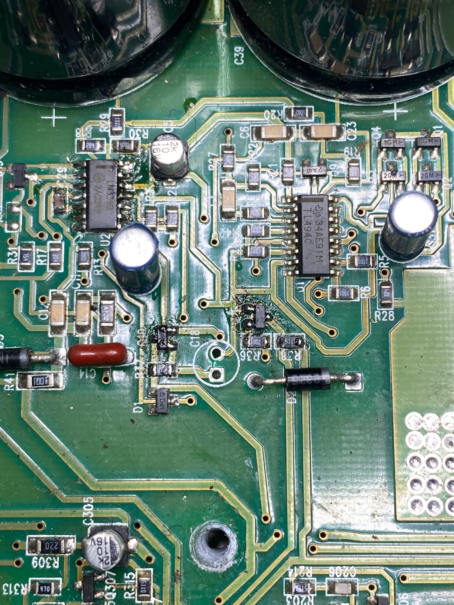

H Hexhclass Member Joined 2010 Tuesday at 10:38 PM #21 Tuesday at 10:38 PM #21 No audio P Perry Babin Member Joined 2003 bcae1.com Tuesday at 10:41 PM #22 Tuesday at 10:41 PM #22 Black probe on ground, DCV on each end of R37 with pin 14 lifted? H Hexhclass Member Joined 2010 Wednesday at 7:56 PM #23 Wednesday at 7:56 PM #23 0.032v 20.58v P Perry Babin Member Joined 2003 bcae1.com Wednesday at 8:05 PM #24 Wednesday at 8:05 PM #24 Pull C18. Does the voltage on the 0v end of that resistor go to near 20v? H Hexhclass Member Joined 2010 Wednesday at 8:18 PM #25 Wednesday at 8:18 PM #25 Voltage remain the same. Attachments image.jpg 1.2 MB · Views: 11 P Perry Babin Member Joined 2003 bcae1.com Wednesday at 8:47 PM #26 Wednesday at 8:47 PM #26 Pull R37 and check it out of the circuit. H Hexhclass Member Joined 2010 Wednesday at 10:38 PM #27 Wednesday at 10:38 PM #27 10k out of circuit P Perry Babin Member Joined 2003 bcae1.com Yesterday at 11:51 AM #28 Yesterday at 11:51 AM #28 Lift Q10 again. Does that allow it to pull up to the 20v? H Hexhclass Member Joined 2010 Yesterday at 5:04 PM #29 Yesterday at 5:04 PM #29 Measure voltage where after pulling the transistor? Leave the cap out still? P Perry Babin Member Joined 2003 bcae1.com Yesterday at 7:53 PM #30 Yesterday at 7:53 PM #30 On each end of R37. It needs to pull the base of Q10 up to drive Q11 on which drives the transistors in the tail of the differential amplifiers (in each channel) on. Prev 1 2 First Prev 2 of 2 Go to page Go You must log in or register to reply here. Share: Facebook X (Twitter) LinkedIn Reddit Pinterest Tumblr WhatsApp Email Link Home General Interest Car Audio Punch 601s Top Bottom
