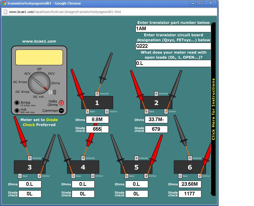

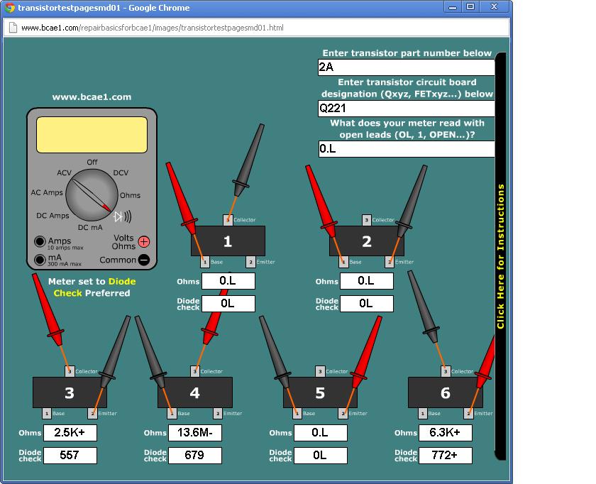

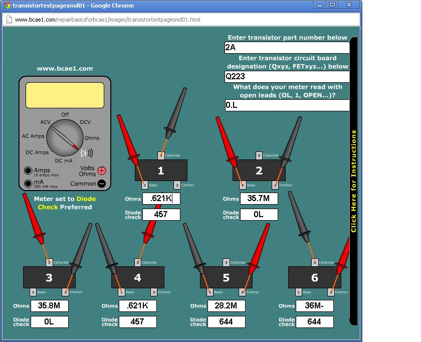

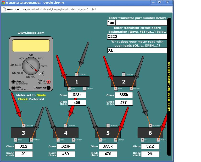

You need to check those transistors with the meter on diode-check and no power applied.
If you don't know how to test them, use the applet linked from the following page.
Basic Amplifier Repair - Transistor Test Applet Link
In order from top to bottom...
* shorted/leaky
* open base to emitter
* probably OK but slightly leaky collector to emitter. Could have been caused by touching the probes
* also appears to be leaky
I'd suggest replacing all of them.
* shorted/leaky
