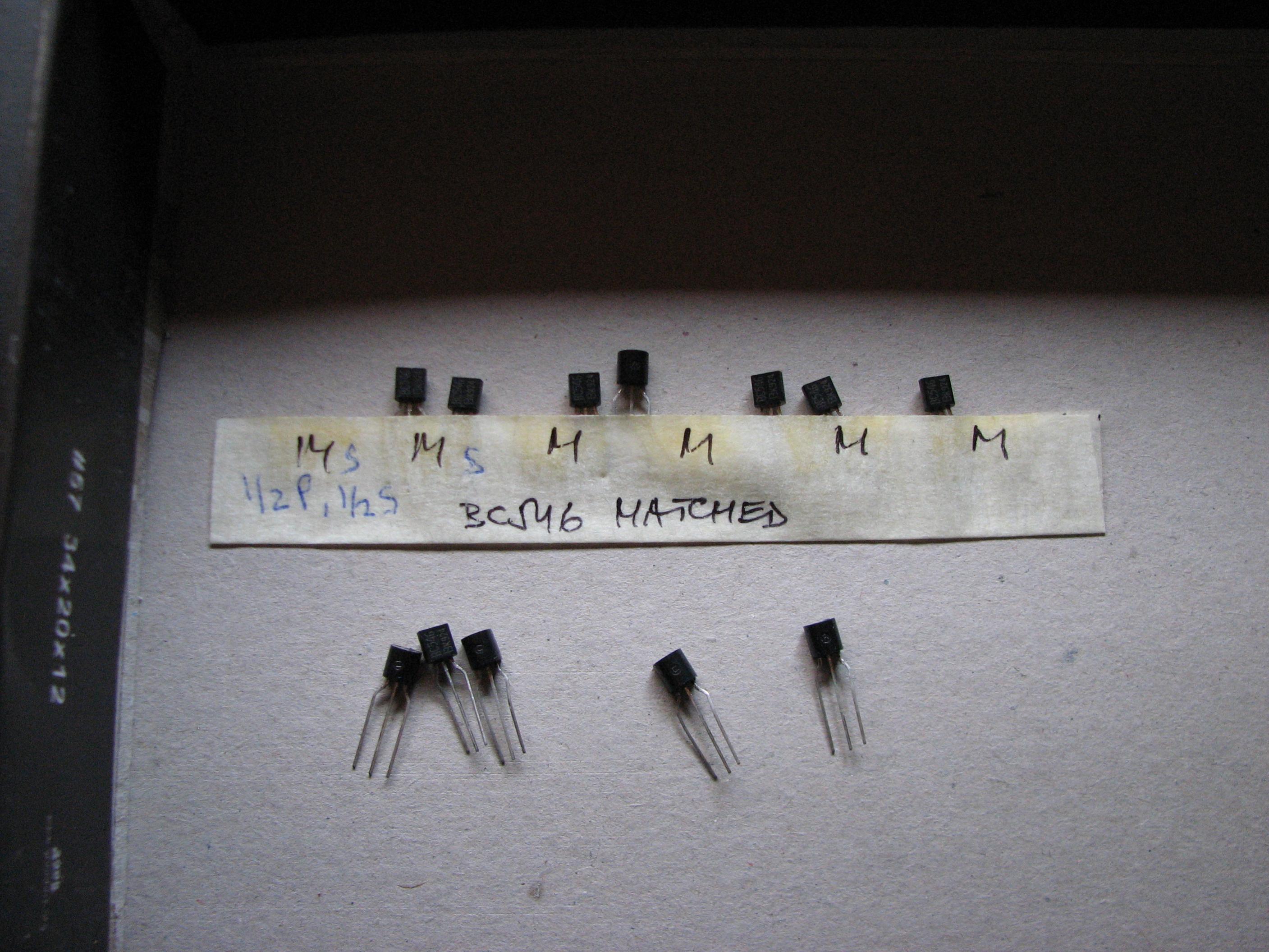

BC parts are bjt , so no JFets
as I said - toss them in circuit in random fashion - no change
or match them on HFe test with your DMM
I'll see instructions with my DMM. If nothing else, I will use as is, hate to not have them with your matching, knowing parts are there, plus I will learn something if nothing else!
I see from google search there is much info, even if instructions are elusive...on with the build.

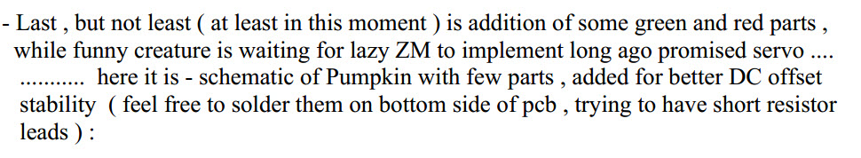

Zenmod, another question on resistors. It concerns Shunty R3, R3a, R6, R6a.
The chart in your cookbook call for 150 ohm to 240 ohms. In the Pumpkin I see a similar deal with R9, R10, R14, R15, R19. what determines the value in Shunty? In Pumpkin? (havent looked at Pumpkin that hard yet, still on shunty)
I am also a little confused with the circuit diagram showing red and green resistors?

Does the range of all these resistors mean "anything" in that range one has on hand, or is there some criteria in value selection? both numbers given and red and greenies? I should have asked question better, it selection of the values that I am asking about.

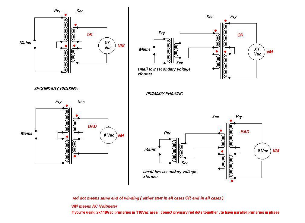

I'd like to double check how to wire transformers - I picked up 4 of the Mercury Magnetics TA-110W from ApexJr, so 2 per shunty. Each one has a 0 - 43V secondary, so to wire 2 together, I would wire the primaries in parallel and the secondaries in series, right?

prior to connecting secndaries to pcb , you must correctly phase them
as you said - primaries in parallel , secondaries in series
measure with Vac meter opposite secondary ends ; if you have double voltage then phase is ok ; if you read almost 0Vac , phase is wrong (in which case just swap leads of one secondary and retest)
when you're sure of phasing , solder to pcb
attached pic made for solo xformer , but same logic applies ...... once when you wire pry. in parallel and connect secondaries in any way , that's practically one system
Got it. Thanks for the sanity check, Zen Mod!

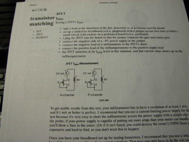

matching mosfets for Pumpkin
Hi Zen Mod -
I'm ordering parts for the Pumpkin boards, and I just realized I'm going to have to match Q5-Q7 (IRF9510) and Q6-Q8 (IRF510). I've never done this before, so a couple of ?s:
- What is a good number of each to buy and test to get the 2 matched pairs needed?
- I've read the Pass article on matching (https://www.passdiy.com/pdf/matching.pdf), so my plan is to use a Shunty as the power supply, but what current am I aiming for? Or is there a better way to go about this?
Any clues appreciated!
Tod

if you get them ditto from tube , there is a chance that dozen will give you two decent pairs
completed Shunty is perfect for matching PSU - mosfets need to be matched in range of 30mA
if you need further help , buzz
