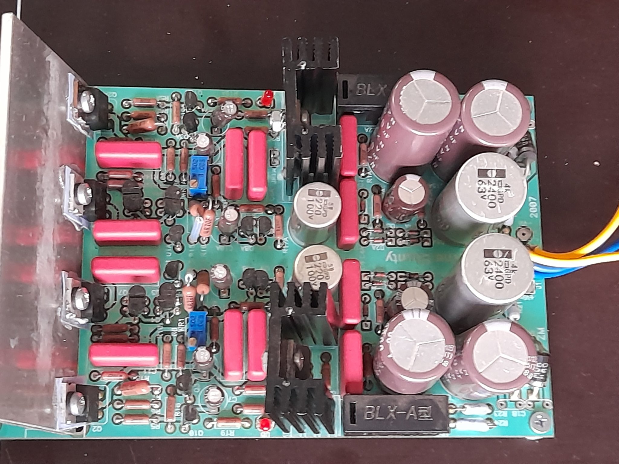

I reheated all the soldering and the + rail that was wobbly seems to have settled. It does wobble a bit when you touch the screw on the 3296 potentiometer, but I assume that is normal (not sure which brand I used).
Pumpkin
I tested the voltage of the leds I used, and they were all within 1.8-2V, so did not replace them.
The voltage between the output caps is nicely 0, but voltage between GND and one cap remains a about 20V after the 25point turn pot clicks.
Given that there are output caps and I started this preamp long ago, I decided to try playing music anyway, just to see if it at least made music.
I connected it to an old squeezebox and Aleph J, and the hum was quite bad (volume at minimum, source not playing). Hum increases as volume is increased (source still not playing).
We then tried some music and it sounds very promising! If only I can get rid of the hum.
A few notes:
My pumpkin is set up for high gain (for F4). I changed R5/R6 to 150k (from 100k) and decreased C1/C2 to 3.3pF (from 5pF),

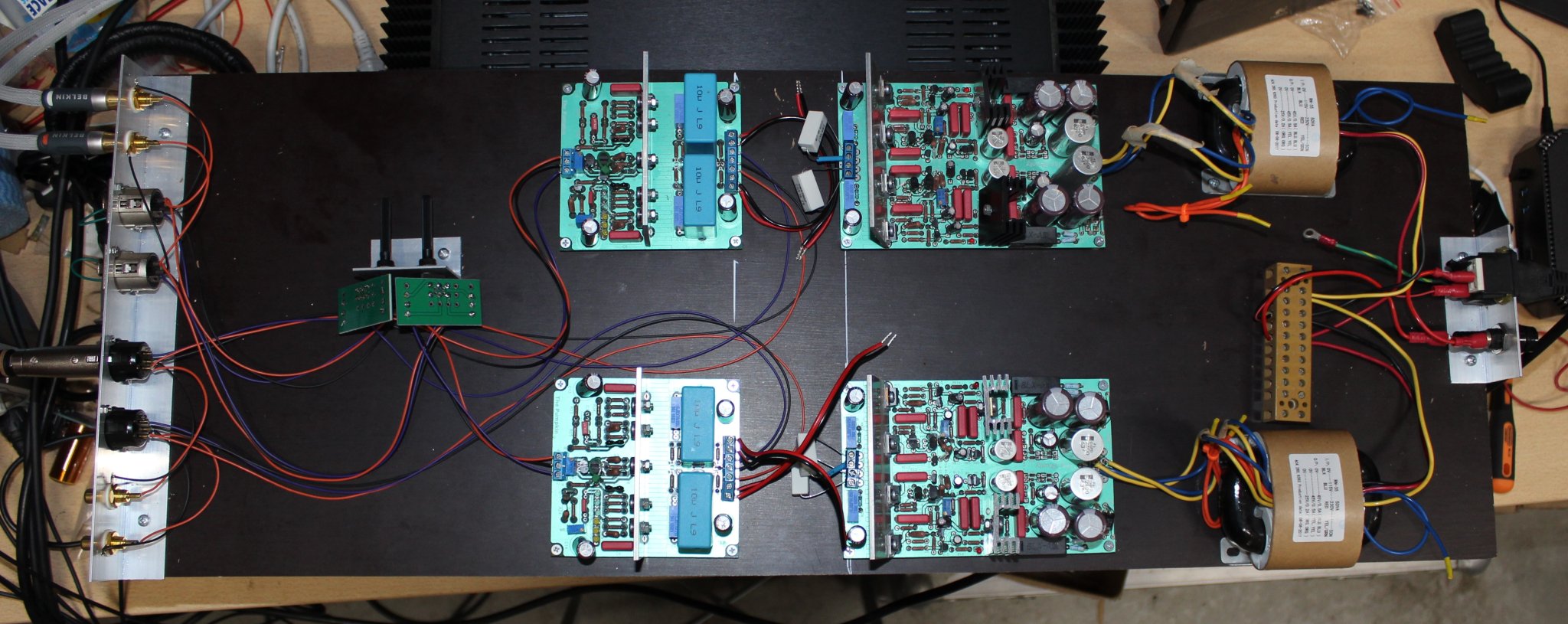

A few notes:
All parts are screwed to a long piece (>1m) of formply (plywood with coating, used in concrete industry) for testing, so not installed in a case. From left to right:
- Aluminium bracket with mains input socket and fuse
- terminal block connecting mains to transformer primaries (secondaries soldered to the shunty boards)
- 2 x r-core transformer (each rated 2 x 45V 0.5A)
- 2 x shunties
- 2 x pumpkins
- 2 x 25k (cheap) stereo volume pots
- aluminium bracket with cinch and xlr inputs and outputs
Two questions
1. How can I make sure my shunties are behaving themselves and not the cause of the hum?
2. What can be the reason I cannot get the voltage anywhere near zero between GND and any one of the output caps?
gimme pics of entire build, even if it's temporary
you shouldn't attempt listening without setting it properly
so, expect me asking for some measurements, but pics first

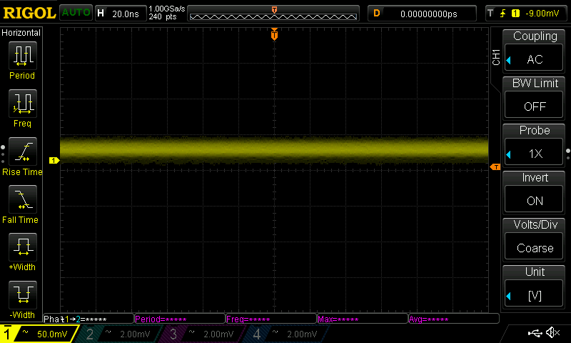

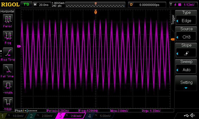

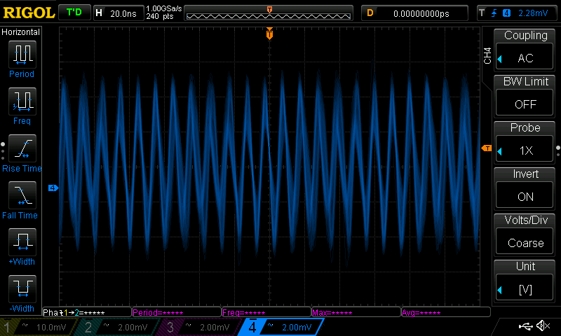

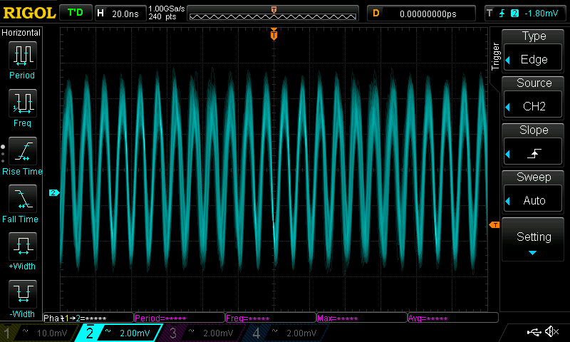

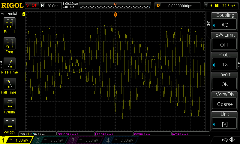

Anyway, I thought I would have a look at the Shunties first. It is years since I used my Rigol DS1054Z (I don't have much experience in using it) but I wanted to try it anyway. Note, no load.
These are the waveforms I got:
Shunty B NEG (CH4) and POS (CH3).
I have no reference, so have no idea if these waveforms are expected for the Shunty. I interpret is about 10mV p-to-p at a very high (MHz) frequency. I noticed my wheelchair produces a lot of RF noise, so did not move the wheelchair while making these measurements.
To me, the NEG waveform looks better than the POS, but this may be an artefact due to the color.
Shunty A NEG (CH2)
This waveform is similar to Shunty B NEG.

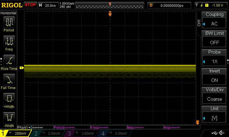

Shunty A POS (CH1)
I had trouble triggering on this one, as the voltage fluctuated and I could not get a screenshot at a low mV division. It had calmed down for a moment when I made the 50mV screenshot, but I was able to capture the wider spread later, at 200mV. I have attached 2 screenshots that show how wide the noise is. I also include a single shot.

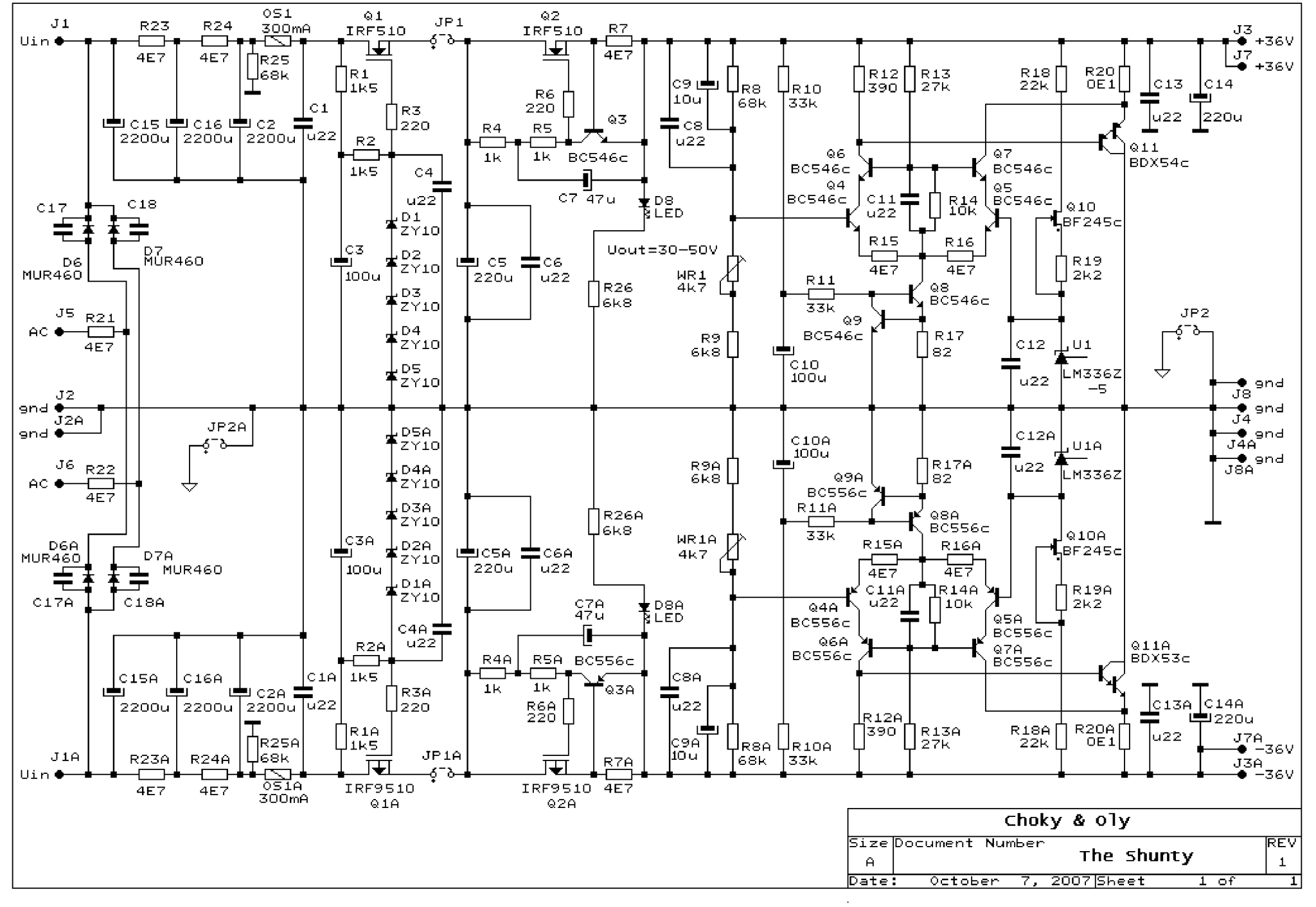

now - Shunty - solder 1nF cap (type not critical, 50V) between B and C of each final darlington (Q11, Q11a); you can also increase R16 & R16a from 4R7 to 100R, that will most likely cure any possible oscillation

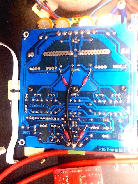

hard to wrestle with old pcb files (program I'm not using anymore) to get proper screenshots
anyway, all ref. to schm posted in #3557
1. green marked - 15K resistors:
take standard 0207 size
first - on bottom side of pcb, solder one end to mid pin of Q6, other end to mid pin of Q10
second - on bottom side of pcb, solder one end to mid pin of Q7, other end to mid pin of Q10
2. red marked - 220K resistors:
first - on bottom side of pcb, solder one end to inside pin of R1 (pin oriented to center of pcb), other end to input GND pad, on input edge of pcb
second - on bottom side of pcb, solder one end to inside pin of R3 (pin oriented to center of pcb), other end to input GND pad, on input edge of pcb

someone ( who took that photo) added that wire from reason unknown to me
it is not needed, if pcb is not messed with
Photo was originally posted by tominxp back in 2013 with explanation for black wire ....
