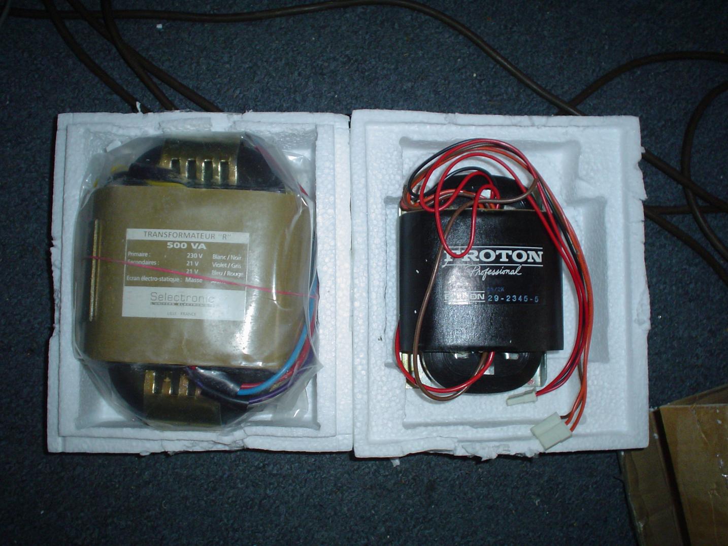

No, i added the 500VA Selectronic to give a size comparison image.
The Selectronic R-cores are made in India, Proton had theirs manufactured in Taiwan.

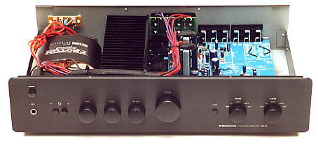

The Proton amps weren't half bad in the '80s and '90s, the one sold at THL belongs to an AM-S3 model.
The air ticket to Holland for the number i bought would have amounted enough to choke me.
As an exception, THL was willing to send them by boat, cost little dollars for such a heavy box, but took many months to arrive.
Whenever i need something from Selectronic, i drive over to get them, only a couple of spares (rewired two of these for the Bruno amps)

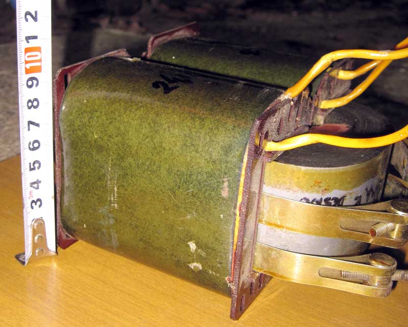

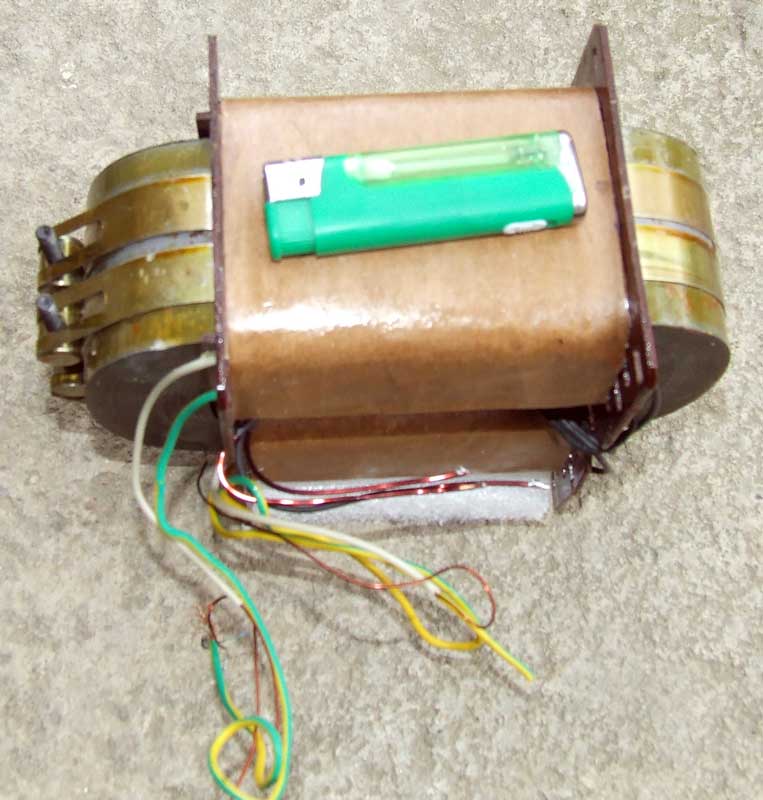

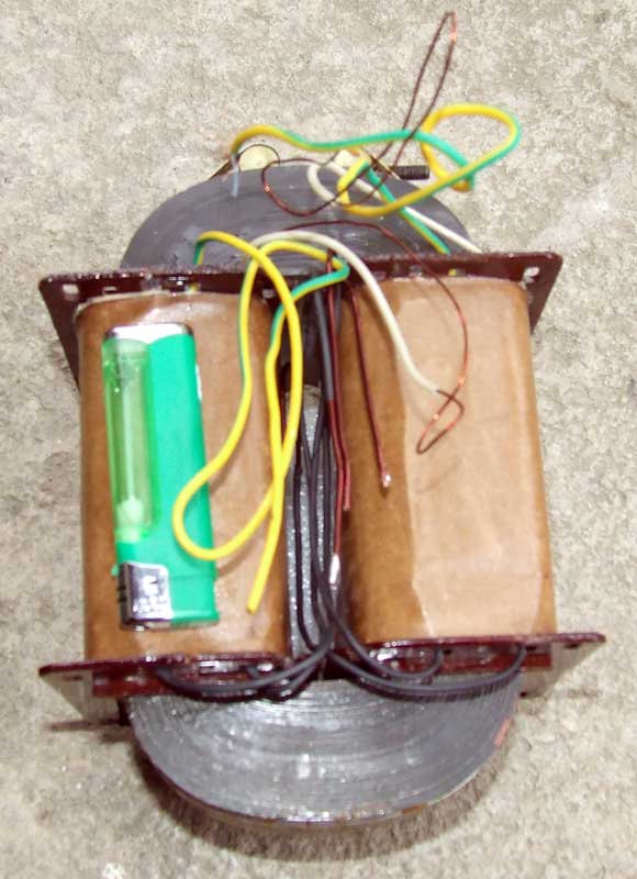

now pics of Real McCoy
baked , with yelling green wires for static shield
twice 110Vac , twice 18Vac , wound for 300VA
core for lazy flux ...... one dang per channel ......

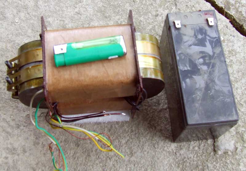

lighter and 12V/7Ah accu for size comparison
