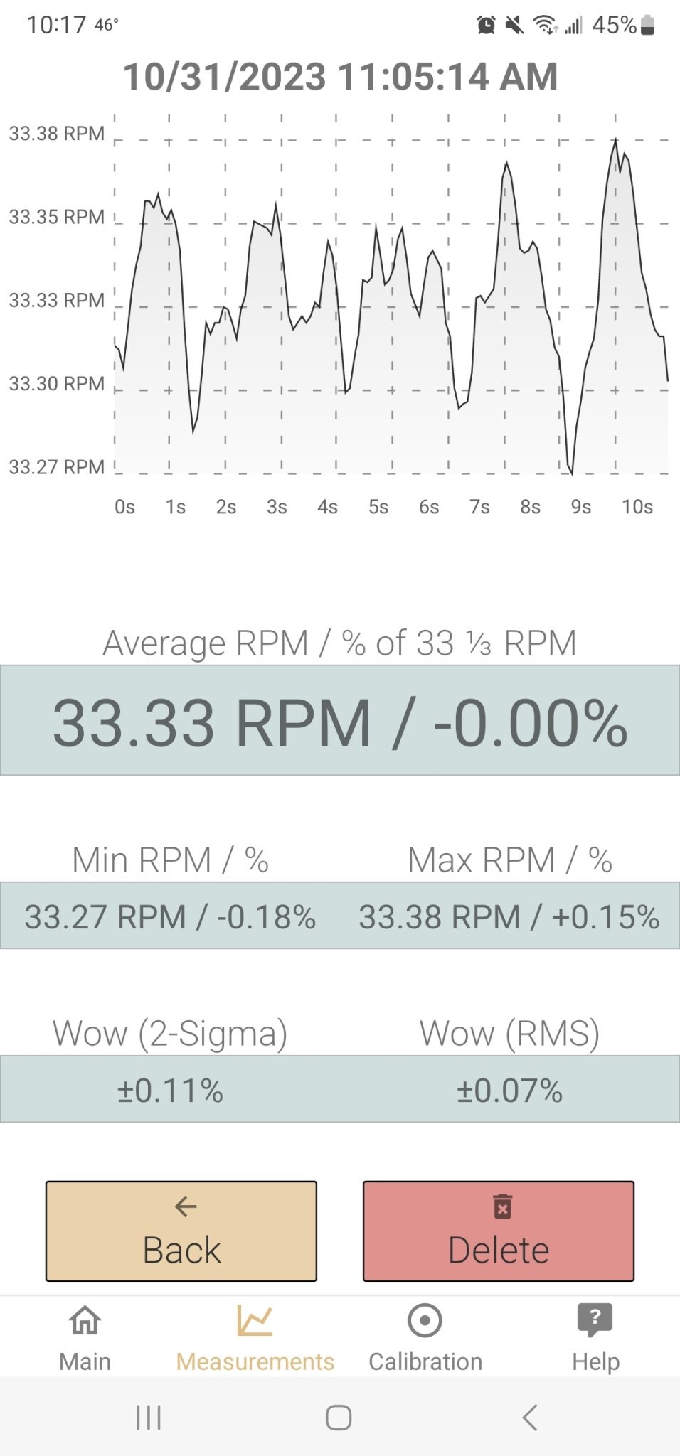

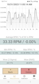

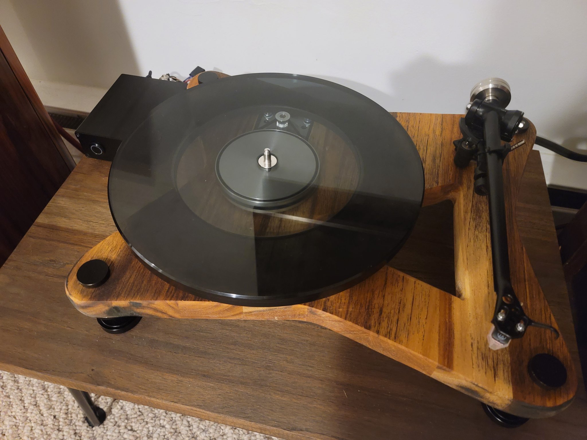

I went down a rabbit hole with my custom belt drive turntable, testing various combos of belts, belt material, and pulleys. I came to a couple of conclusions. I built an Arduino speed controller with SineWave/SpaceVector control of a 3 Phase motor for very stable motor performance, so focused on the belt and pulley to really get the last bit of optimal speed control out of my system.
My observations:
1) round silicone belts are terrible for speed consistancy, they move A LOT
2) EPDM round belts are pretty good
3) dual round belts are better than single belts, but have weird spikes in speed stability
4) cheap flat belts are better than round belts, but require a pulley that can keep a flat belt centered.
I have a very nice crowned flat belt pulley, but the one pulley that provided the best performance? A GT2 timing belt pulley. WITH RIDGES!!
I am wondering why. Does a smooth flat belt pulley load a lot of the tension at the two ends (aka stretch before the belt engages the pulley, slack after it releases)? Is a timing pulley performing better because the gaps during rotation allow smoothing of the belt tension during pulley rotation?

Rather than being the ridges that caused better performance, maybe it's the 'crowned' pulley causing worse. Did you try a cylindrical pulley with side flanges to keep the belt centred (like the ridged pulley)? I suppose this isn't a good idea generally as the belt might make noise rubbing on the flanges, and this friction also might affect speed stability. But just a thought.
One other thing that might be an issue is a slight whir from the ridges, being transmitted through the belt to the platter. Just putting that out there; I know it's probably unlikely.

Just a note, your 33.33 may be spot on, but the Wow at 0.11 is way TOOOOO high. Mine is 0.06 using a DC motor.
Also the speed on that app is not correct, at least on my mobile, measuring about 2% slow according to two of my other T/T's with strobes.
I am using a 3 Phase Brushless DC motor. I can actually get the WOW down to 0.05, but that requires running a bit more current through the motor and it gets warm/hot. Totally fine for the motor, but right now I am trying to optimize as much as I can running at a lower current.
And I listened to both what I have it at now, and running hot for extra motor control. I really did not hear any difference at this level. I did hear significant wobble on sustained notes when the wow was up at 0.20 with initial un-optimized settings, but I adjusted my motor control to get it down.

yes, that type of pulley made the flat belt move up the flange. It needed the crowned pulley to stay centered.

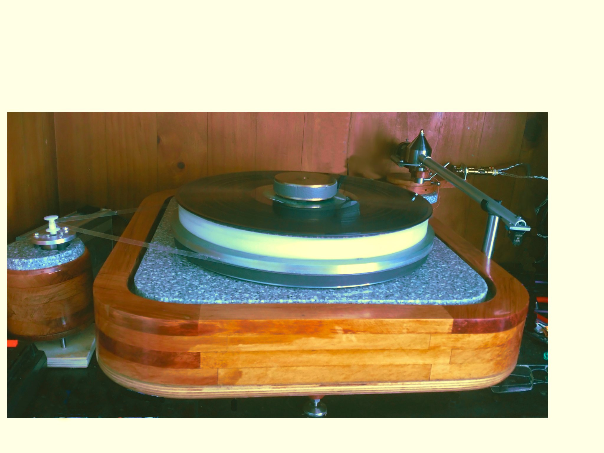

Hi, Always the key to a DIY T/T is to 1st use a HEAVY, Balanced platter. That ensured that the rotation is balanced out, due to the rotation torque of the platter, once spinning. I use a Lenco 78 balanced platter with my Mylar belt going around its periphery.
I have also tried various string belts & have got reasonable performance from them. (but not as good as Mylar) The main trick with these is to make them at least 4 looped lengths of the perimeter, then the effects of the knot is essentially, but not fully minimized.
Cheers

Thread Length. Pete. All you need to do is cut the length of thread 4 x longer, Then Loop them into the into one length.
Platter design. Mark, completely an option. just a little harder to get the top platter aligned correctly. I have done one similar with pointed grub screws.
