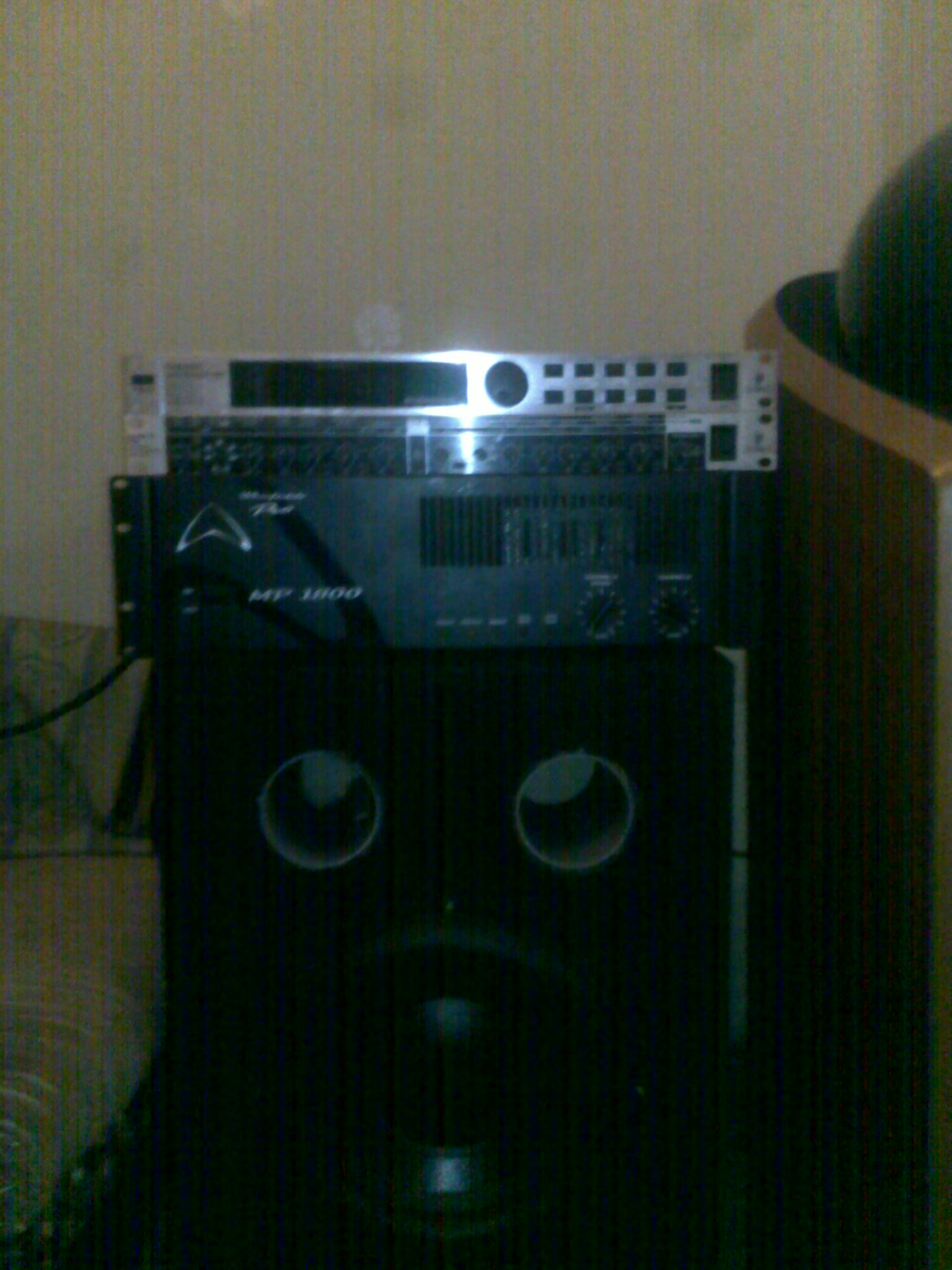

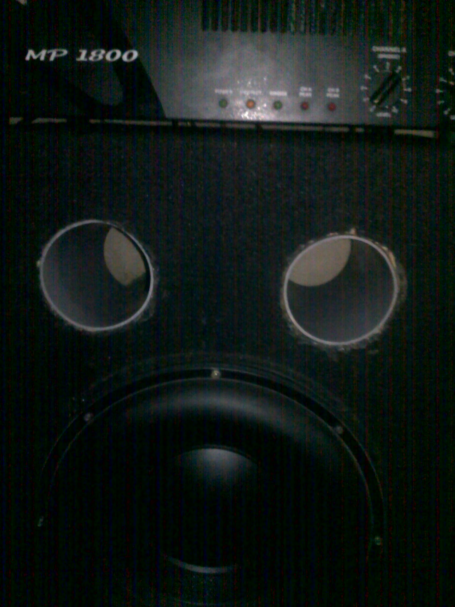

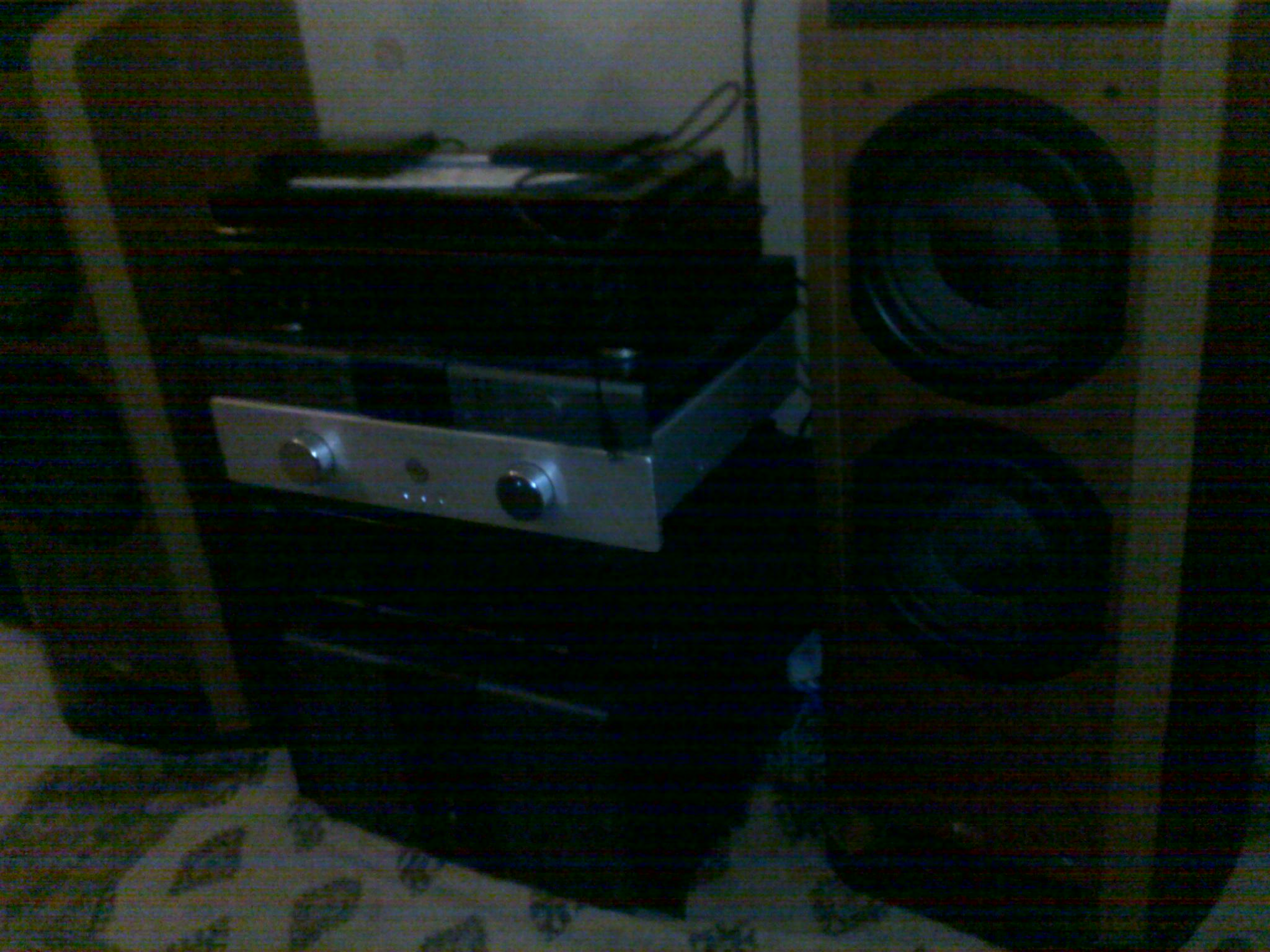

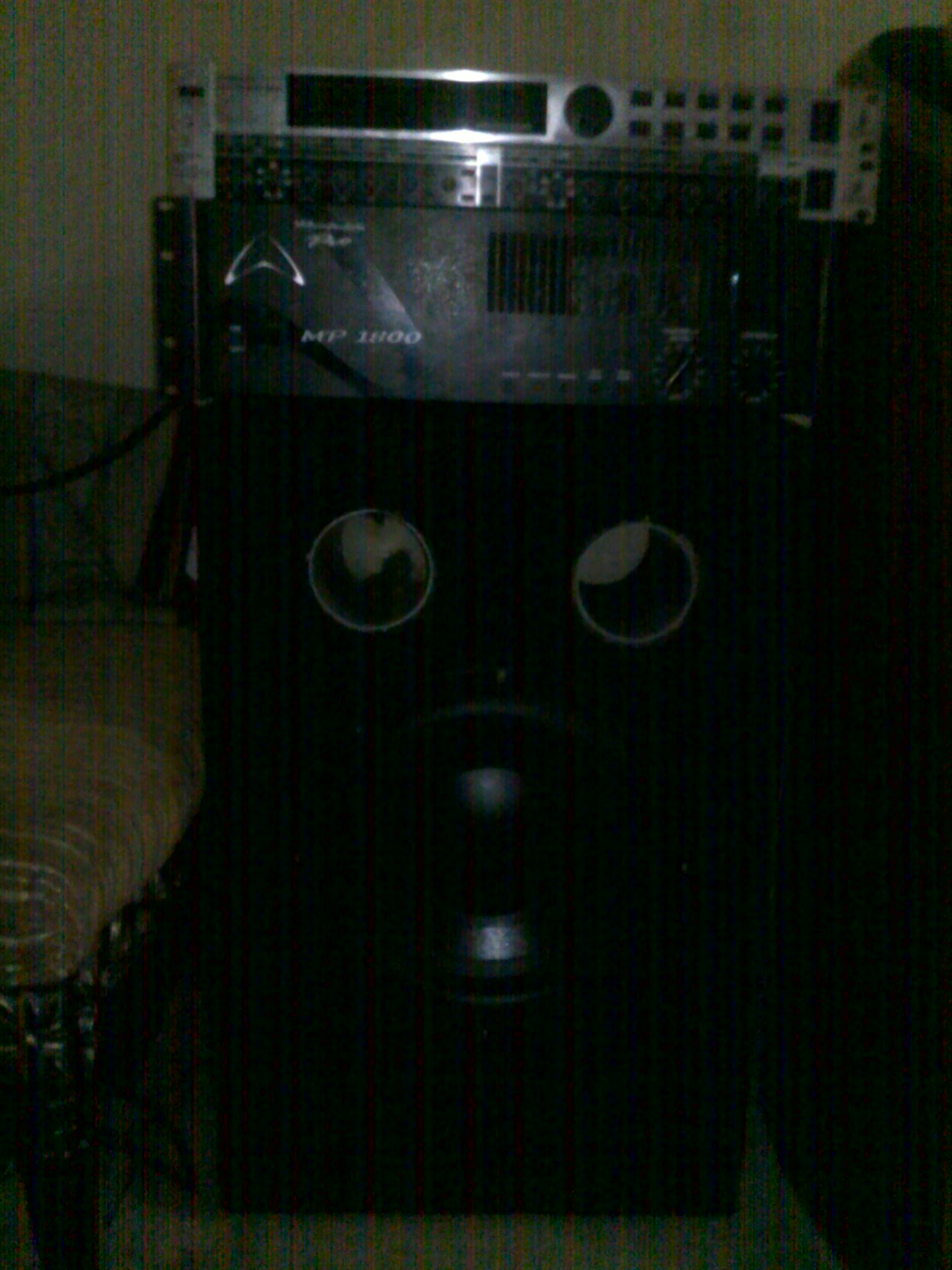

Hi, here is my system.
On trial are two subwoofers.
The 12 inch ported is wilson watch dog driver.(for music)

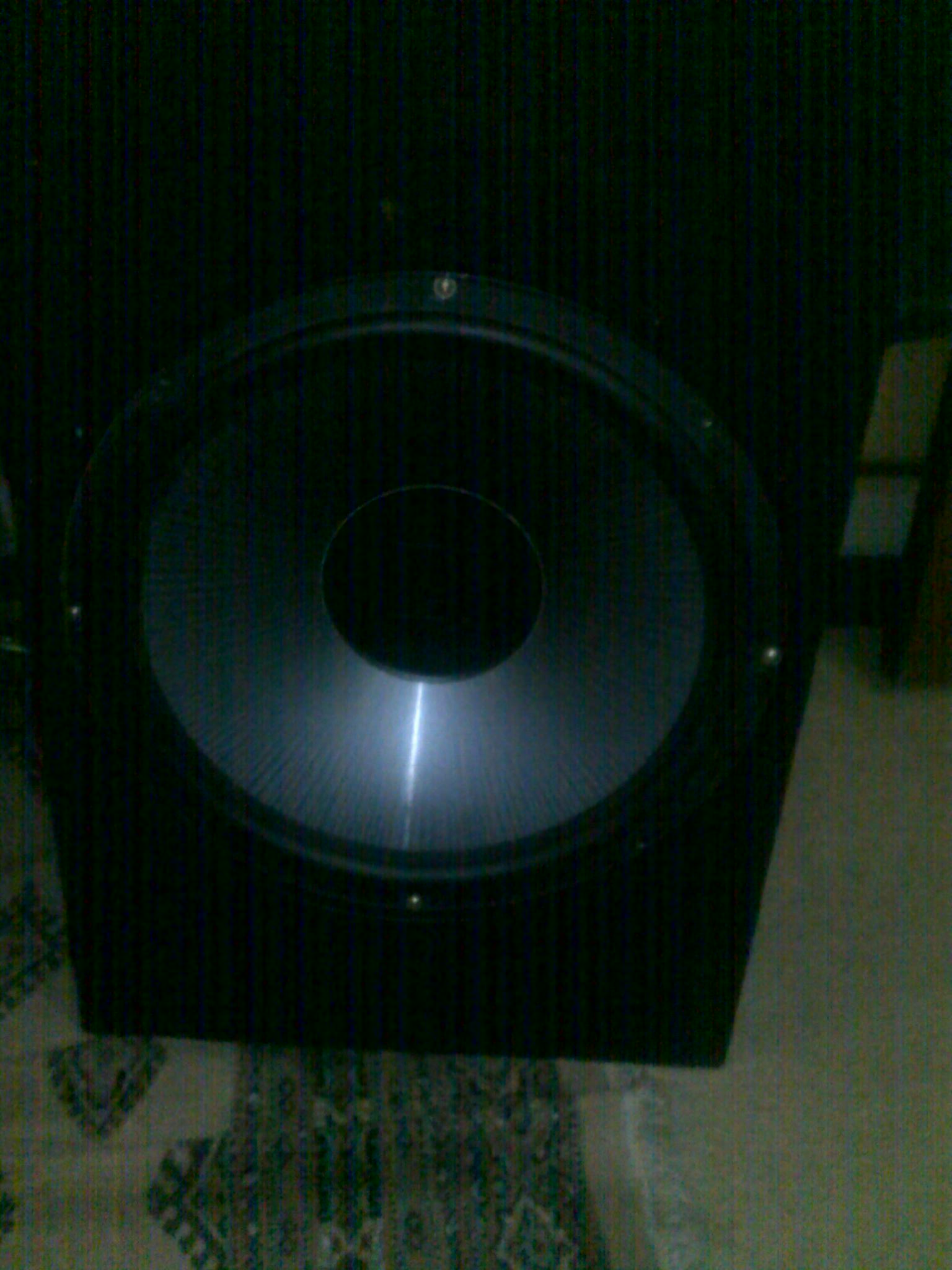

The 15 inch sealed is KEF KARS-380 ,4 drivers available for music/HT.
The amplifier for subwoofer is whardale brdiged for 4 ohm load giving 1800W.
The cross over is set at 60Hz and summed the parametric equalization is 32Hz Q=2 +6 db gain. for ported sub i use 25HZ cut filter. none for sealed.
The KEF is rated 400 W, 130 Oz double stacked magnet Fs=23Hz and efficiency of 95db at 4 ohm. its encolsure is 2.75CuFt . It has a lot of punch way more than wilson which is rather soft despite being tuned at 35Hz.
SO i plan to use 4 KEF 15 inch woofers in two cabinets in pull push combination , magnet back to back creating dipoles and using them in stereo for reduced distortion.
My question is what would be the cabinet size. should it remain the same i.e. 2.7 cuft total 2.5 net or half or double. ?
Secondly does any one have any experience with Whardale , i never expected it to clip which it does occasionaly at significantly loud levels on both subwoofers ( driven altenately) on loud passages as both woofers are rated 400 watts , both are 4 ohm and the amplifier is rated 1800W bridged into 4 ohm.? BTW i intend to replace the whardale with peavey GPS 2600 series driving each cabinet at 2 ohm parallel load of two isobaric subwoofers
