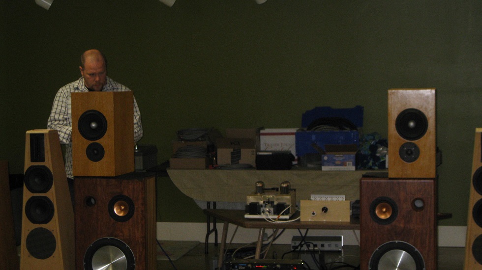

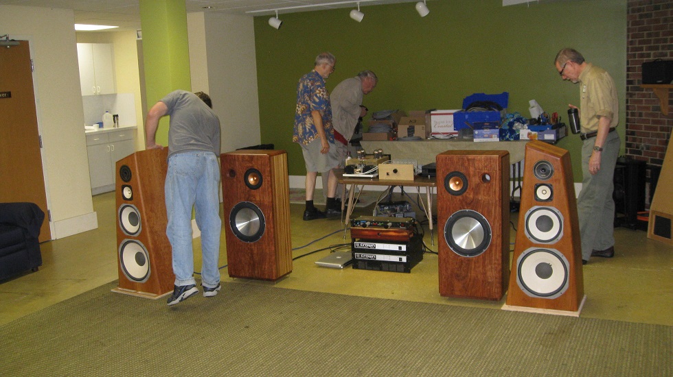

Here are some smiling faces from yesterday's event:
This is the system they were listening to:
Gary Dahl
Gary Dahl
Gary's system was a big success! Everything worked as was expected (Gary actually did bring back-up gear just in case!) I certainly spent a fair amount of time listening to his system! A very nice system.

Gary -for us not privileged to attend, care to share details - including the amps? - two of every type!
Two of every type? I guess now the Noah's Ark mural in the background makes more sense!
The source was a server running JRiver MC20 on Windows, connected via USB to an exaSound e20 mk ii DAC, with balanced connections to the amps. The amps are Lynn Olson's "Amity" circuit: Tribute input transformer, push-pull 5687 driver stage, O/Netics interstage, push-pull 300B's, O/Netics output transformer.
As for the speakers, each channel uses the following:
Deep Bass
Acoustic Elegance TD15H woofer and two PR15 passive radiators in 5 cf enclosure, powered by plate amp, low pass at about 60 Hz.
Midbass
GPA 416-8B Classic Series (alnico) in 3 cf sealed enclosure, -3 dB at about 60 Hz, passive 2nd order low pass at about 800 Hz.
Midhorn
Azurahorn AH-425 horn, Radian 750NeoBe driver. Passive 3rd order high pass at about 800 Hz, autoformer attenuator by Dave Slagle, equalization results in flat response to 13 kHz.
Ribbon
RAAL 210-10 Lazy Ribbon, passive 2nd order at 13 kHz.
Gary Dahl

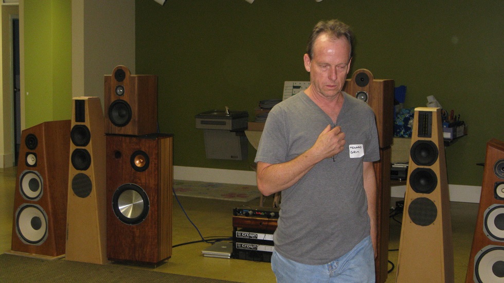

As promised, here are some pic's of the event last Saturday. Really amazed at all the great stuff (and great folks) that showed up!
Some large speakers -
1. Sir Byrd's large 2-ways and Howard's curvy 3-ways with PR
2. Rene's TWW towers, Sir Byrd's, Howards, and Jay's MTM prototypes on top
3. Howard contemplating his next move, after setting up last year's winning top 3-ways.
4. A re-creation of a MurphyBlaster design using Usher and Scan Speak drivers. (set up inverted to position the tweeter near ear-level)
All good sounding.
