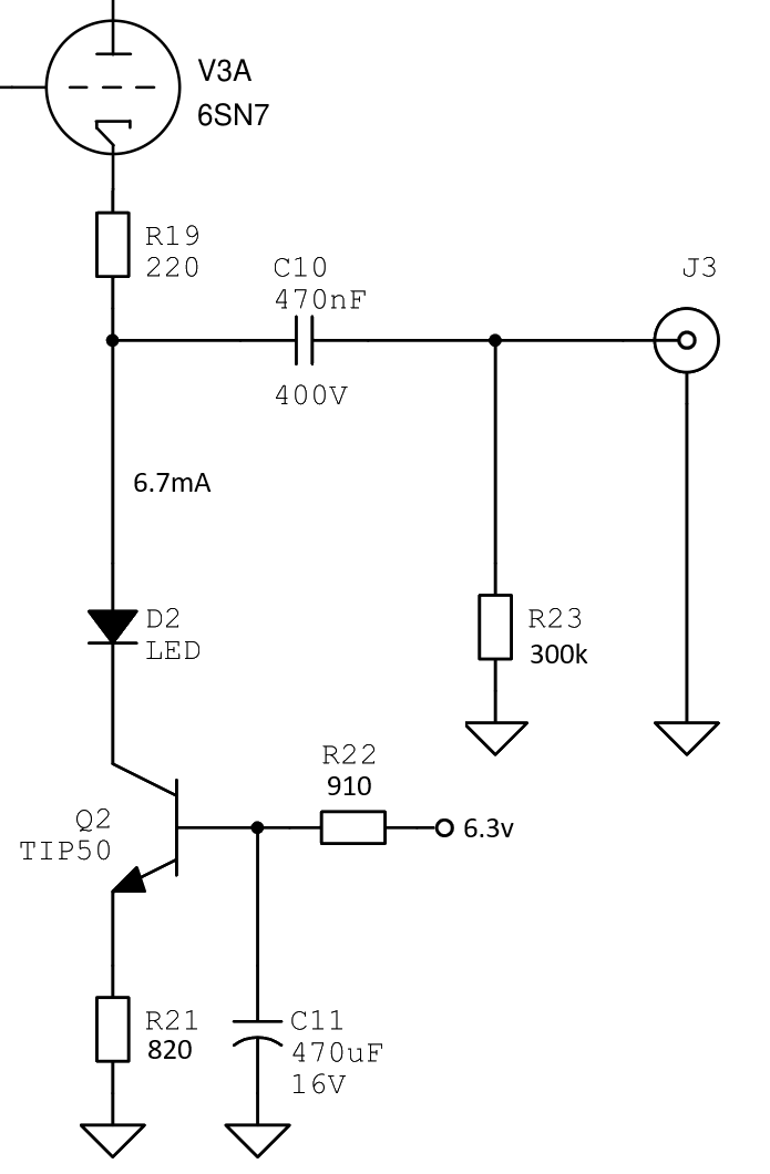

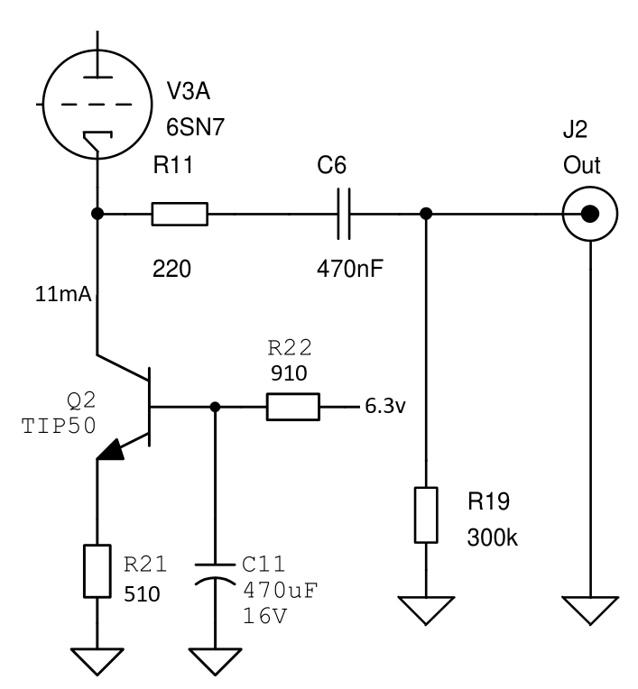

As It turns out, the CCS circuit I was using ran the plates at 11mA for a dissipation of slightly over 3W per side. A little more power than I was comfortable with considering the new production T-S 6SN7GTB I have installed is rated for only 2.5W. The original CCS was arranged as follows:
As depicted below, I modified the circuit to reflect changes implemented in the Cornet V3 while also increasing R21 to 820R to reduce Ip to 6.7mA, which lowers plate dissipation to 2W. With concern to the tube's longevity, should I drop it further (perhaps through a reduction in anode voltage)?
I'm having some trouble understanding the purpose of the series LED in the revised circuit. Normally I see LEDs used for biasing, and I'm wondering if I should employ such an arrangement for this circuit.
Thanks for any input.

Not a bad idea, although I've never had problems with arcing using a 6087 which is indirectly heated.Better use a safety diode across grid and cathode ..
I couldn't find anything referencing stated degradation, but I added a couple of 1n4005s directly between the grids and cathodes since I had them in stock.
