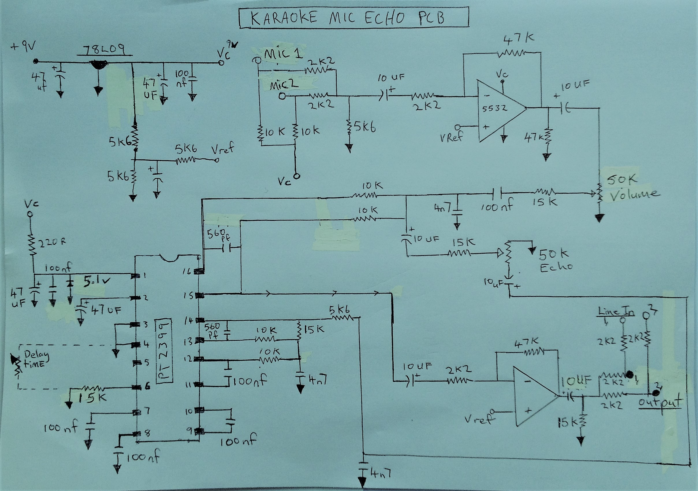

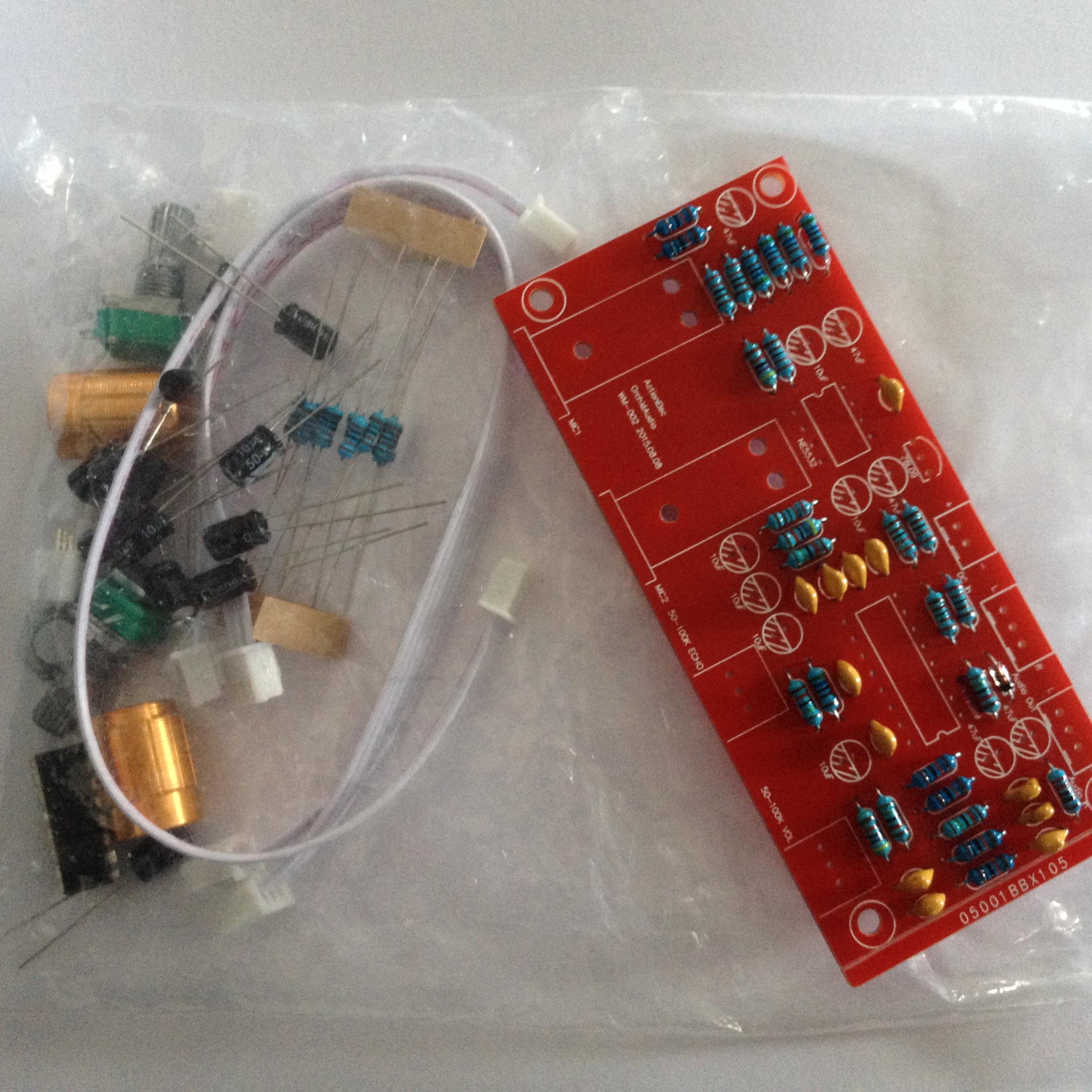

I'm back working the other $5 kit i bought a few years back making it into another cheap guitar echo. I have drawn the schem out properly and readable this time. Going to implement the delay time control and some capacitor coupling at the input for guitar like before.
Really wanting some help advice on changing the volume control to a wet/dry mix instead if any one has worked with this kind off circuit before? the volume only seems to control the overall level.

I have found a schematic to incorporated and will add the new schematic once its tested and drawn up with changes to board for future reference.

Thanks, are the second pots used as trimmers? wondering what program do you use to draw your schematics?
