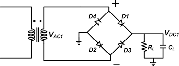

1. Should PT B+ supply be center tapped (2 diodes) or not using bridge?
2. Related to first Q, what should AC V spec be (CT or not) to achieve full load DC requirement?

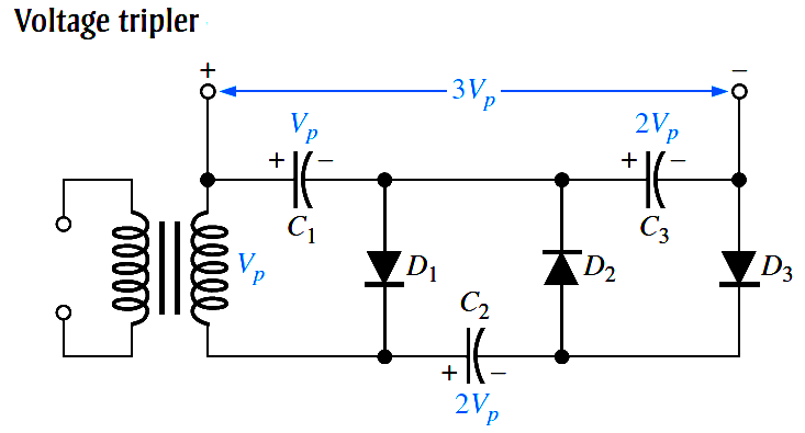

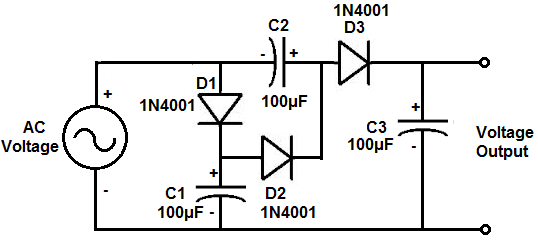

3. See below hand scribble- can I hook fixed bias voltage tripler (-19v) up to 1/2 preamp fil supply?

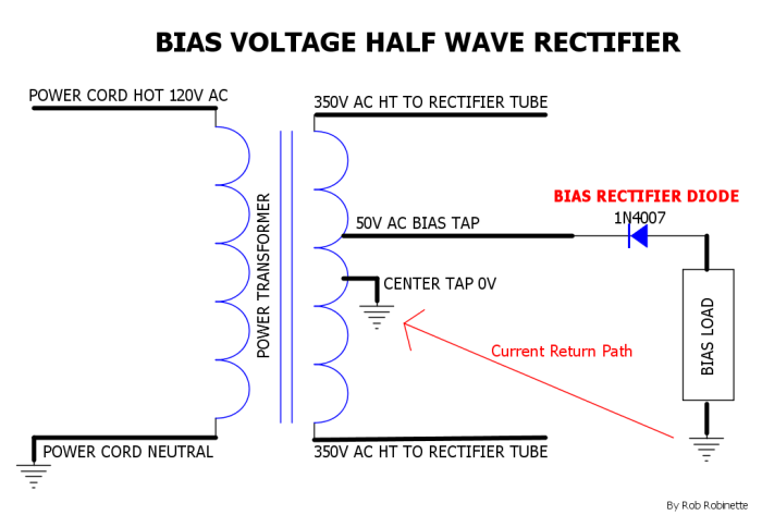

For FWCT (two diodes), you need 320-0-320 VAC at rated load.
But you also need a tap on the same secondary for fixed bias operation.
For FWB (four diodes), you need 0-320 VAC at rated load.
But you have to get the bias supply voltage from somewhere else, or use self-bias.
Tripler off the filament winding should work, if filtered well.

If you use a centre tap, you can get your bias voltage from a tap. If you're using a tube rectifier, you'll beed this kind...
If you are using SS, the using 4 diodes for a bridge vs 2 diodes and the centre tap is funcionally the same, but you need to get the bias voltage from a separate place like the tripler @rayma suggested.

For C-: Ground the + and connect the heaters across Vp. for 6V3 input, you'll get ~ 25V for bias (6.3×1.414)3=26.72

Know I can use B+ winding tap for such purpose, but was hoping to use E tripler off half 12.6V grounded heater tap cuz I'm familiar with lower voltage app for grid bias. Currently using tripler schema below off unused 5V tap which provides -19V.
Being that half wave rectifier can be used if smoothed- I get that based on your & EICO mods examples. But I'd like to use what I asked if possible-
Maybe I'm stubborn; IDK- lol
Jim
