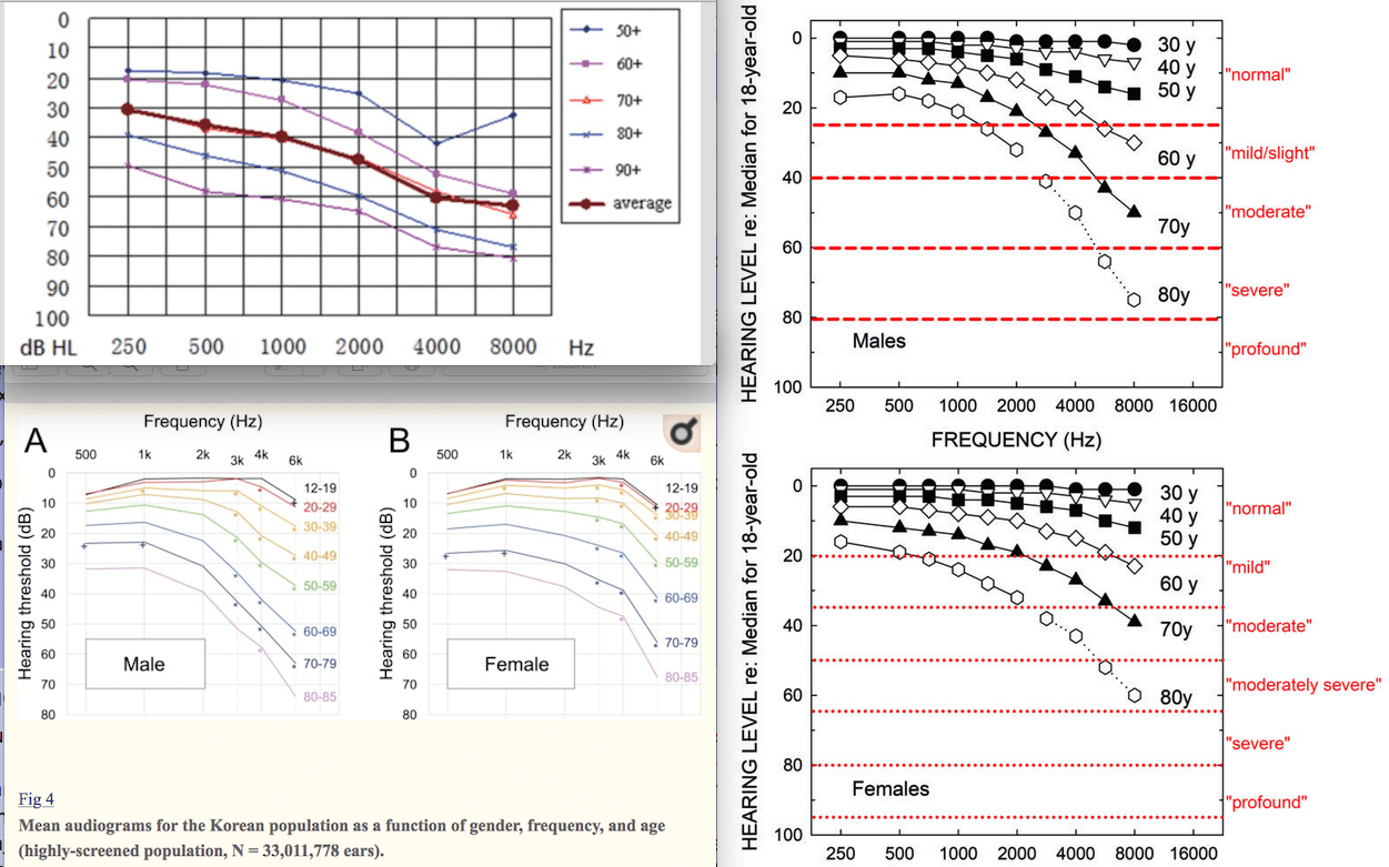

Presbycusis (age related hearing loss) is typically similar to a low order low pass filter followed by high order filter.Imagine a listener who is unable to hear above a 5kHz pure tone and we play an unfiltered piece of music to them. Would this subjectively sound identical to the listener compared with the same piece of music having a 5kHz low pass filter applied, with particular regard to the perception of transient sounds? Phrased another way are we able to discern the difference between being unable to hear above a particular frequency compared with the absence of that HF information in the source, again considering only the perception of transients?
Suffering both from NIHL (noise induced hearing loss) centered at 4kHz and presbycusis, my hearing response could be looked at as similar to a 3.5kHz 48dB crossover with the HF (high frequency) turned down around 60dB.
Until the HF level reaches around 60dB, music subjectively sounds identical whether or not a 5kHz low pass filter was applied to it. Once the HF level exceeds around 60dB, I’d miss the HF content cut by the filter.
Presently, can’t hear above 14kHz at any level I’d consider safe for the rest of my hearing, so a steep filter down to 14kHz would not be detectable. Considering my genetics and present rate of presbycusis advancement, a 5kHz ceiling may happen before I die 💩.
At least my back hasn't given out 😉

I have my doubts about the inevitability of age related HF hearing l loss. My hearing was damaged in 1969 by a howitzer @ ROTC camp. Instant tinitis. I've worn ear plugs ever since in loud situations, as at work in factories or mowing the lawn. My hearing was tested to 14 khz in 2008, and doesn't seem any different now 14 years later. I suspect a lot of "age related" hearing loss is men failing to protect their ears while using gas engines, fireworks, firearms, playing the music too loud, whatever. Earplugs are $1 a pair and worth the money to people that enjoy music as much as I do. At infrequent rock concerts I wear the plugs, and find the music more enjoyable without the buzzing of intermodulation distortion of the broken cilia. Pipe organ concerts too, if the trumpet pipes are really loud in a masonry wall building.
Presbycusis is inevitable, it's just whether you individually are ahead or behind the curve, and the rate of deterioration that differs.I have my doubts about the inevitability of age related HF hearing l loss.
My partner's hearing is better than a typical 30 year old female, while mine is more like an 80 year old, and we are both 65.
Together, we average out 🙂
