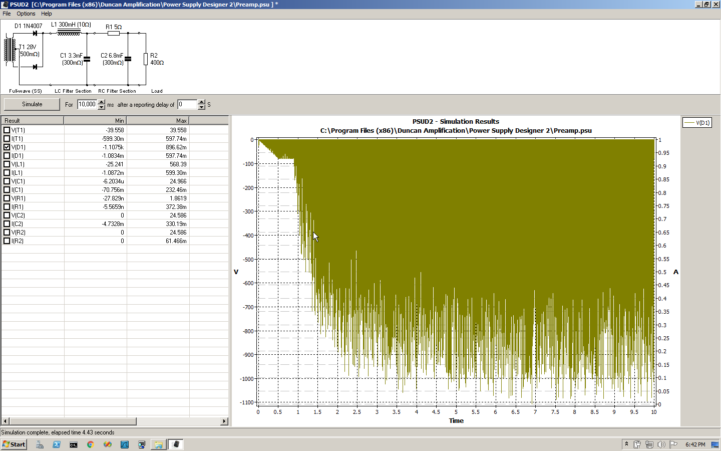

If anyone runs across this sort of output, here from a lightly loaded choke input filter with a 400 ohm load resistor emulating about 50-60 mA from the supply, Duncan's already on the case.
From the Help menu:
And the fix, from Help->Technical Information->Program Limitations:
For this circuit, setting 10k in Options->Rectifier Leak sorted the funky output nicely. Firebottle choke input filters could be happy with higher values.
From the Help menu:
Q: Why are there sometimes small glitches on the rectifier voltage?
A: These are caused by short cuts taken in the simulation. A dramatic speed improvement is made over alternative simulators such as SPICE, and this is the price that is paid for the extra speed.
Choke input filters
Choke input filters are now catered for, however the model is fairly simplistic. Should the current collapse to zero in the choke, then high voltage spikes will appear at the cathode of the rectifier. In a real world scenario, these would be partly soaked up by the reverse capacitance of the rectifier. As rectifier capacitance is not modelled, a reverse leak facility helps tame this effect.
