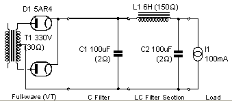

Sheldon: I'm curious why our B+ results of Luvdunhill's model inputs are so far off. (440V vs 360V)
I'm assuming that your model differs from the one I've attached....

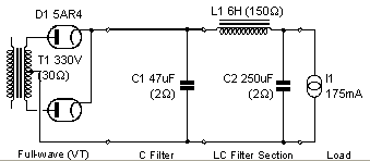

Here are my simulations, if that helps you at all. The stepped load shows two things: full load stability for the first two seconds. The last two seconds shows the load with only the bleed resistor...i.e. the maximum voltage the filter caps will see.
"45 mode"
"300B mode"
I have also attached the PSUD files, if that will be useful.
luvdunhill said:
that's exactly what I get as well. I probably just communicated something incorrectly in my post ..
No, I did a quick sim the first time and didn't check it out. The discrepancy is due to a minor bug in the program.
The default value for a current source is 100mA. I entered 40mA, and that value shows up on the schematic. But, sometimes, my program goes to stepped load, even if I don't check the box or enter any other values. When that happens, the program steps to 100mA (or whatever previous value was entered) at 0 seconds. In other words, the current is 100mA but the schematic shows 40mA. Can't tell, unless you open the current source edit box.
Run with 40mA, I get what you display for your sims, so yours are the correct values.
Sheldon
That overshoot you see will not actually occur in practice. For the tube rectifier, you can go to the options menu and click on "soft start". That will more accurately reflect the gradual warm up of the rectifier filament. Not a big deal one way or the other, in your case, as your bleed resistor has no warm up cycle.
Sheldon
rknize said:
Yeah, I don't care about the overshoot because it doesn't happen in practice. What is important is the stability. Leaving soft start off will show if the filter is damped enough or not. This is also where a stepped load can be revealing as you will definitely see ringing.
Yes, on that score you are good - well damped. I've seen some people claim that a power supply that is a touch underdamped sounds better. A matter of taste, I guess. Also probably depends on the amp itself.
Sheldon
PaulyT said:
Thanks, Russ! I'll play with them. I guess your resistance values are all based on actual measurements?
They are closer now. I used these models when I came up with the specs for that transformer. The only thing I did was update the secondary's DCR and re-run it. The result is pretty close to what I measured on the amp.
The resistance values in the caps are the spec'ed ESRs from Panasonic, not anything I measured. Note that C2 is 220uF because that is the cap I am using. It does not account for the film cap I will be adding to the final amp. The breadboard testing was done with a 220uF electrolytic cap...no film cap. The lower net ESR on C2 from the film cap is not going to have any significant impact on the simulation. The only thing you would probably notice is slightly higher current leaving the choke when the rectifier switches off.
If you are not familiar with electronics, graphing the voltages and currents through the various components of a filter like this is a real crash course in how capacitors and inductors behave. Kind of interesting.
I'll take some better DCR measurements of the transformer and then post the actual secondary voltages, both unloaded and loaded, back in the other thread for reference.
