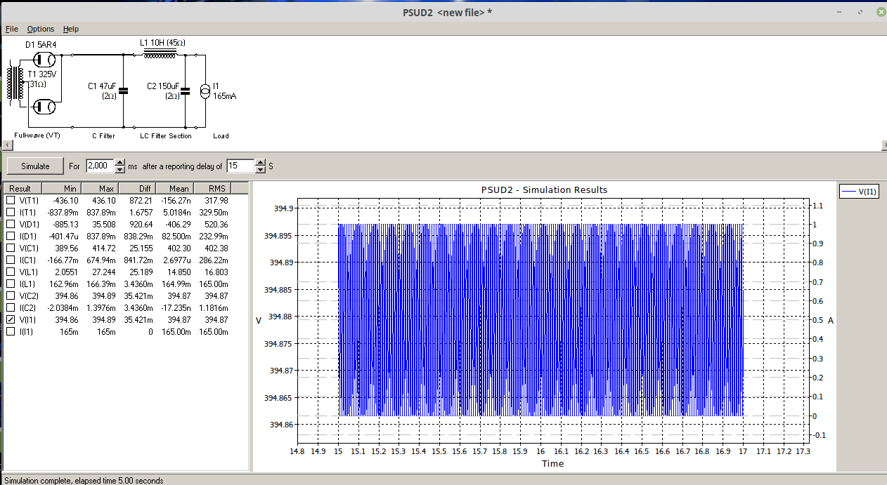

While finishing up my amp., i was thinking of upgrading the Triad choke to some DC-Toroidal with the following specs. ::
Toroidal choke 10H 250mA
Through the use of innovative toroidal cores production and winding technology, compared to EI-chokes, we have achieved exceptional electrical parameters. Major advantages are: minimal external magnetic leakage fields, noiseless operation and much lower DC resistance.
Technical data
Core type toroidal
Inductance L 10H
DC Resistance 45Ω
Nominal DC Current 250mA
Nominal voltage 400V
Dimensions 88 mm (OD) x 35 mm (h), weight: 1,3 kg

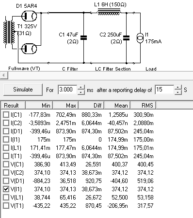

I have some quistions regarding the psu-part of my TSEII (ripple, B+ etc...)
I use "stock" components, aka' C4=47uF, C5=150uF, Choke=Triad C14X (6H / 150 Ohm)
Transformer 325 - 0 - 325 @ ~220mA (Toroidal custom wound)
I found an older thread here, where this was also discussed, but didn't answer my quistions through. https://www.diyaudio.com/forums/tubelab/163641-lowering-voltage-4.html

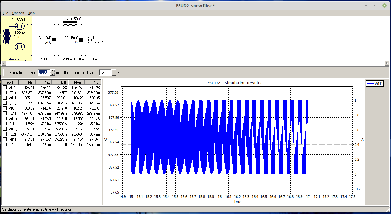

Playing with PSUD designer, i can simulate the two different chokes.
Looks like ripple goes from 0.06 to 0.03 swapping the Triad with the Toroidal one.
Same time voltage rises around 20VDC with approx. load of 165mA
What i cannot figure out is, will the higher voltage stay there with B+ around 20vdc more or will it lower when actually in amp. loaded with my 300b biased at ~67mA or will i "win" nearly 20vdc of B+ (guess not 🙂 ?)
Ohh... one thing more, is the load set at 165mA on psudesigner right?
Any other things i have to consider? - Consequences perhaps?
Jesper.

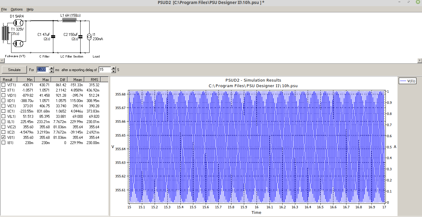

Hi...
This is the toroid i am considering to buy :
TDS10/250 - Toroidal Choke 10H 250mA DC - Shop Toroidy.pl

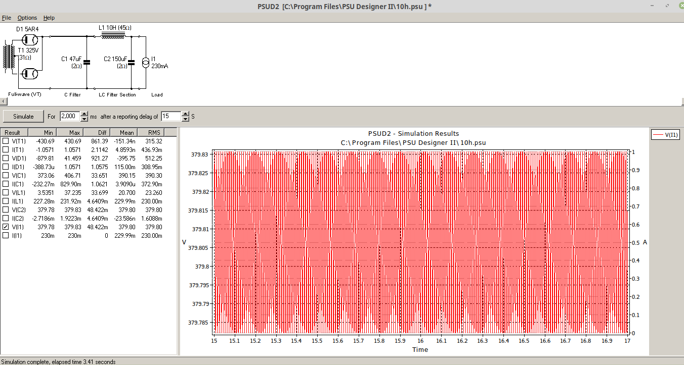

I tried running a lot of simuations, and the clear view is that bigger Henry gives lower ripple, an 10H choke is about double as good as an 6H one.
Also the lover resistance, the higher B+.
When i "load" the simulated PSU with 230mA i have 355vdc@B+ with the C14X choke excatly as in real life here. When i replace the C14X with the toroid one, the ripple goes to nearly half and B+ is rised to 380vdc...
I'am about to order one... but like some opinion first cause i'am still newbee into the tubes 🙂
Rgds; Jesper.

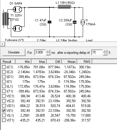

So it's getting fun this 🙂

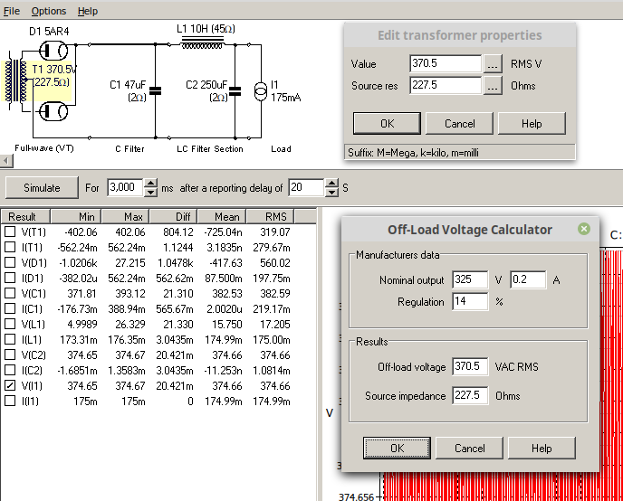

With load at 175mA ::
I tried to make load regulation at 14% on mains trafo (Toroidy say's it's between 12-15%).
Setting the C5 to 250uF, this simulation now gives within 1vdc the real value with my 6H@150Ohm choke i have now. (~355vdc@B+)
When i simulate the Torid choke 10H@45Ohm i get ~375vdc@B+
So i think (think? 😛) the 20vdc i couldent figure out before, is duo to load regulation.
So i guess i have to buy this toroidal choke to see if it's calculated right.
Don't we agree 😀 😉
Rgds; Jesper.

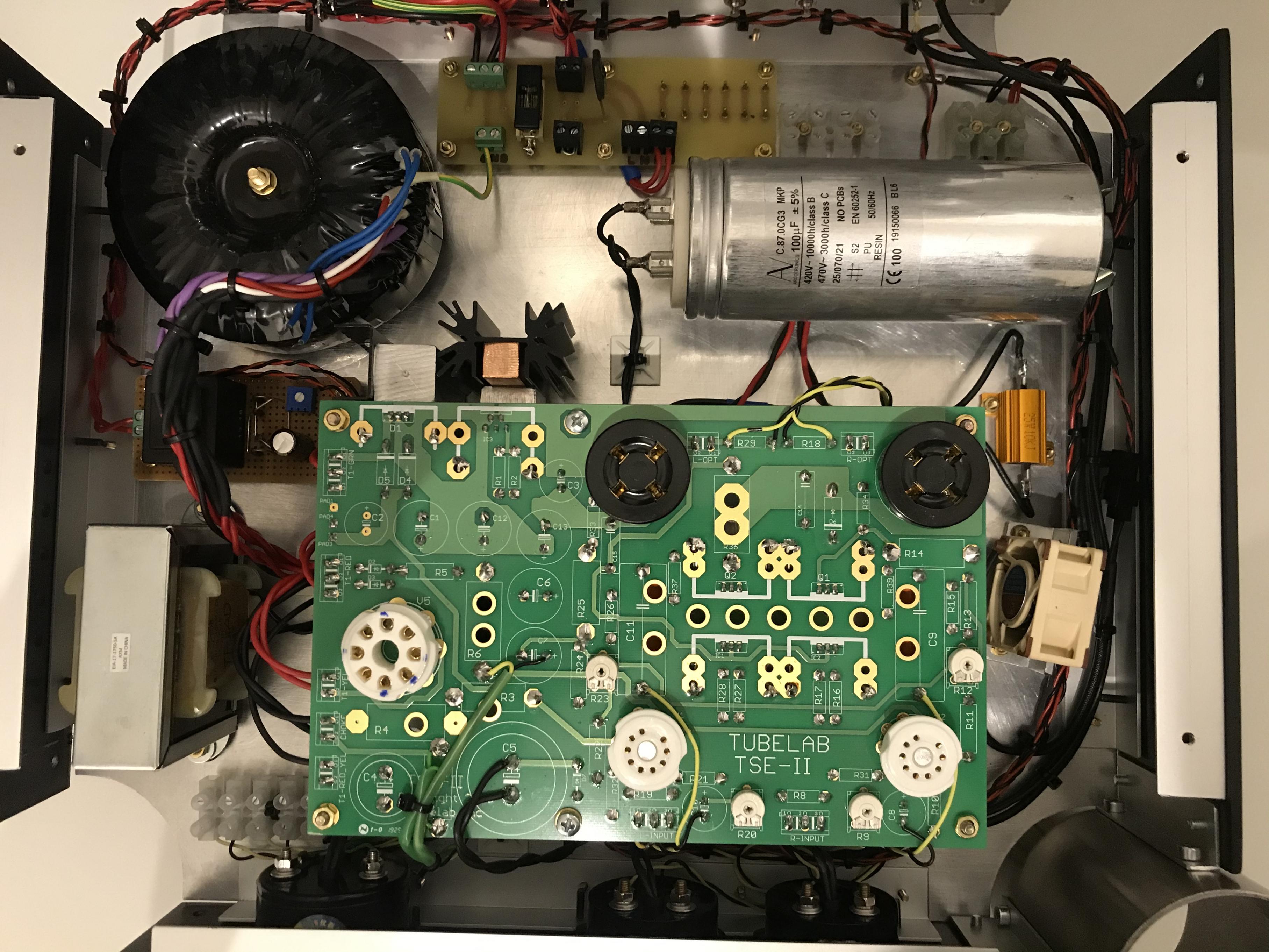

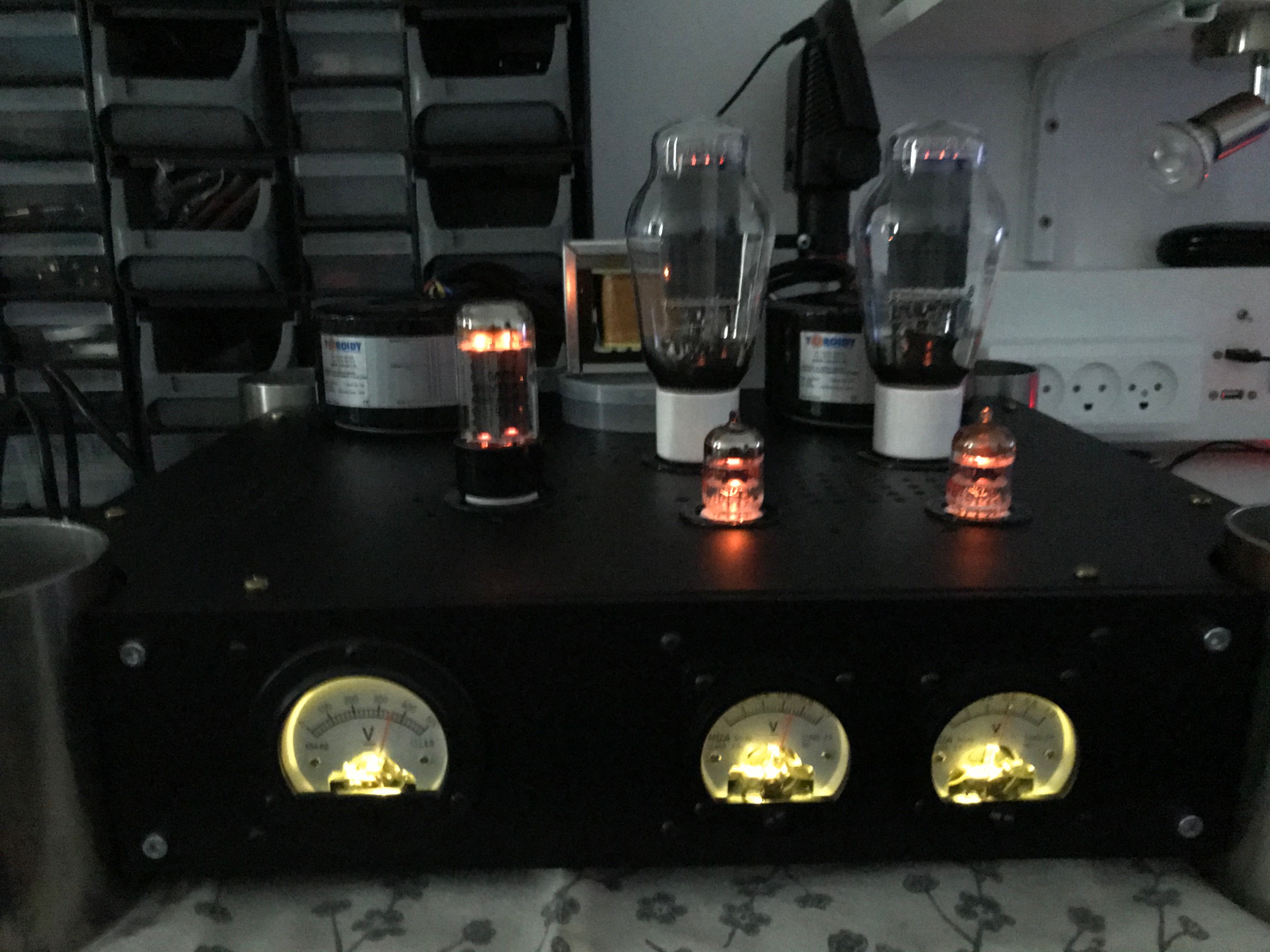

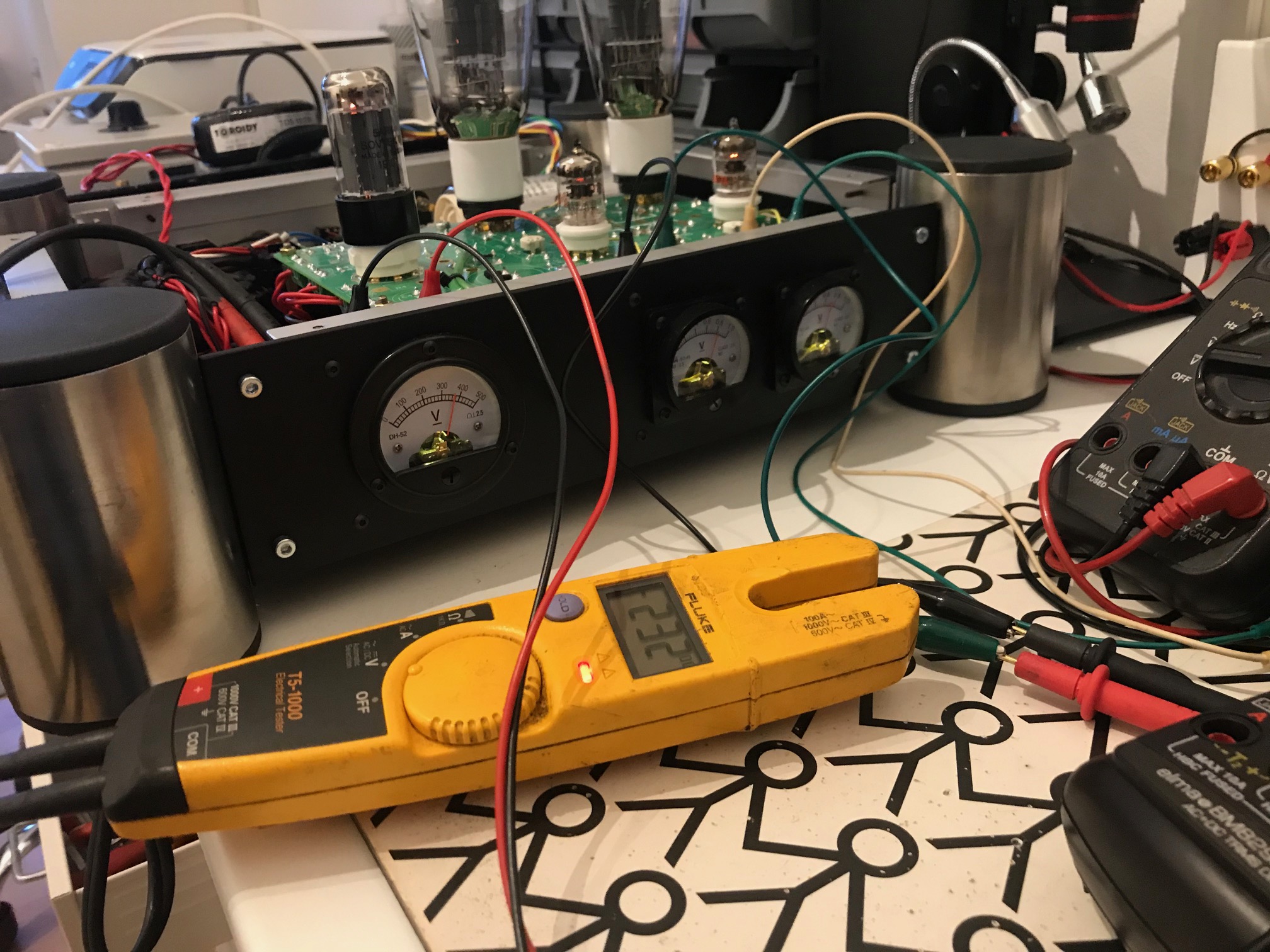

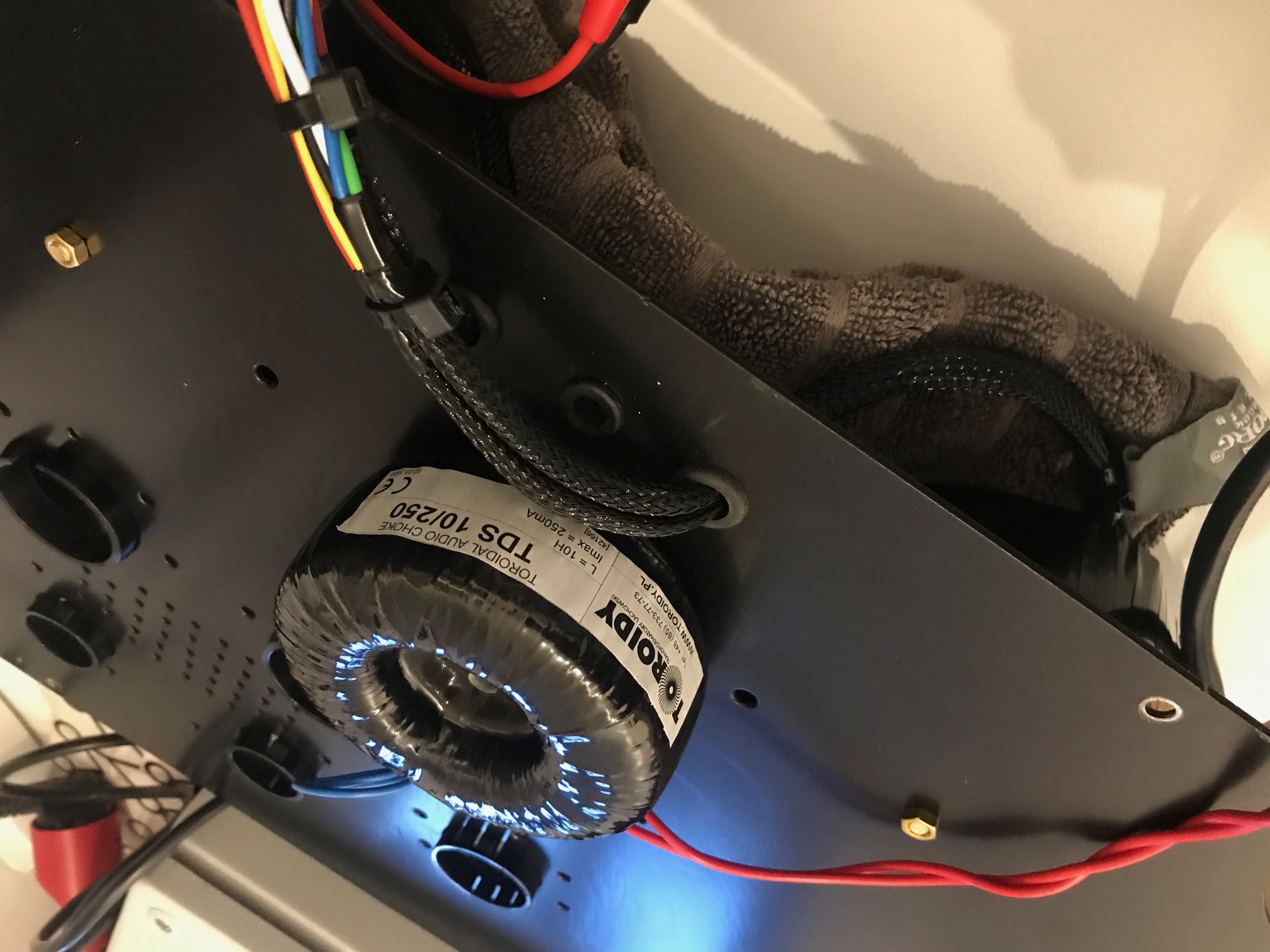

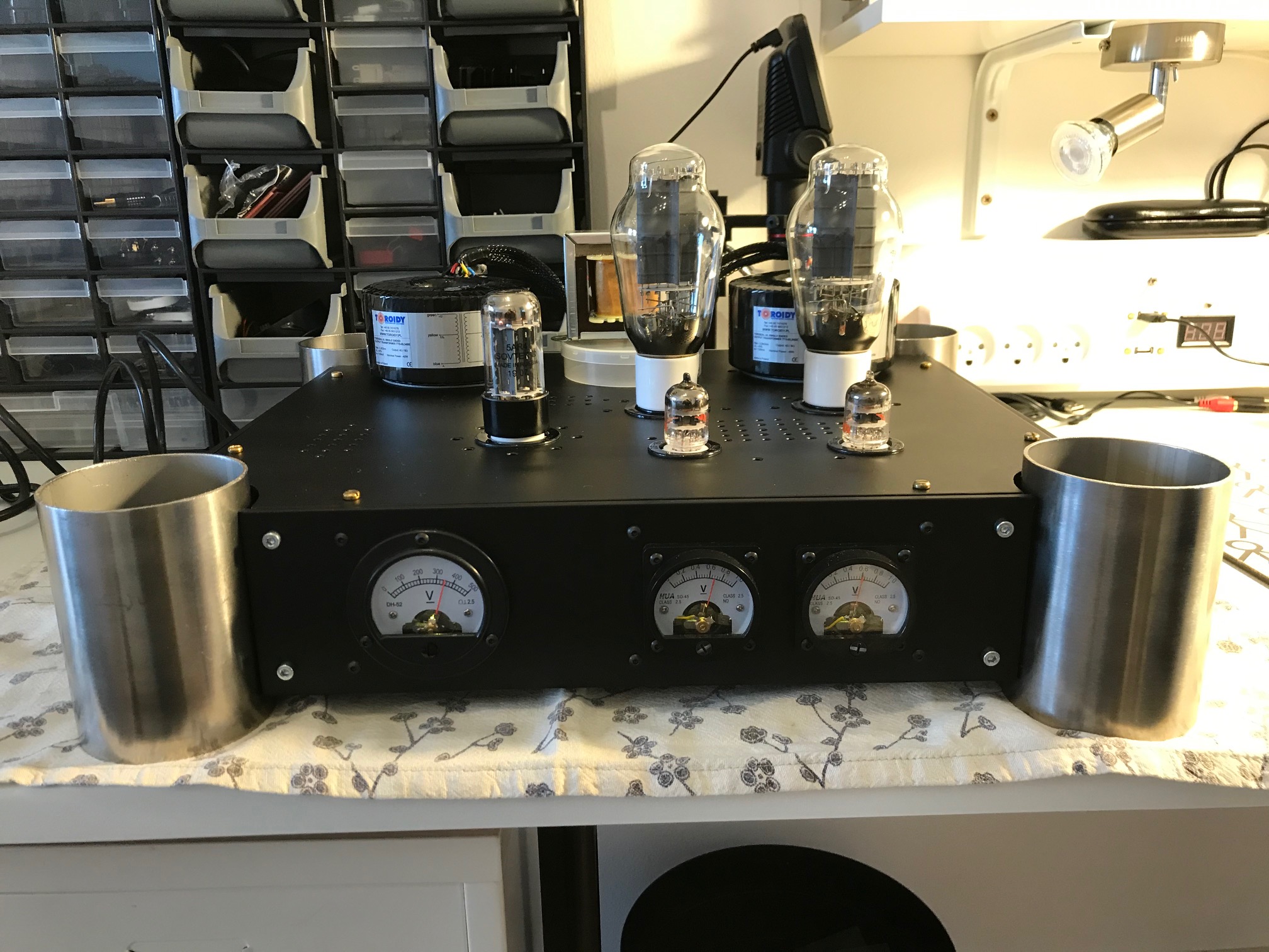

Evening all here 🙂
So finally after 2 week's i recieved the 10H/250mA choke...
I calculated some B+ voltage with the new choke to be around 375vdc with bias at 68mA or so... With the new choke i endup with 365vdc but with a higher bias at 75mA.
When bias is 68mA the B+ is 368vdc so ~7vdc lower as i (PSUDesigner 😀😀) calculated...
I will try to simulate with the higher biasload and post results here one of the day's.
Back to test / assample the good tubelab amp. 😛
BTW : Good news is also that choke don't get hot at all, the Triad was hot to the touch after ~1hour around 70C. (a bit more than i really like, also knowing that insulationclass on the cu windings proberly are rated F witch is not good at >125C., but okay a good margin through)
Jesper.
