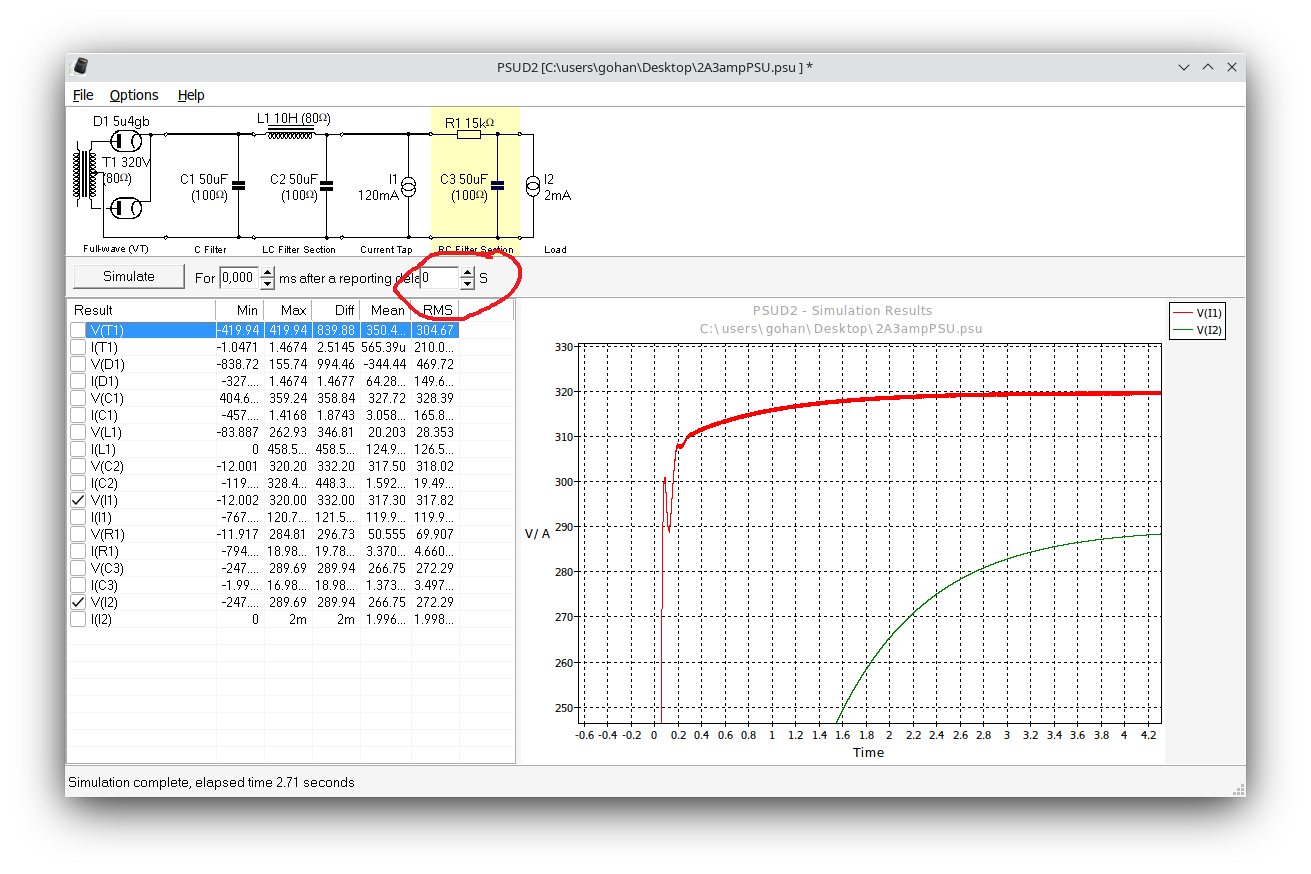

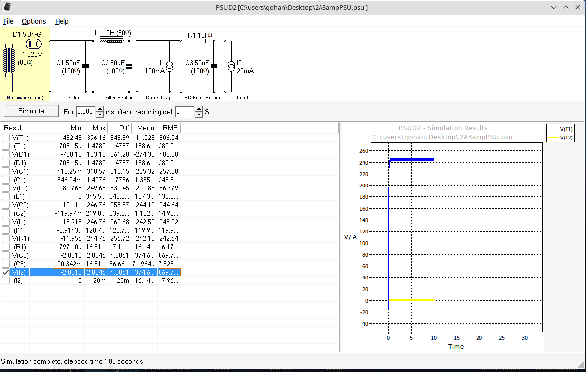

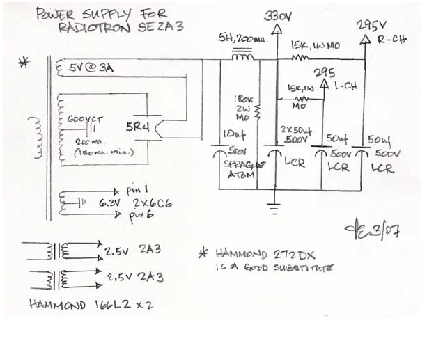

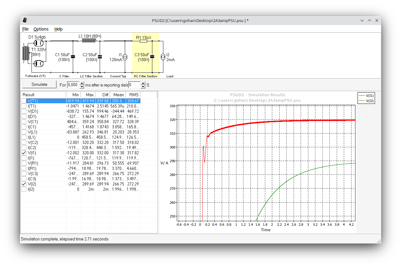

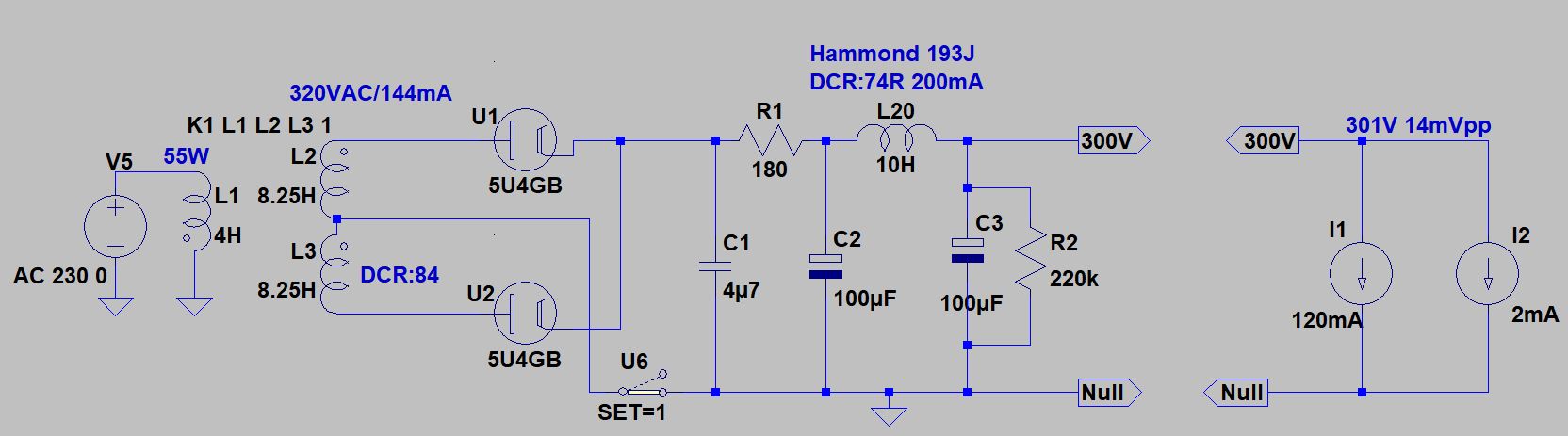

Hi guys, I recently built the Jelabs Radiotron 6C6 2A3 amp, and I wanted to practice a little with LTspice and PSUD. With PSUD, I wanted to see if the power supply could be improved, or at least test it, but I'm getting some strange results. I'm probably loading some data incorrectly. Could you give me a clue? I've been reading some software PDFs (DHTROD, etc.)

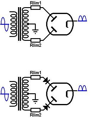

But I noticed that the schematic you posted shows the double rectifier 5U4G being used as a single rectifier while the 5U4G is a double rectifier (having two plates). This is an unusual way to use a double rectifier (even though any double rectifier can also be used as a single rectifier).
Normally when using a double rectifier, the center-tap on the secondary of the power transformer is connected to ground while each of the two plates is connected to one of the outer connections of the secondary winding of the power transformer.

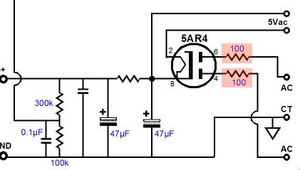

The power supply of the original JE Labs amplifier you referred to uses a 5R4 in double rectification configuration.
So, how is the 5U4G being used in your amplifier? As a double rectifier or as a single rectifier?
If the 5U4G in your amplifier is being used as a double rectifier, you just have to find the way to connect the 5U4G as a double rectifier within PSUD.

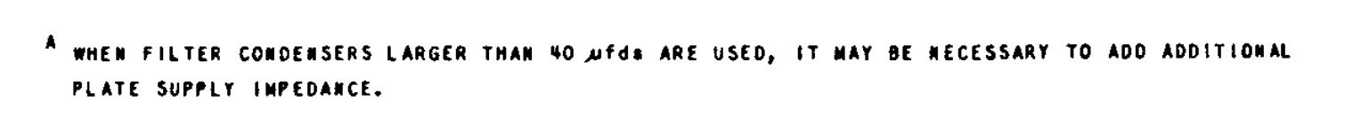

The only thing I don't like is C1 value - higher capacitance leads to higher rectifier peak current and to shorter rectifier life.
IIRC, the max recommended value for 5U4GB is 40uF, and Radiotron amp PSU uses 10uF.
I would probably half the C1 and double the C2 (to keep ripple at about the same level).
Perhaps best to start with the original schematic (link?) and parts list, and then appreciate what datasheets of parts you have to get simulation parameter values from, or what other part details you have to hand.
Can I suggest start with the transformer and capacitors. For example the capacitors have an ESR parameter - you will need to learn what that means and how to estimate or measure each parameter like that, so that the simulation has half a chance of representing your power supply.

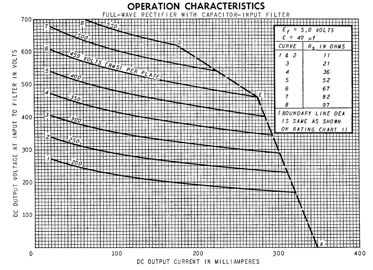

If its are available, the rectifier datasheet shows the estimated values:
As you can see, the 320VAC secondary with 5U4GB (capacitor input) rectifier at about 122mA produces about 340V raw DC.
With -static- load current the voltage dropping (on the choke DCR and even series resistor) can be calculated.

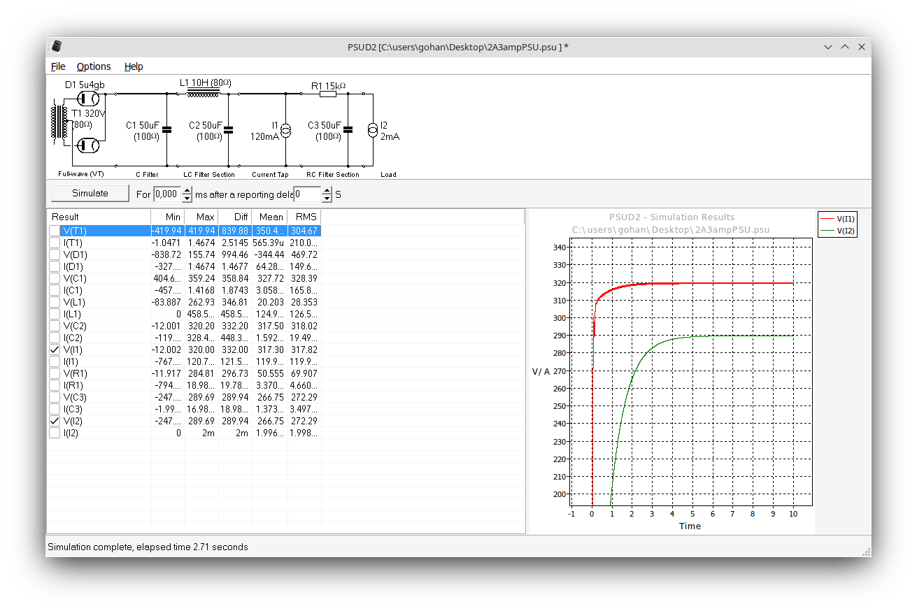

Sample simulation:
BTW is 2mA valid? I doubt. Driver stages consumes rather 20mA, than 2.
It's only static simulation.
The current altering, the SE power tube load even 2x current of static current.
The "switched" load (for example 240mA max, 0mA min SQ wave) shows more accurate behaviour of PSU.
