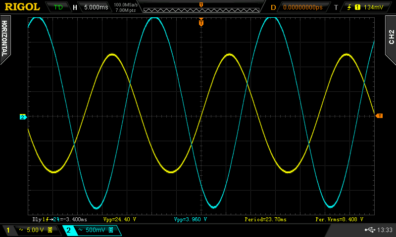

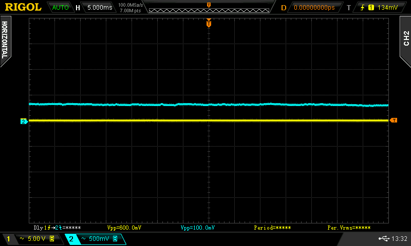

Here is a scope shot. To visualize what is happening.
GM70 Single Ended Amp. I'm going to say with a moderate amount of capacitance.
Power supply is 30uF>1.5H>135uF>1.5H>135uF Voltage at last cap 1060v
Blue trace is measured at the last 135uF cap.
Yellow trace is secondary of output transformer with 6.8 ohm load or about 10 watts continuous @42Hz (~low E on bass guitar)

so there is two ways you can go filtering with c-l-c: high capacitance, low inductance or low capacitance and high inductance.
It is not the same thing. High L and low C will give high output impedance. High C and low L will give lower impedance, looking from the amp side of the supply.

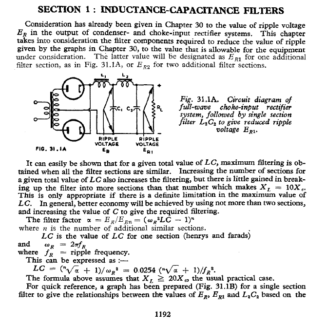

At this respect, Mr Langford Smith in his "Radiotron" says, at page 1192 of chapter 31:
Please note that it is intended to be a good engineered device, and not necessarily a good "sounding" set, as "audiophiles" say.
Interesting that it says that not much will be gained by going beyond two sections. We still regularly see newbies wanting to try four or five sections in a vain attempt to get very small ripple and hence very small hum; they don't realise that ripple and hum are often limited by other issues such as grounding and unwanted coupling.
