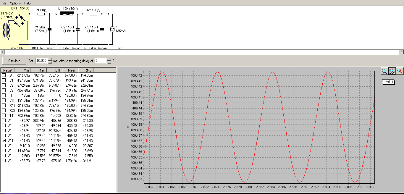

I want to try to create my very first PSU, and I'm just a very newbie.
First this is want i would like to archeive..
1) Only using the ClarityCap TC caps in this Design.
2) Limit the use of Capacitors to get an acceptable level of ripple.
3) use a choke to limit Capacitors values.
4) I have some limited space so I cant use more than 1 choke...
I'm using PSUD2 and have some questions.
My homemade PSU design has some kind of ringing the first up to 2 seconds.
Is this a problem, I'm using a soft start delay at a least 40 seconds.
Ringing
Quite stable after 2 sec.
/Thanks Michael

Put chokes and capacitors together and you have the potential for ringing. A lower quality choke with higher resistance would damp it down a bit. Also, the actual load may be more like a resistor than a CCS so that would add some damping.
If I have done the maths right, the frequency of this "ringing" is 100Hz. Which is the frequency of the rectified mains.
The amplitude is only 5mV pk-pk.
I would not worry about it.
CHeers,
Serge
CHeers,
Serge
Or are you talking about the overshoot at about 0.5s. They are difficult to tame. Small capacitor (10-100nF) on both sides of the choke to ground.
Serge
Serge
I think I managed to build a better circuit.
Here is the new one.
And simulation after 2 seconds.
/Michael
/Michael

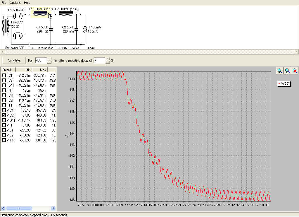

I have been building the Loftin White "inspired" amps you discuss for some time now, over ten years.
I hope people do not copy your first attempt at a power supply, shown above !!
Here are some (hopefully) helpful suggestions I would like to propose:
1) In lieu of Clarity Caps, in 2016 we can use industrial-priced WIMA DC LINK caps to great effect, they sound wonderful, order their 4 LEAD ones, not two lead
2) Low ripple you obtained ( 4.81 mVAC ) is NOT the design goal to 2A3 Finals, never was, never is !! You can have up to 800 mVAC of ripple to the 2A3 plate, and it will be fine.
You want low ripple to the high mu Driver tube in a two stage amp, usually 2 mVAC or less. A simple R/C network, after the current-hungry Finals stage, to feed the Driver stage, neatly accomplishes this.
3) You need to use a tube rectifier, to avoid turn-on problems with the various tubes. I prefer the sonics of directly heated rectifiers.
4) The design goal and the KEY requirement to a tube amp's power supply filter, especially for a 2A3 type tube, is to have as LOW of a series resistance in the B+ filter as possible, feeding the 2A3 Finals stage.
Your two PSUD examples' total "roughly" 369 Ohms and 258 Ohms of series resistances, I would highly suggest you look carefully to see how I reduced it to "roughly" 22 Ohms.
5) Use an "L" input filter, immediately after the rectifier tube. It need not be L-Critical at all. Use two L/Cs in series, to achieve DCR and filtering goals to the Finals
5) Power Supply capacitors sound best to me, and others, when they are small in value. I prefer 50 uF as a maximum. When caps are larger than 50 uF, under dynamic conditions, the low impedance caps get re-charged from the supply, AHEAD of the 2A3 tube. This results in lessened dynamic contrasting at the loudspeaker, and always a more " canned " sound from the amp.
6 ) The effective DCR of the power transformer in your PSUD simulation is 167 milliOhms. That is an impossibility.
7) You want closer to 450 VDC ( to as high as maybe 490 VDC ) of B+ in a two stage DC amplifier. Your simulated B+ is too low, it compromises the Op Points of the two tubes.
The PSUD shot I am posting is a "worst case" implementation. The Chokes are 159Y Hammonds, 600 mHY at 11 Ohms, less than $30.00 each. The bare minimum is to use two for a stereo amp, they are NOT large, fit under the chassis.
With two L/Cs ( as in L1/C1/L2/C2 ), ripple to the 2A3 Finals stage will be under 800 mVAC.
Want lower ripple to the 2A3?? A better topology is to use " one " shared L1/C1, into a "Y" with a separate L2/C2 for each channel.
An even better topology, and what I like, is a L1/C1/L2/C2 for each channel of a stereo amp.
Best yet is a Dual Mono Stereo Amp, or two monoblocks, provides the utmost in clarity.
One other important thing, we can PSUD2 supplies till you are blue in the face, trying to optimize and trade-off conflicting goals. You can EASILY get a better PSUD screen shot than what I have posted. My challenge is this " Will it SOUND better " than what I have suggested here in this post. "I" think not !! Try it and let me know what you hear ! 🙂
There is no free lunch. In the end, we all listen to a modulated power supply. How good is yours ??
Jeff Medwin
