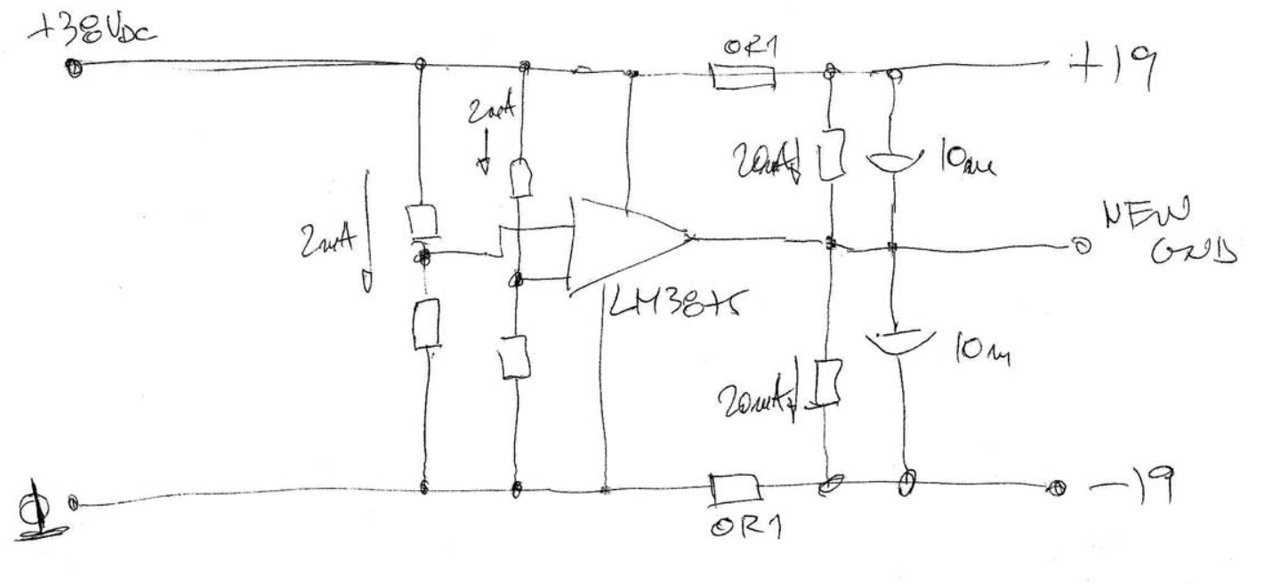

Nice! A lot more efficient than I was expecting, which will be beneficial if I do the quad channel currently planned. Thanks-

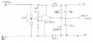

54W is coming out of the Sorensen benchtop supply measuring 39VDC @ ~1.37A. That feeds voltage dividers that power an audio amp that converts one of the rails over to -V. ..........
nope
thingy is dividing existing two rails and establishing 3rd one
you're deciding to use that 3rd (centered) one as GND, thus lower one becomes (more) negative and upper one stays positive
these 0R1 resistors in upper schematic are ones I'm mentioning in other thread
increase them slightly and you're good
