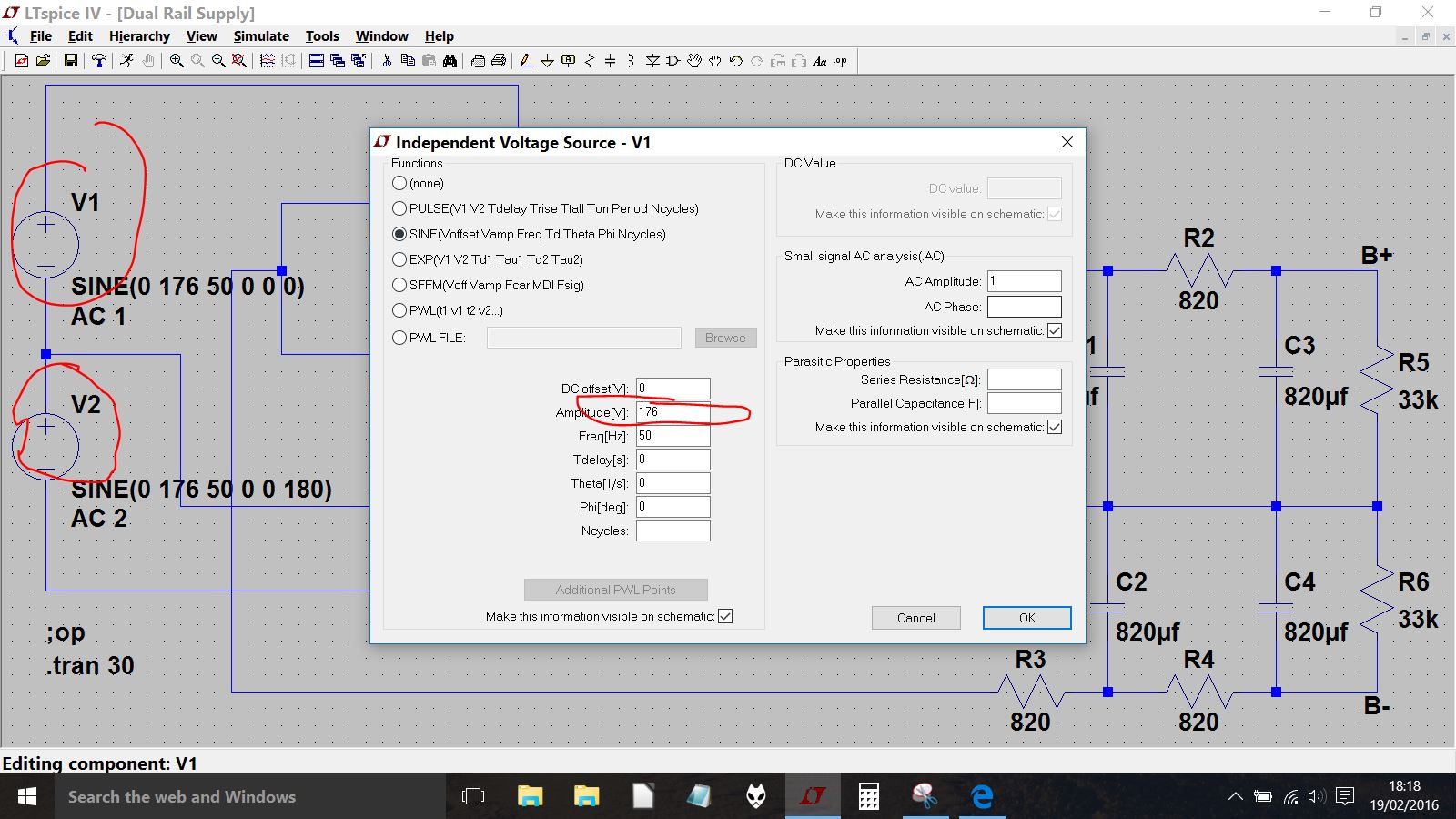

A 125 volt transformer is actually an rms value (125 vrms) and the way LT works is in peak voltages. So we set the two voltage sources to give the peak voltage which is around 176 volts (125*1.414 which is 176).
If you right click each voltage source you can change the peak amplitude from 100 to 176.

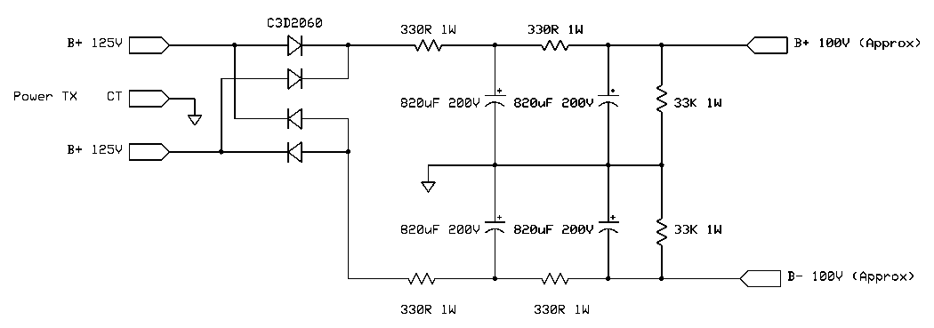

Just to point out, R1,2,3 and 4 should be 330R.

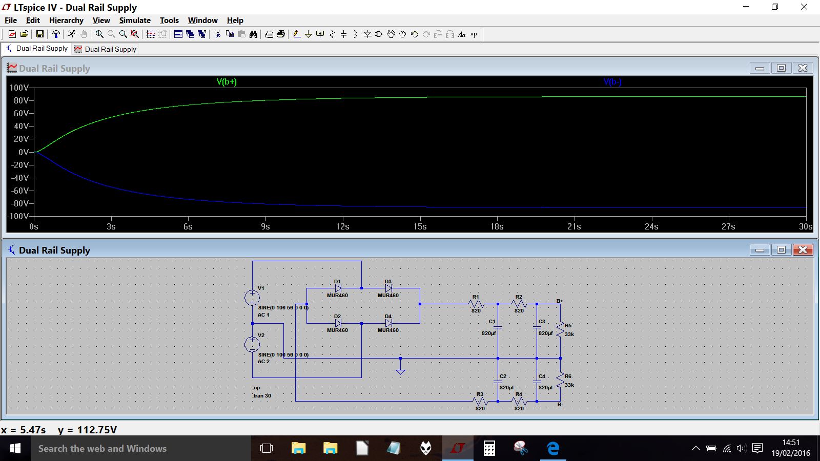

I tried your updated file and it now seems even worse than before. Now I'm getting less than 2V on the output.
From what I've read the total load across the output should be 120mA but you have 120mA on either side. So I don't know what difference that will make. I tried changing back to a resistor load and that still isn't right either. So I don't understand what's going on.
I'm not sure why there's no input cap. This is a design I found online HERE. The schematic says that chokes can be used instead which would make more sense and that's why I wanted to run some simulations to see how much difference chokes make. I was also quite shocked at the value of the caps as I'm used to seeing much smaller caps in tube amp supplies but I guess the voltage is quite low compared to a power amp.

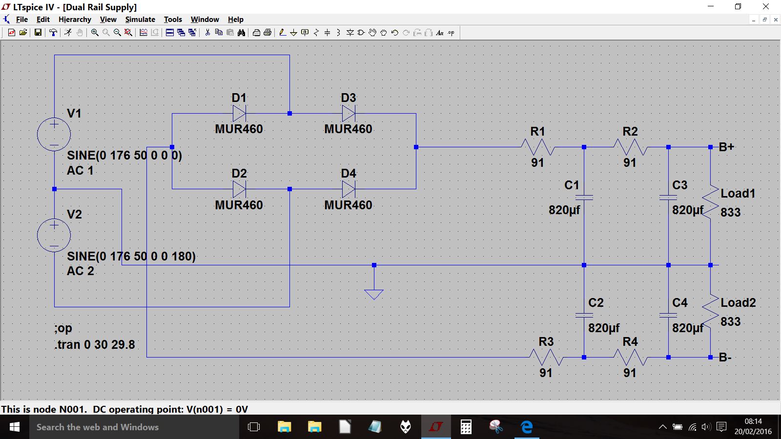

This isn't making sense on the power supply front...
The article specifies a 125-0-125 volt transformer. To set that up in LT we calculate the peak voltage which is 176. That's an absolute.
Where does this 120ma come from ? The circuit shows 12 individual stages, all with 11k cathode resistors. Assuming each stage has the cathode at 0 volts then we have a current draw of (100/11000)*12 which is 110ma, OK lets say 120ma all in.
Next up and he says that the circuit is running at -/+100 volts (or 200vdc in total)
So lets now set the simulation up to emulate that. The load has to be 200/0.12 which is 1.666k in total. For our split supply that means 833 ohms per rail.
Check the maths. V supply is 100 volts. I = 0.12 amps R = approx. 833 ohms
Plugging these numbers into the simulation and we need around 91 ohms for the four resistors. They would need to be at least 2 watt rated.

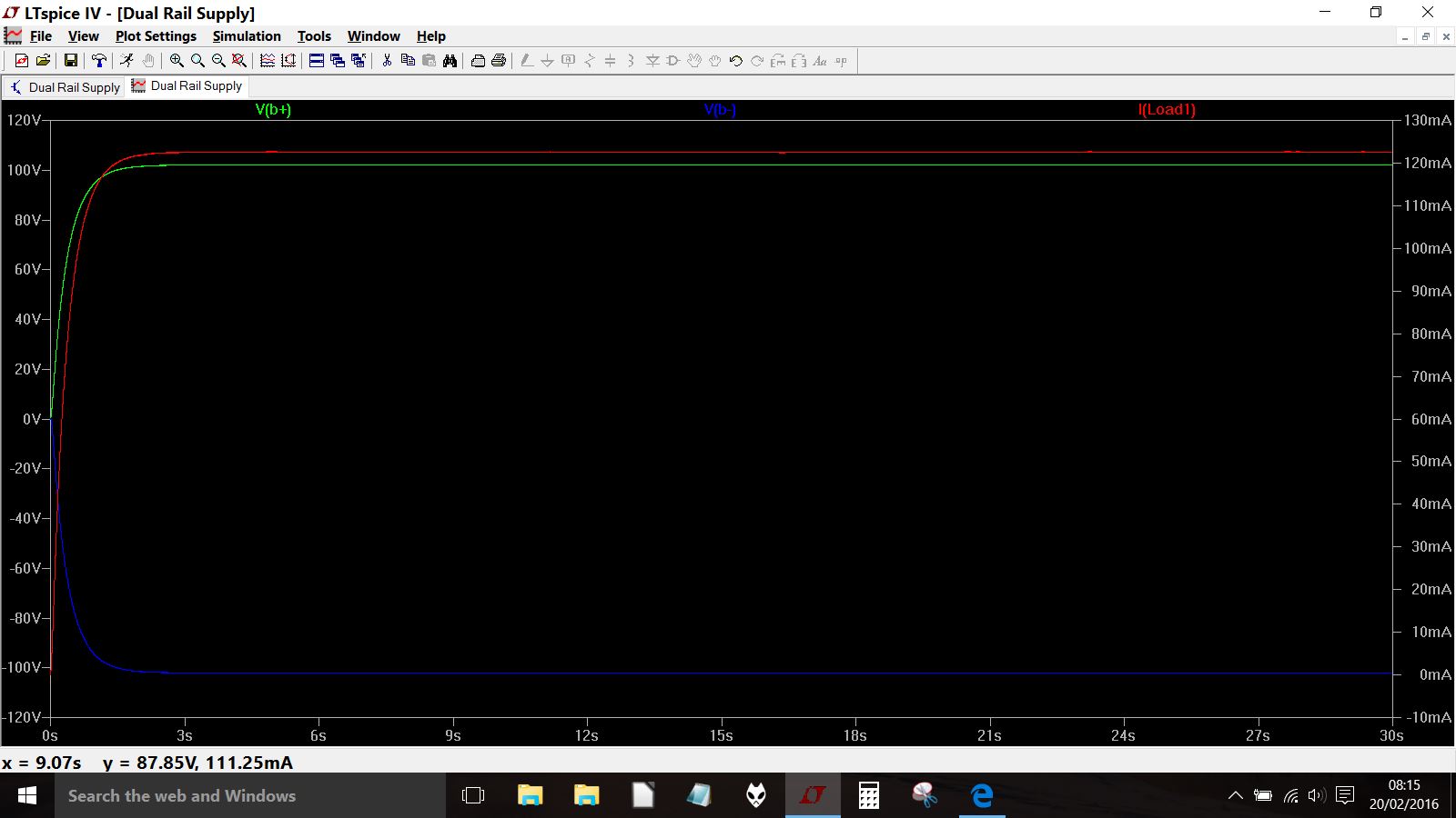

Here are the voltages and the load current (load current scale shown at the right).

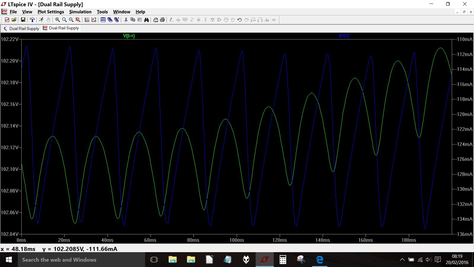

If you now edit the simulation (right click the schematic and select Edit Simulation CMD) and change the time it starts saving data to 29.8s then you can look at the ripple.
This is showing the ripple voltage of B+ and the current in R2. You can see that even after 30 seconds that there is still a definite slant to the voltage... its still not stabilised. Try setting the sim for 300 seconds in total and to start saving data at say 299.6. The sim will take a few seconds to run, the progress is shown at the bottom left.
