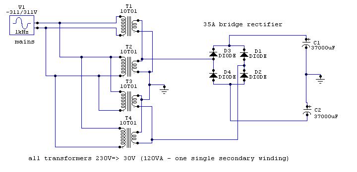

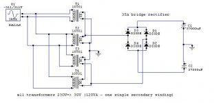

I've checked out many amplifier designs, and especially the PSU designs. But there's a big difference in the recommendation for the power of the transformer (sometimes it varies about 2 or 3 times for the same output power).
So, I would like to ask you what class AB amplifier (stereo, maybe 4 amps bridged) (?? watts) I can build with 8 transformers of 120 VA (1x30~34V). The transformers can be placed in parallel without any problem (because that's what I'm doing right now). The amount of capacity is no problem...
The load will be an 8 ohm speaker. I normal conditions the amp would play 2 x 100W (rms) into 8 ohm load, but what is the limit I can push the amp to (without blowing any transformer) when we need some more power? (in this case quality of sound isn't that important)
I would like to protect those transformers against too high currents with fuses, what fuses should I use there the max. current in the secondary winding is 4A??

do you mean that I can handle that with four 120VA transformers with only one secondary winding (maybe this wasn't clear with my explanation above).
so I've build this supply (and have the components for the second one). It would be fantastic if I can drive a 4 ohm load with this psu.
EDIT: the 1khz of the mains isn't correct of course: must be 50Hz

Jens,
maybe a good idea, although I didn't have problems with that single bridge. I'm thinking about using a bridge for each two transformers in series, and then connect the outputs in parallel.
do you think I can drive a 4 ohm load with this psu or not? Because I'm a little confused about what I've read about the psu's in the articles I've got here...
HB.
to hugobross
To drive a four ohm load continuesly it will problably not be enough, but if you have a good amount of caps, I'm sure the result will be ok.

I still think seperate bridges will be best
\Jens

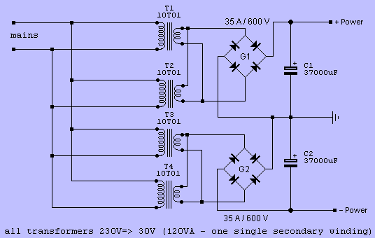

kristijan-k said:
Hello,
Here is an example of one other way.
(two bridges)
Best regards,
Kristijan Kljucaric
http://web.vip.hr/pcb-design.vip
This is better imho. This way you can make two completely separated psus. You can then run the two returns (ground points) to a star point together with the speaker return. Makes the grounding (and sound) cleaner for the same price.
