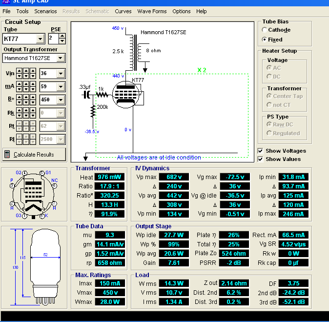

The quiescent current can reduce to zero when the tube is close to turning off (max negative grid voltage), and can almost double when its driven towards max signal (close to zero grid volts).
Attach the results from the Tubecad SE app.

Perhaps the issue to better appreciate is what happens during a single large-signal cycle. In an SE output stage, the valve is designed to cycle between the limit conditions of zero current and saturation current. Apart from the rising distortion the valve is introducing if pushed closer to those limits, the voltage applied to the output transformer primary winding is also modulated by the primary winding resistance and that current excursion.
Yes, and the Tubecad app is great for enabling you to see how the distortion changes with plate current and grid voltage swing.
Also useful for comparing 1,2,3 or 4 parallel tubes. For example. 2 KT77 pushed hard produce 18watts with a Hammond 1640SE OTP (1.5k) and fixed bias with distortion of 13% 2nd and 2.55 third.
Four in parallel with the same supply voltage (450) and transformer, produce 28w at a lower 50ma plate current and distortion of 7% and .6%
This is the beauty of Broskie's SE design app - well worth $10.
You can amuse and educate yourself at the same time for hours as I have done, trying different transformers and tubes, paralleling them, changing the bias from cathode to fixed and varying the plate volts.
