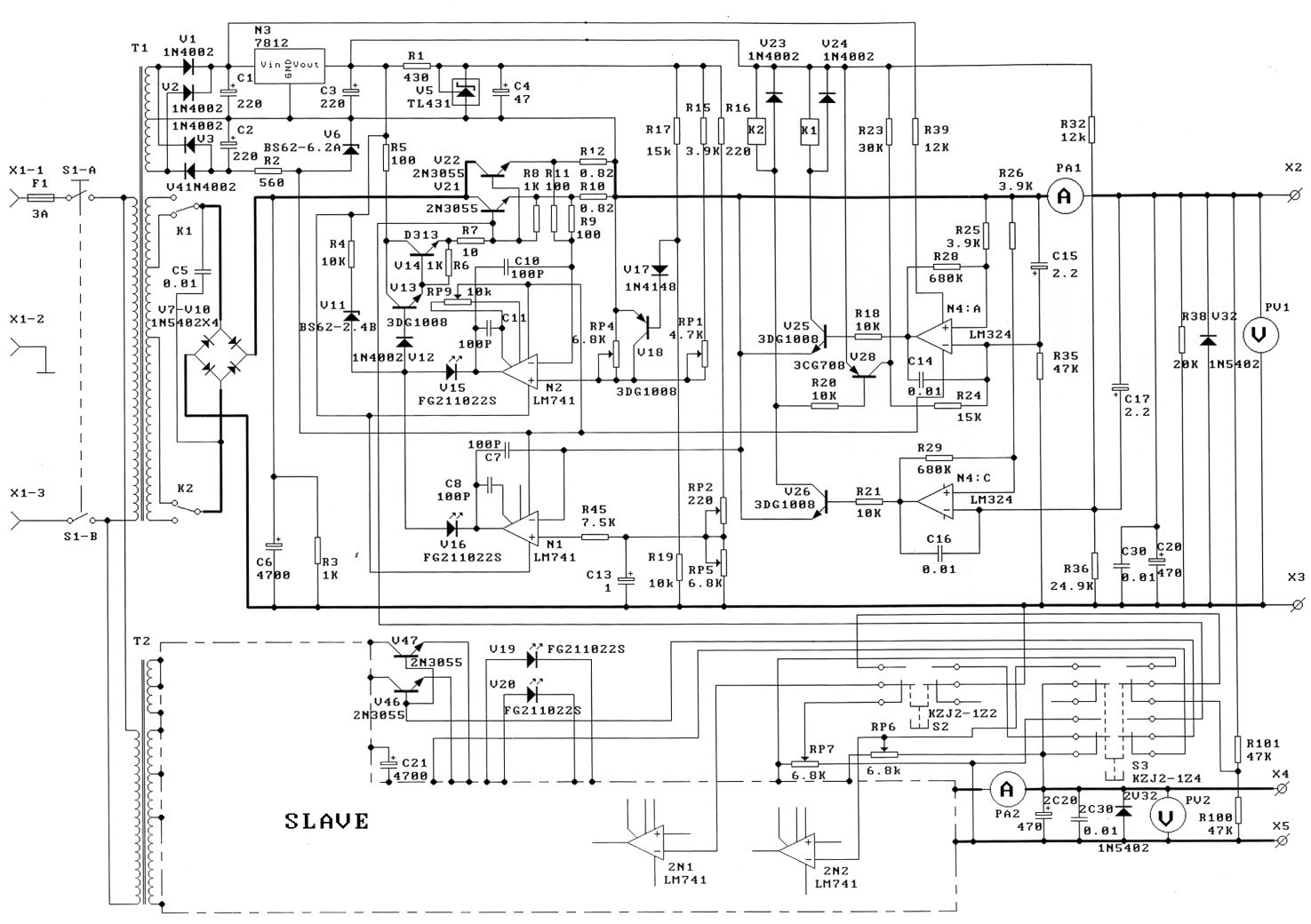

hi all i have this sick skytronic 0-30v/010a psu,its busted and need a schematic for it,any ideas?
on turn on the v meter reads 002v amp meter 0 no output and output wont turn on or off,so far i have replaced all bridge diodes 2 relays and 2 driver transistors+ pre drivers,seems the 555 output toggle crt has issues,flying blind with no schematic tho,it has 3 separate pcb's.
