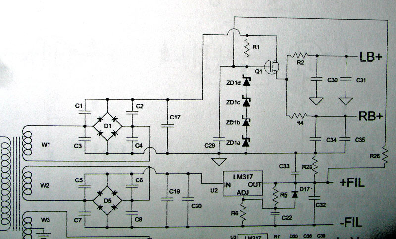

You maybe asking which PS is better , tube or solid state? Well solid state is very good if design is good. I prefer regulated PS with Hexfet as the regulator and zenner diodes as voltage references. Ofcourse ultra fast rectifier diodes , low ERS caps (I use MKP 68uF 600v for best results) must be used. Tubed PS are more expensive and they have much higher inner impedance which can be very tricky. Try somthig like this. It has nice feature , the high anode voltage is not activated until the heater of tube is warmed.

Well, I know how to build a voltage regulator or current regulator. I'm looking to understand which type of regulator will be best for a SRPP.

Well, he's right too....
Be it for an SRPP stage or any other topology for that matter you'd want the plate voltage to be stable as that's how the working points for the valves are defined.
Current won't vary much anyway as almost all of these applications will be biased for class A operation so that point is moot.
The SRPP in particular likes to see a clean, stiff PS since it has little PSRR of its own.
Shunt regulation is reported to sound better than series regulation.
Nothing stops you from combining both and take advantage of the intricacies of either one....
