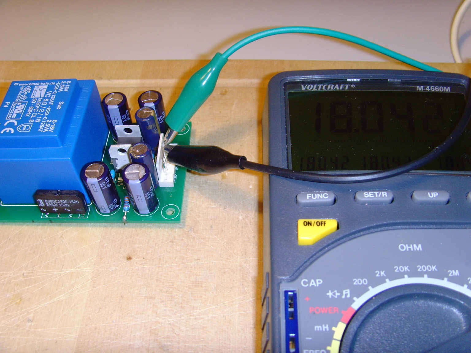

Frans: I have replaced the 1R - C-R-C - filter resistor by a 33R one (look at it - keeping in mind the voltage drop across it) and have connected the output to my Tektronix 465B.
I am not able to show you any variances on the output voltage!
The layout of this PSU seems to be quite o.k. then!

The "shape" of the ripple waveforms should look VERY different on the two Cs of the CRC.
Have another look.
If you can't see any difference in the shape, then 33r is still too small !!!!

Yes, it all depends on the current through R (and the voltage over as it is I * R). Also check Ft at '1 / (2 pi R C)' where C is the buffer capacitor, the -3db point should be considerably below 100Hz (I would say the 10 Hz is a nice target).

The point of this all is, by removing noise from the regulator input it (the regulator) will be able to do a better job. To see how this job is performed, you should load the regulator with a (as large as possible within the design limits of the PSU) dynamic load. Then you check the currents flowing in and out of the first and second capacitor (of the C R C) and there you will see large differences. Also you will see that the PSRR of the PSU has improved, the output/line regulation will only marginally improve (but there will be an improvement) and this is harder to spot (a FFT analyzer may be needed).
And you should load the supply with the approximate current your sink will draw when measuring ripple! 35mA for the calvin buffer? Try 500Ohms/min. 1W.
