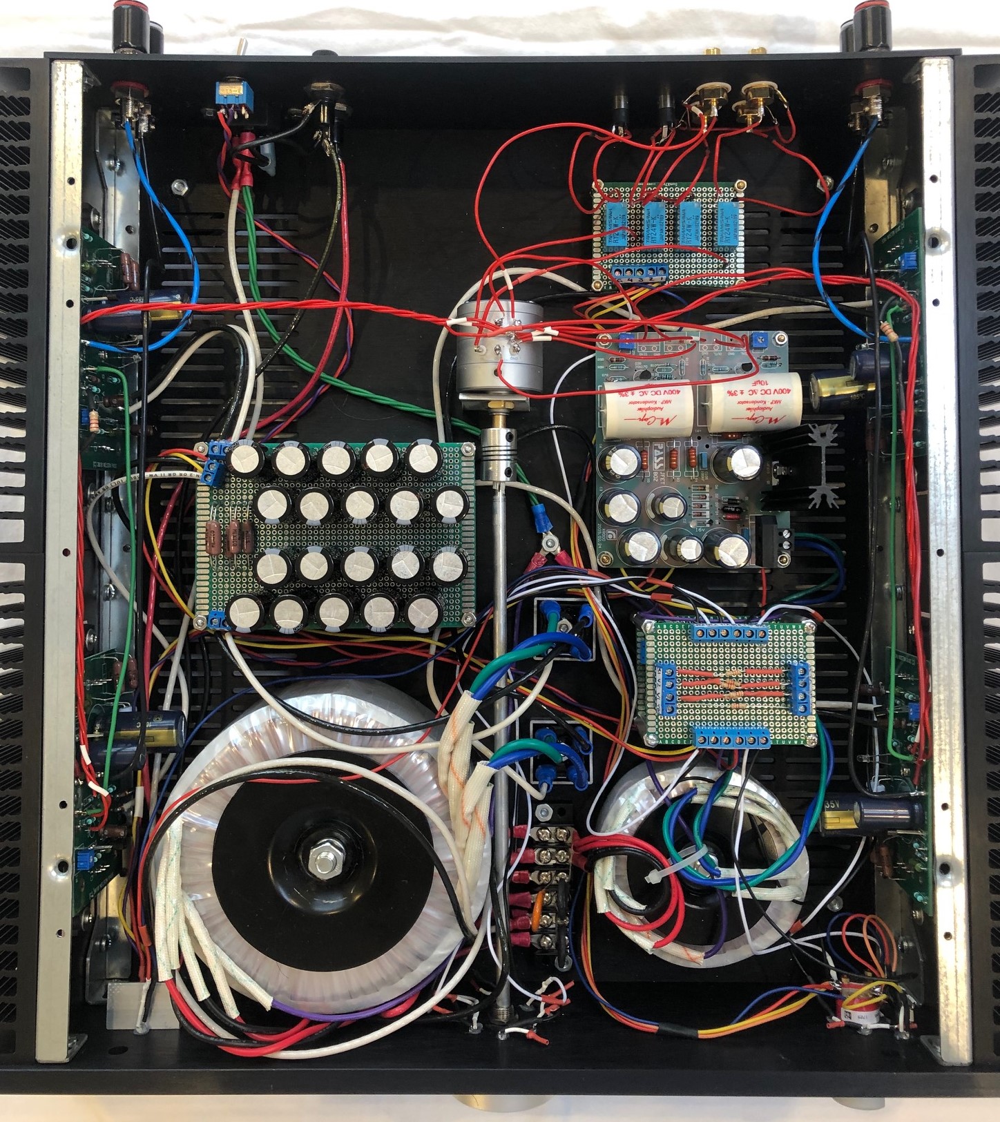

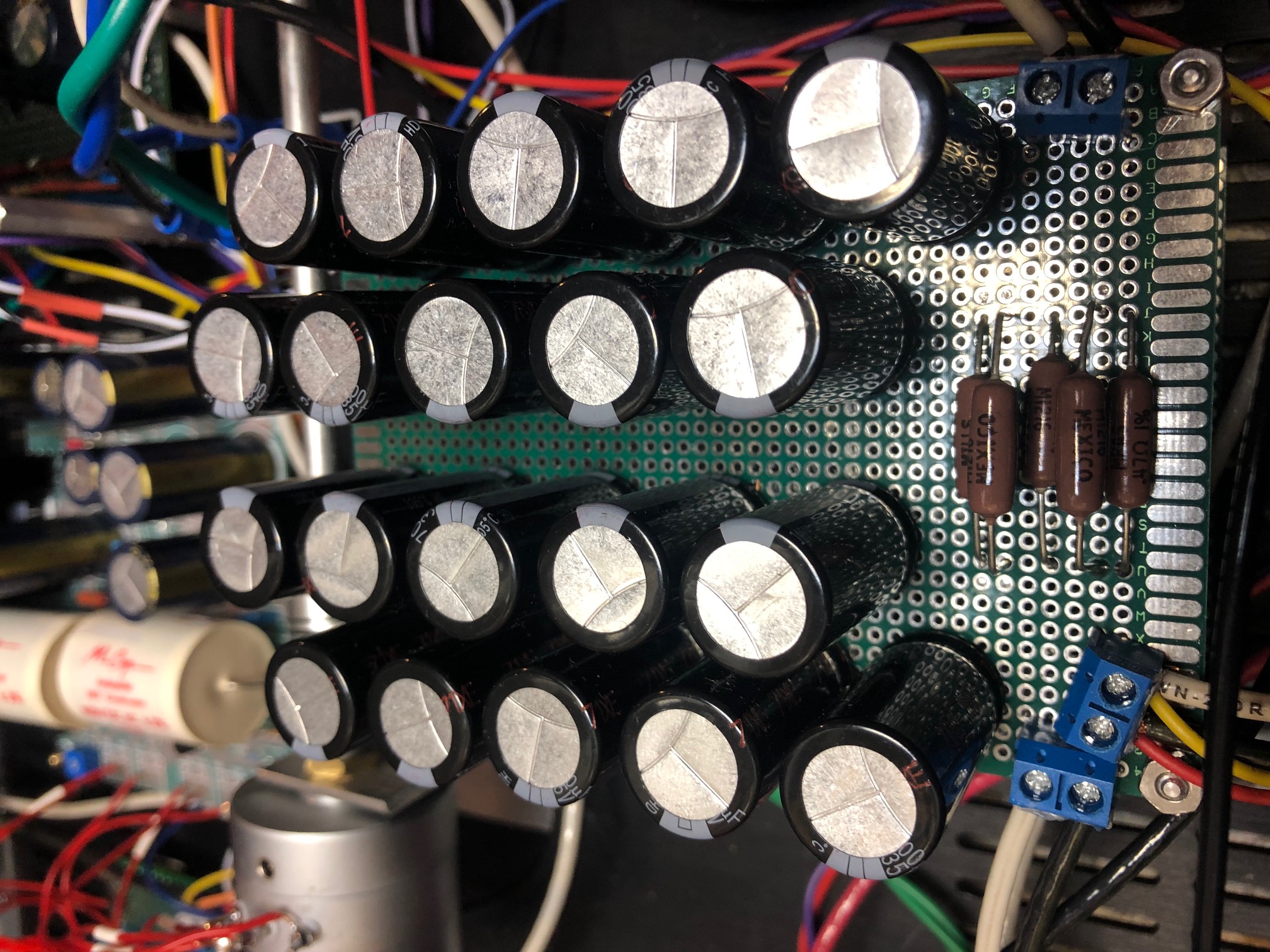

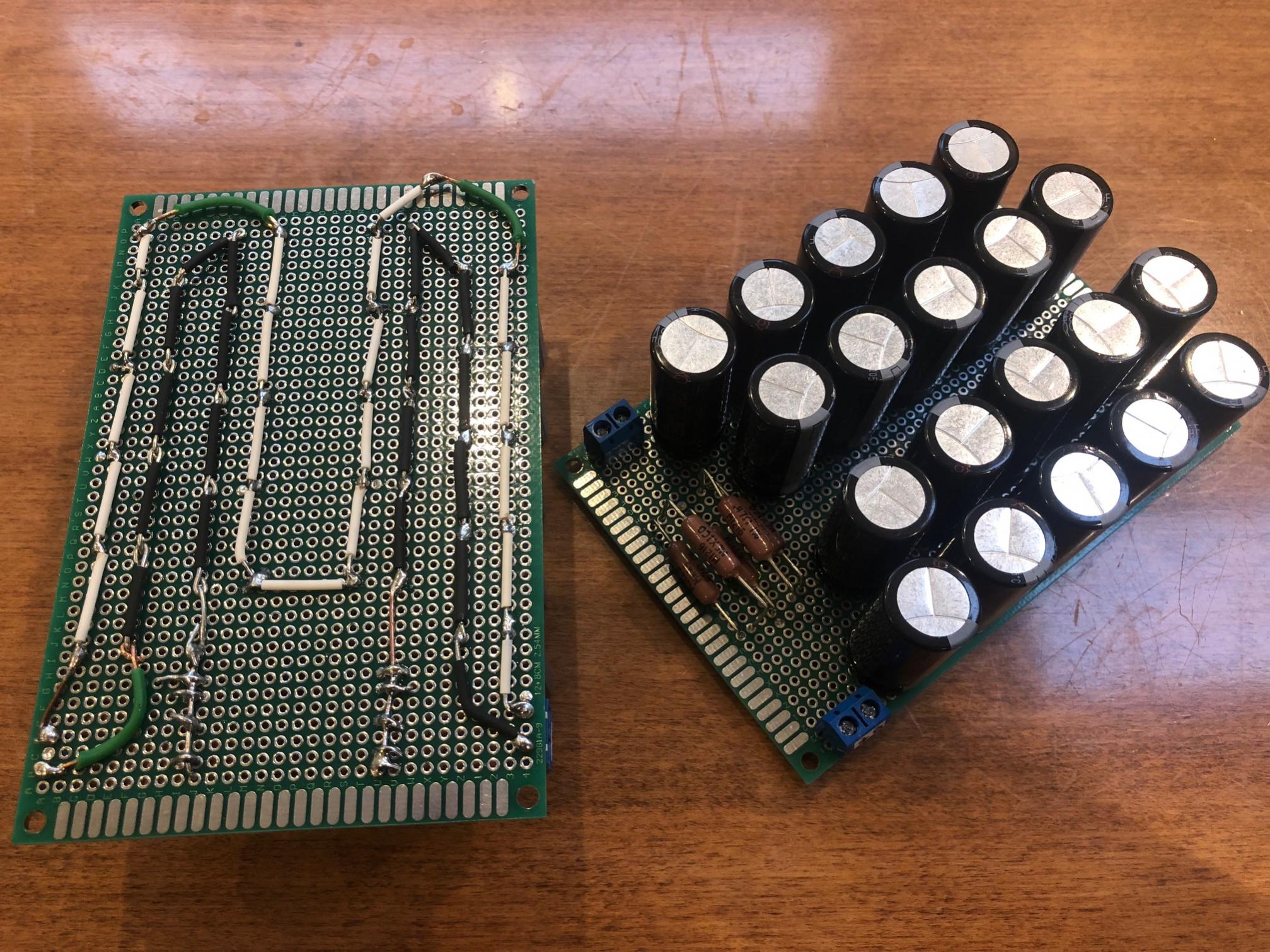

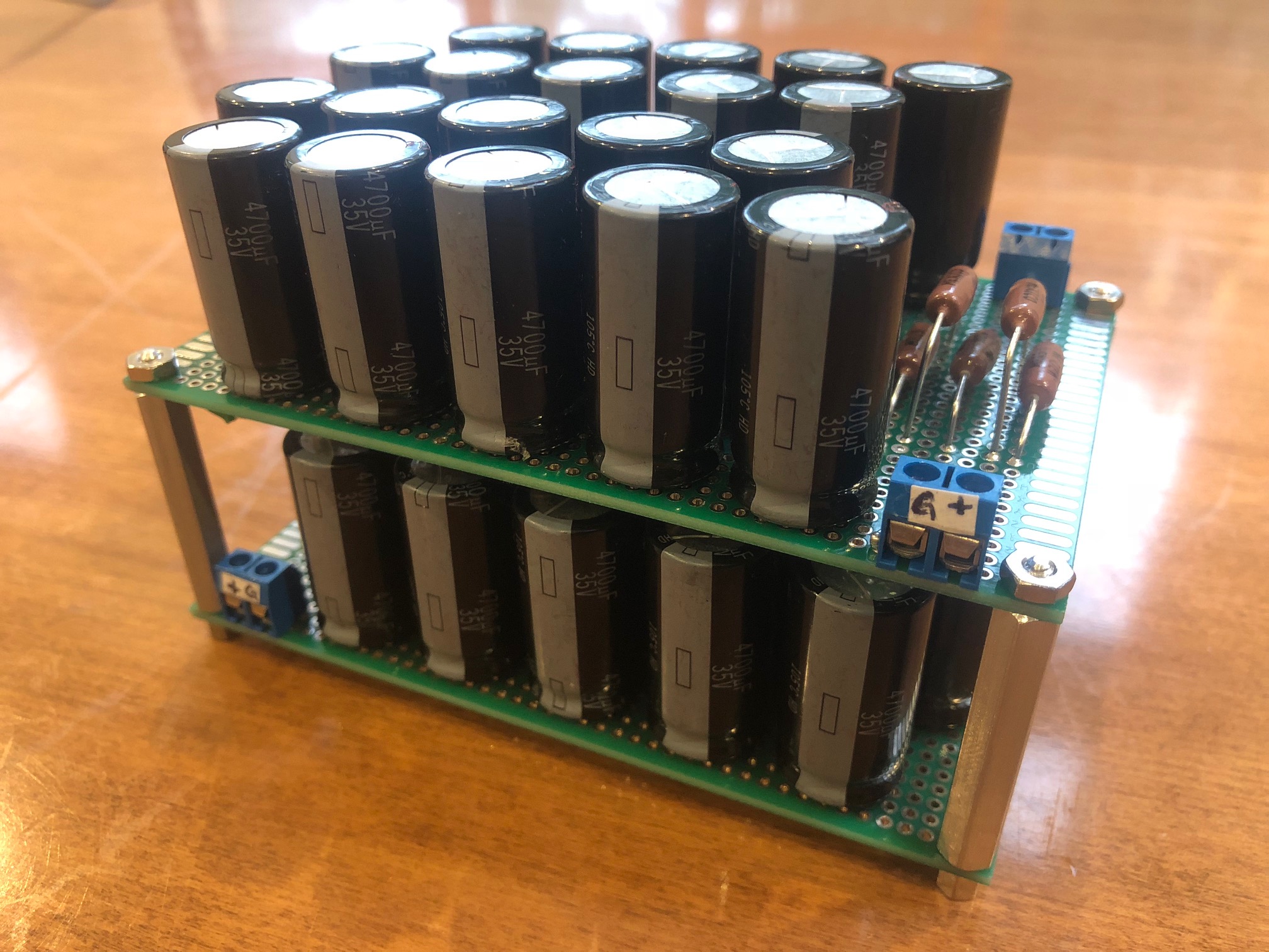

You're on the right path. In an unregulated circuit like the one you're contemplating, the rail (i.e., DC) voltage is largely dictated by the voltage on your transformer's secondaries. Use a transformer with 18V secondaries to get about 24VDC after your rectifiers. I built an integrated amp (BOZ preamp and bridged ACA) for my daughter a few years ago which included two power supply boards for the amp -- one board for each channel. Here are a few photos.
Scott

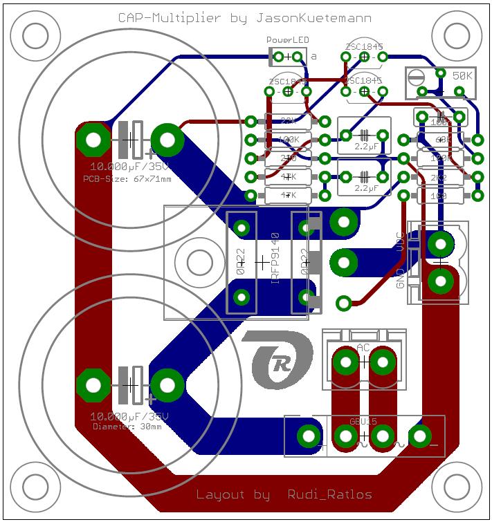

Ian, did you ever read Rod Elliotts article concerning a "CapMultiplier - PSU" as the ACA's PSU?
Capacitance Multiplier Power Supply Filter
I did! And I have built one, connected it to my ACA and have been absolutely astonished about
how much superior the sound has been compared to a wall-market PSU, to a SMPS, the forum's
proposal, ...
It is your decision, it is your ears - Rudi
P.S.: Find attached a PCB look-through of the CAPMx PSU that I am using to power my ACA!

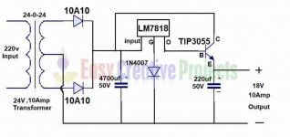

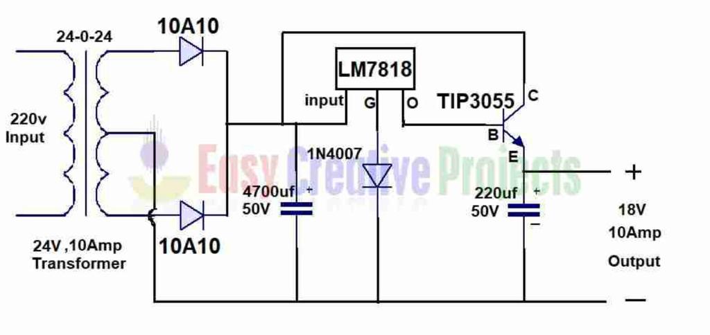

stepdown regulator 24v to 18v scematic psu single rail psu for L 18v & R 18v set bias 8v or 24v lenier psu set bias 12v to suplay both chanel L&R chanel ?
#KEFF coda 70 bookself 2 way speaker
