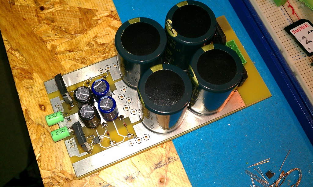

I've got a split rail PSU which outputs, say, +/- 50V. It's past the range of input for a normal linear regulator, but I want to run some op-amps in the same box for DC servos, and probably speaker protection etc.
So, would a simple zener/emitter follower be good enough for running the op-amps? I can only envisage 10s of milliamps being drawn from these rails, after startup. Obviously though, I want a nice "clean" PSU for if I decide to put tone controls in, for instance.
So, in the end, I'd have +/- 50V, and a +/-15V derived from that. Any ideas welcome.

Ok, so with regards to the linear regulator, my concern would be the main supply rail dragging the LMxxx to it's output hard against the differential voltage limit. I've seen some LM317AHVTs that allow 60V input / 57V differential, but after finding some negative opinions on the LM series, I want something more flexible.
So, zener / transistor... I simulated this and some other basic circuits on LTSpice last night, and was pleasantly surprised to get 15V/26mV ripple @ 5A load from an op-amp feedback solution and a 2n2222/2n3055 darlington arrangement, running from a 30V supply with 5Vpp 50Hz "ripple".
As the PSU op-amp only needs to track up to it's output supply, this means I could most likely get away with operating the op-amps from a quick and dirty zener supply at ~30V.
This would allow input voltages as high as +/- 75V, but then if I'm drawing 500mA, that's (75-15)*0.5 = 30W to dissipate - per rail. I suppose that's the price you pay for not wanting SMPSU noise in the amp box though...

Well, this is what I came up with. Simulated, designed and built this PSU. It's got +/-45V main rails, and uses a zener regulator + op-amp to drive IRFP240/9240s to get the +/-15V for the DC servos.
Simulation predicted 20mV ripple; I've yet to measure it though. Voltages check out ok on both sides under a quick test but there need to be some mods before I'm 100% happy. Still, it works 🙂
