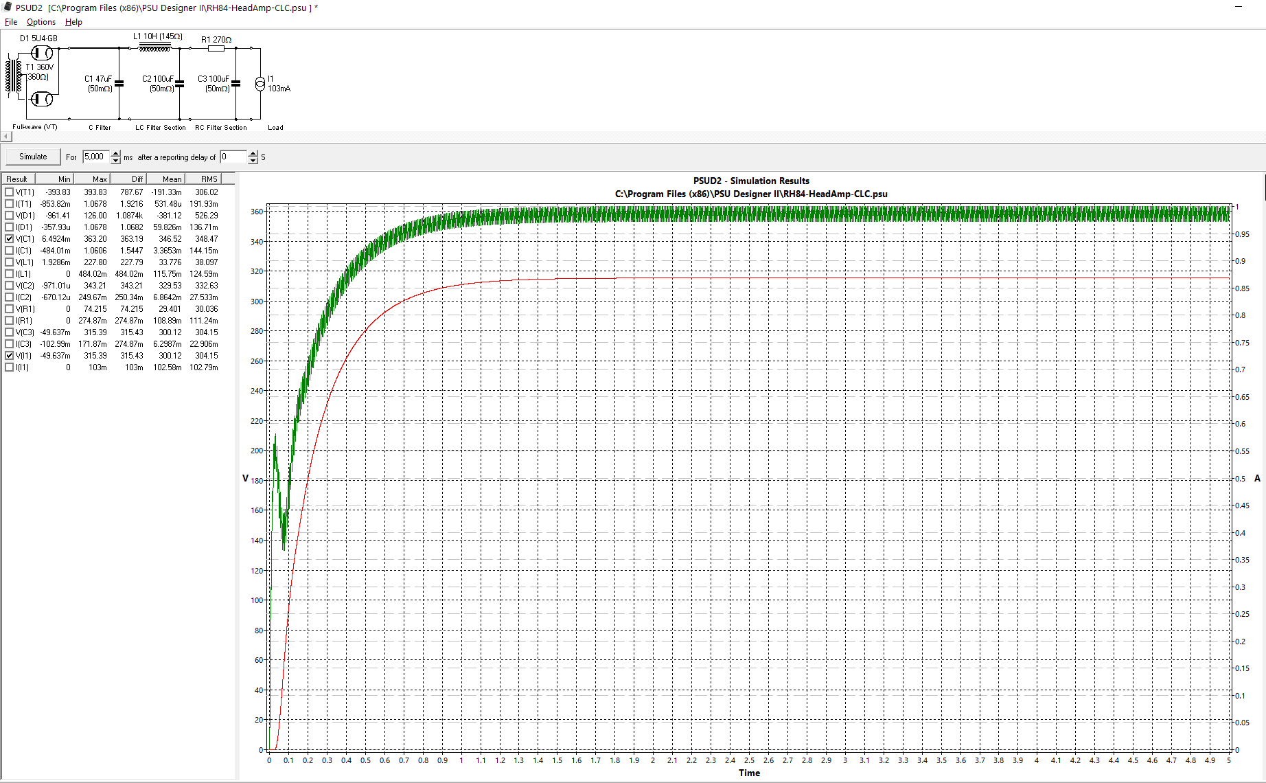

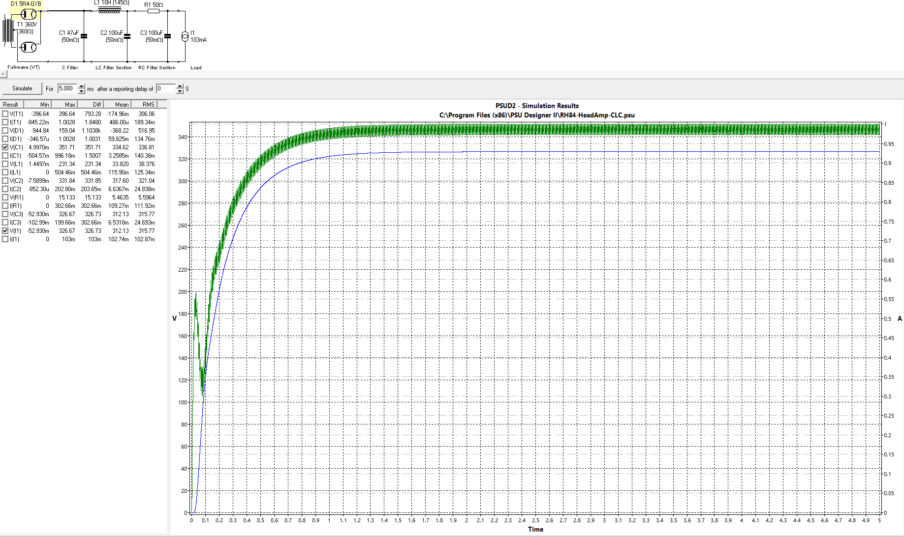

I've got 2 semi-related questions regarding PSU in SET amp.
1) CLCRC (tube rectified).
B+ 315V @ 100mA.
L = 10H, 150ohm.
2 combinations reach the same target voltage,
-5U4GB with R=270ohm
-5R4GYB with R=50ohm
The first option has more resistance in the PSU (420ohm vs 200ohm), but lower ripple (based on PSUD).
Also, alot more voltage is burned on the resistor vs. the rectifier.
Which is better and why?

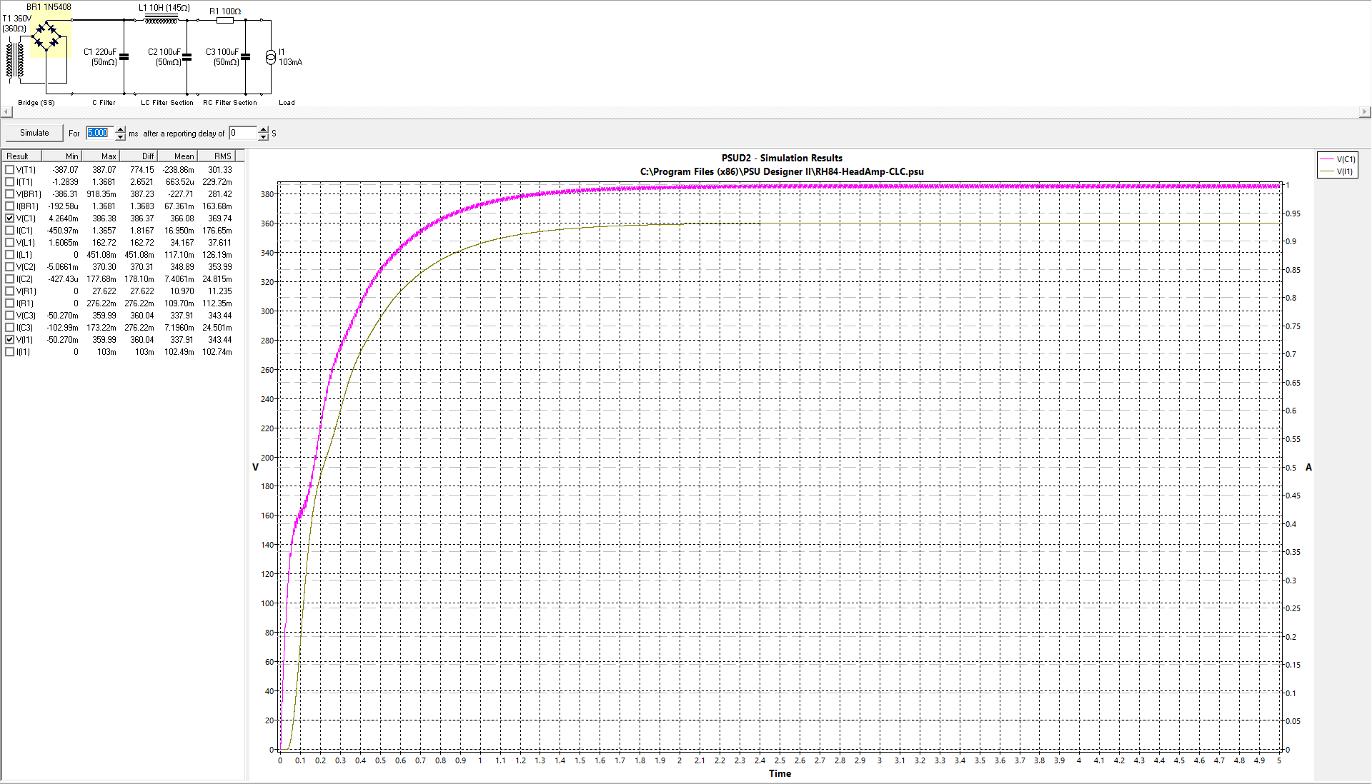

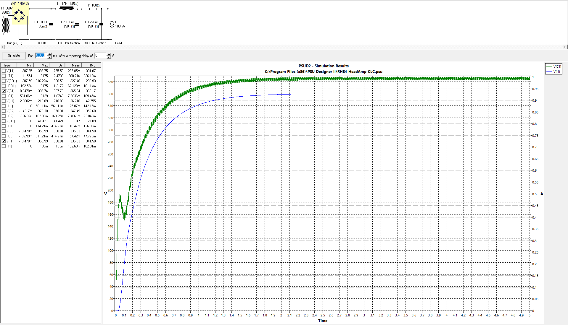

2) CLCRC (SS rectified)
200uF-100uF-100uF or
100uF-100uF-200uF
Is there a difference?
PSUD gives about the same ripple result at the last cap, is there any other consideration?

For question 1:
Attaching the PSUD, although the question was more theoretical (i.e, is load regulation better with less resistance and voltage dropped via rectifier or the opposite)
Ripple for each is (running sim. after a few seconds)
5U4 is 793uV
5R4 is 3.7mV
Note: the 5R4 voltage is higher in the sim. but in testing in the circuit, these values for R result in the same target B+.
For question 2:
Ripple with 220uF first is 600uV
Ripple with 100uF first is 880uV.
Obviously not a significant difference, but wondering if there is any other consideration.
Why no tube based regulator?
for this specific amp, this is the PSU configuration chosen based on size/cost/ etc
