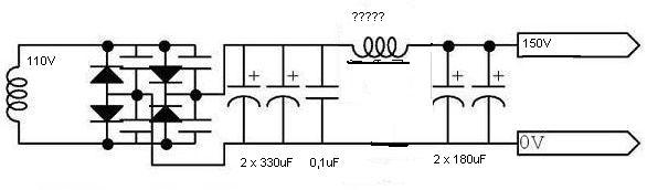

this is my PSU schematic (for tube buffer), and i want to include choke, but I dont know what kind of value it should be....
if I"m understand corectly, choke give caps more capacitance (theoreticly)....Am I right?
thanks

2mH is the rule of thumb.
NO. THAT IS WRONG!!!!
Somewhere in the region 5H-10H is usual for filter chokes for valve circuits. It depends on the current draw really. Get the PSU designer program from www.duncanamps.com and you can simulate the power supply. Its a must for power supply design.
The circuit seems a little odd to me. I'd have put the larger caps after the choke so that the power transformer is less stressed. Also IMO bypassing the later caps does more good than the earlier ones. I'd swap the positions of all the capacitors.
Not really. It does the exact opposite of what a capacitor does. It presents a high "resistance" to high frequencies.
A capacitor has a high resistance to low frequencies and passes the high frequencies easier.
So the choke tries to hold back the high frequencies while the capacitor passes the frequencies.
Because the capacitor is from the b+ to earth it "shunts" high freqs like noise and ripple to earth.
Dibbi is right that generally the choke is 5-10 H
For solid state amps the figure is so much smaller because there is a LOT more current being pulled from the PSU so 2mH usually used since making a choke 5H that can pass 5A would be pretty HUGE!
Bas
First of all, reduce your first caps to like 20uF and pull one of the two 2nd stage caps. Choke should be between 5 and 50H, doesn't really matter. Anything over 5H will provide more than ample filtering but much more than 50H will have a lot of resistance. I'm assuming you're not drawing the 400mA your capacitor values suggest.
