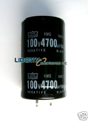

Are these caps suitable?
I saw these 4700 uF/100V caps on ebay:
http://cgi.ebay.com/ws/eBayISAPI.dll?ViewItem&ssPageName=STRK:MEWAX:IT&item=360099789249
Would these be suitable for the on-board caps for the Leach amp
(C21/C27 on Rasmussen-Leach PCB)?
The price is right, and they're rated at 105degC... I'm wondering if they're genuine Nippon Chemicon, or maybe fakes?

From looking on Nippon Chemicon's website, KMG series is not a large snap in capacitor - they're leaded radials. I wouldn't risk it.
Yeah. EBAY = fake trannies/caps
Just order from a reliable source (MCM,newark , etc)
http://www.newark.com/16M7734/passives/product.us0?sku=united-chemi-con-esmh101vnn472mr50t
Don't get burned
by junk parts.
