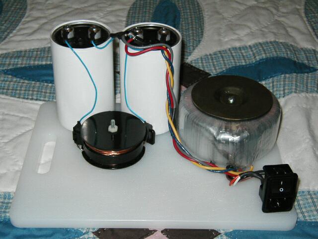

Supply for preamp I am building. Piltron 225VA (2x18V secondary) transformer, 10,000uF Rifa PE169, Harris FRED soft recovery diodes, and 4 mH aircore choke. I am using two secondary winding with two diodes for full wave rectification. Most parts are surplus and I have about $50 of parts in it. It pays to shop around surplus. This would have cost twice this for new parts at retail outlets. There are more of the tranformers availible in anyone is interested.
H.H.
