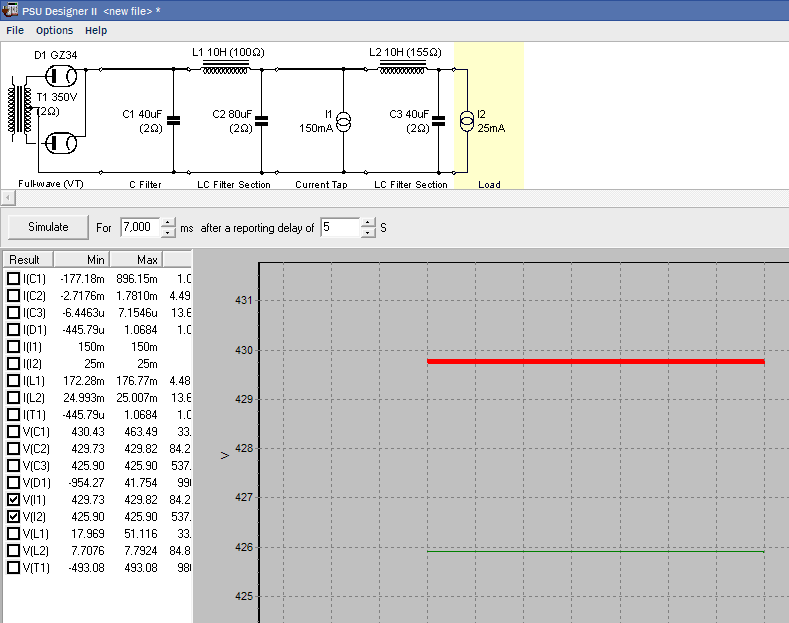

I've fiddled a bit with PSUD now, I've got an extra 10H/125mA choke that possibly could be used for the input section and a couple 40uF motor caps in addition to the 4 x 20uF.
I haven't really decided on the rectifier yet, I've got both GZ34 and 5U4G. If I'm going to use the 5U4G, I'll have to specify a higher secondary voltage for the power transformer. Decisions, decisions...
The B+ is a little bit higher than the 400V in the amp schematic, but I'm guessing that won't matter much... or will it?
If you have any suggestions, please let me know.
-Rolf
-Rolf
Rolf,
It sounds like you are on the right track. I used the 5U4G in my PS for this amp primarily because I like how they look! 😀
My B+ ended up at 425 which is well within 10% so in the tube world it is spot on. If your B+ comes out within 10% of target you should be fine.
That 125mA choke won't cut it if you are building a stereo amp. It would work fine in a monoblock but since the KT88s are biased at 75mA and the 6N1P works out around 10-15mA (I forget the actual draw) that is a total of 85-90mA/channel.
Sherman,
I'm going to build on a stereo chassis, possibly with the PSU on a separate chassis (those caps are big). I was thinking of using the 125mA choke just for the 6N1P, something like this:
C-L(10H/200mA)-C-(B+ for both KT88s)-L(10H/125mA)-C-(B+ for 6N1P) like the schematic in my previous post.
That should work OK, shouldn't it?
-Rolf
showdown said:
Sherman,
I'm going to build on a stereo chassis, possibly with the PSU on a separate chassis (those caps are big). I was thinking of using the 125mA choke just for the 6N1P...
-Rolf
Rolf,
Yes, that should work. Just be sure to measure the B+ at the point where you pull it off for the KT88s and measure it again after the last filter section for the 6N1Ps and adjust the plate resistor of the 6N1P as needed.
One thing I found with my amps from Mikael's schematic was that I needed to decouple the 6N1P power supply. As I originally built them I simply pulled the B+ from the last cap to both the 6N1P and the KT88. When pushed hard with lots of bass in the music the amps began oscillating.
I put in a decoupling filter between the B+ and the plate resistor of the 6N1P (adjusting the value of the plate resistor) and it solved the problem. I think with the addictional L-C filter after the point where you are pulling off the B+ for the KT88s accomplishes the same thing (maybe better).
