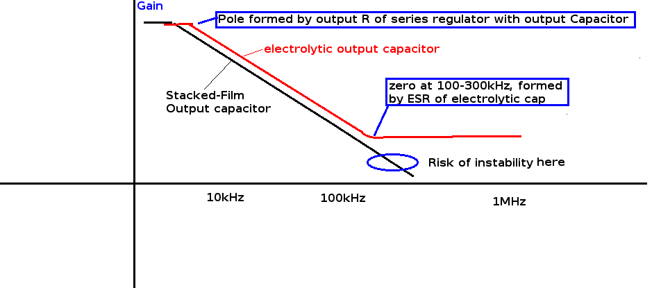

Using a stacked-film capacitor to bypass an electrolytic still looks like a risk to me. You will be forming a parallel LC tank composed of the bypass capacitance (with maybe 1nH or less of lead inductance) against the RLC of the electrolytic. The L component here is liable to be 20 to 30nH - putting the resonance below 1MHz in some cases. Actually, the ESR of the electrolytic is helpful here in damping oscillations, indicating that a low ESR part is not necessarily a good thing for audio. Remember that rectifier pulses are a severe provocation for power supply capacitors.
I don't like series regulators in audio either. IC types are bad enough, but regulators or opamps with power transistors wedged into their feedback loops are the worst of all worlds. It takes a great deal of time, instrumentation, and skill, to really tame the transient response of such a circuit.
Curiously, even some IC regulators can be made to oscillate by bypassing the output electrolytic. The older MICREL MIC5205 is pretty much guaranteed to oscillate if you use a ceramic output capacitor.
It's worth studying the reason for this instability, since the same problem can occur if you do make your own regulator. The picture tells the tale. A series regulator's effective output resistance always forms a pole with the output capacitor. With a ceramic or stacked-film (where ESR and ESL are vanishingly small) the rolloff continues above 100kHz, where the phase-shift through the regulators loop, and the effective gain may produce the conditions for instability.
With an electrolytic, the ESR forms a zero at a convenient point, and gain remains too high for oscillation.
Using a 1 or 2.2 ohm resistor in series with the output capacitor can improve the response and stability of a regulator.
Regulator Stability weakness with Low ESR output caps
This is the sketch I meant to upload:
