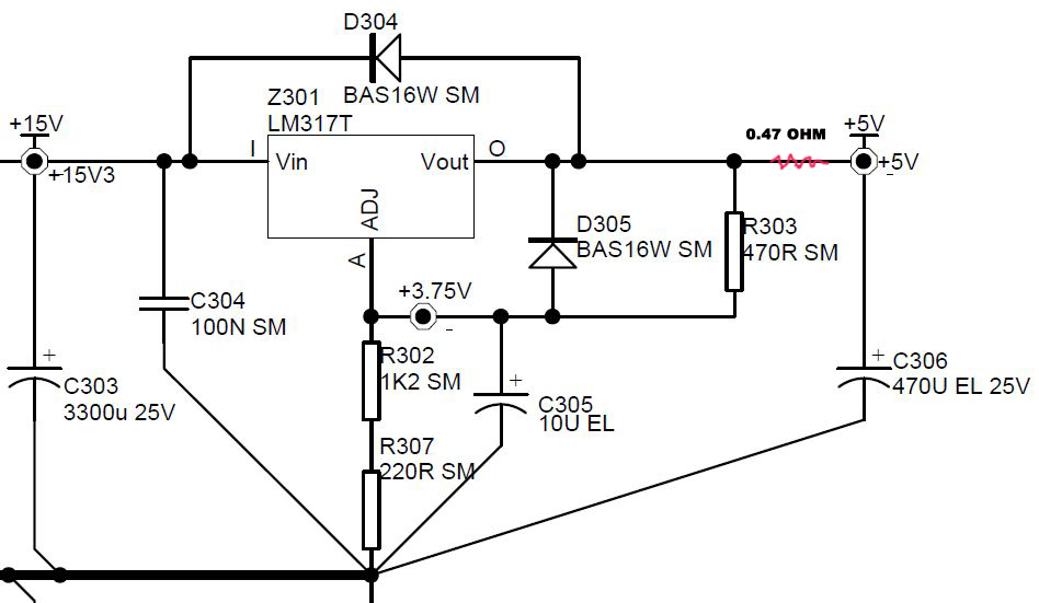

Be careful with the outpute capacitor
On the LM317
Not good that the ESR will be too low. Oscillations
If you replace the capacitor Check the cap ESR
Or do an easy solution.
Add resistor at the out of the LM317
0.47 to 1 ohm
It's is a low pass filter .
That way you do not have to worry that the cap esr will be too low
I'm usually on the outpute of the 317
resistor 0.47 Ohm in series with 470uf cap
