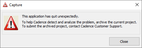

Sorry but I have a crash when clean install then just open an example (OPA197 test circuit). It is since a few months now (no program update since a few months). I just did the test again. See image.

I will stay on Tina-TI for small circuits until sofware becomes more stable (a crash with an embedded example, 1st time I see that in a software).
