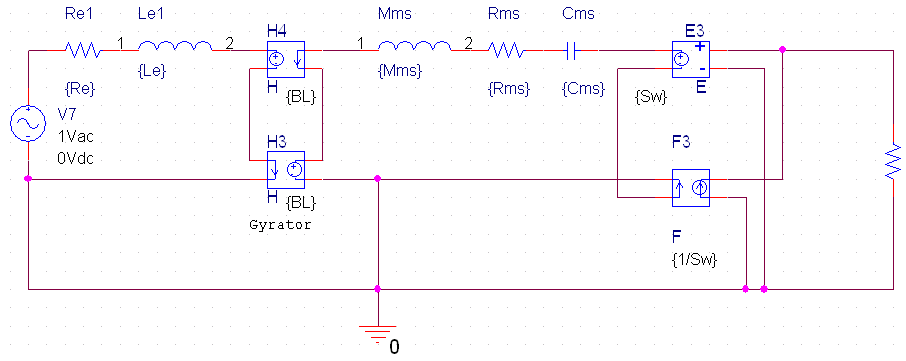

PSpice does not have a model for an ideal transformer, but there are available documentation on how to make one from two inductors.. However, I made one using a current controlled current source and a voltage controlled voltage source (back-to-back, pri voltage sets sec voltage - sec current sets pri current), so I now have a perfect transformer model with absolutely no non-ideal behaviour 🙂
I also have a working gyrator model now, made from controlled sources as well, so I am all set to implement the Basta! circuit 🙂

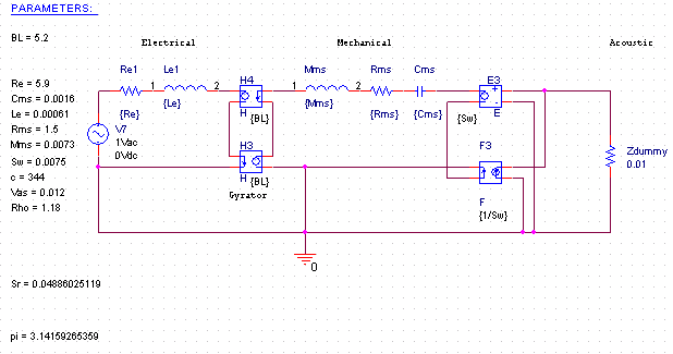

My current circuit behaves strangely, it migh be because I've not yet implemented the acoustic side properly, but the impedance peak at Fs don't seem to reach the same amplitude as my basic driver model (the one my current crossover design is made with).
Does it look faulty?
Hmm, I don't have much experience with PSpice, but it looks ok apart from one thing. The gyrator is Ok, I think, a current on one side generates a voltage on the other side. But the transformer... It is assymetrical. That is not the case in the real world. I would expect the voltage on the output to be proportional to the voltage on the other side. Both ways. And I suggest that you model radiation impedance as a resistor in parallel with a capacitor.
Lets see, apart from the inverted current direction (which is fixed now) the transformer secondary sets primary voltage with "gain" of Sw (membrane area), the primary side current sets "gain" on secondary current to 1/Sw... You are indeed right. I should set the gain to Sw on the current source as well..
It still appears the impedance peak is much weaker than that of my old circuit (about half the expected peak impedance at Fs). Will this be solved when I work out the acoustic circuit you think?

Svante; In the mechanical part of the circuit, I notice you use Mms (weight incl. air load) for the coil, while Marshall Leach uses Mmd (weight without air load) for the same component (same gyrator based circuit, only exception is Mmd vs Mms). Although these numbers are only slightly different, I would presume one would me "more correct" than the other.. which one?
Hmm, maybe it is just my definition of Mms that is odd... If you look under the equivalent circuit for the loudspeaker in the tech doc, you can see that the air load is removed from the total oscillating mass, and that that is then used as the Mms in the diagram. (Mms=...)
Put short: Leach and I do it the same way, without the air mass.

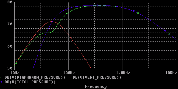

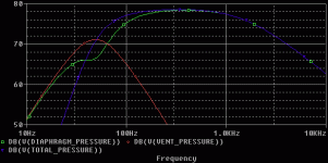

Simulation results appear similar to what my WinISD suggests. I also added the complex LAPLACE functions so now I can easily probe the SPLs from the vented box system using PSPICEs VDB probes.
This is what the L15RLY looks like (box tuning in no way optimized, I hardcoded tuning freq and chose 50Hz by coincidence, so this is *not* a maximum-flat Butterworth alignement.). This is without any crossover network.. The high frequency rolloff seems very much like what's in the datasheet of the driver if one ignore the *big* breakup nodes.. Impressing :scratch: The SPL seems a bit low though.. this is supposed to be 1m in front of the driver.

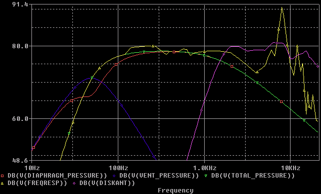

Some might call the above an overstatement, here is the yellow aneholic response on a IEC 268-5 baffle (apart from the low end, which is my simulation). Hey, if ignoring the slightly ragged top end, this driver could be used full range! 😀
The pink curve in the background is the tweeter showing where it's at. It is connected to the crossover from page 2, and has baffle diffractions accounted for (although they will need modifications as I will change the baffle). Woofer is still bypassed from the filter, obviously.

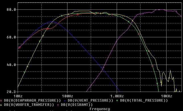

Woofer connected to the original (now preliminary) crossover. Still woofer baffle step has not been taken into account. I guess I will have to subtract the step of the IEC baffle and add the step of my BR box, since I can't measure for myself.. I'll need to read some more theory before I have the answer to that one.
Forgot to mention, baffle step included on the tweeter response is slightly off-axis (reason for the drop at 15kHz). It is the FTABLE from the initial simulation, where I had the plan I would slope the baffle.
