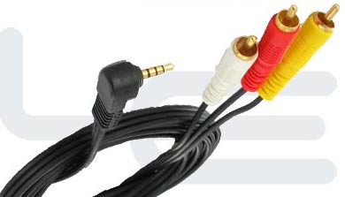

i bought a psone lcd, to try builing a projector out of it..
i can't get it to turn on, i don't have a psone, so i have no way of testing it. i don't know if it's blow or what.
i just want video in, no vga.
some insight would be nice.
thanks bob
u can use a regular 2rca to pl cable ( u can buy it in any audio store )
it looks like this :
You have to buy an actual A/V Cable that has video and left/right audio. It is available at walmart or radio shack. one end has a 3 ring mini-din headphone jack and the other end has red,white,and yellow rca jacks. It's hard to just make one up since it's looking for video to sync to on that connector. a regular stereo headphone jack isn't going to do it. I think the radio shack cable is a whopping 20 bucks. They're used mostly for connecting camcorders to tv's and vcr's but it also works for plugging dvd's and vcr's into your psone. hope that helps.
Type: rca camcorder cable into Ebay
I buy these cables on ebay all the time. They have a 3.5mm plug on one end and a video/Left and right audio connection on the other. I have never tried the 20-30 dollar "Monster" cables you can get at Best Buy/RadioShack/compusa.
You can get them for about 4 dollars a piece. They work well, and haven't run into any problems.
