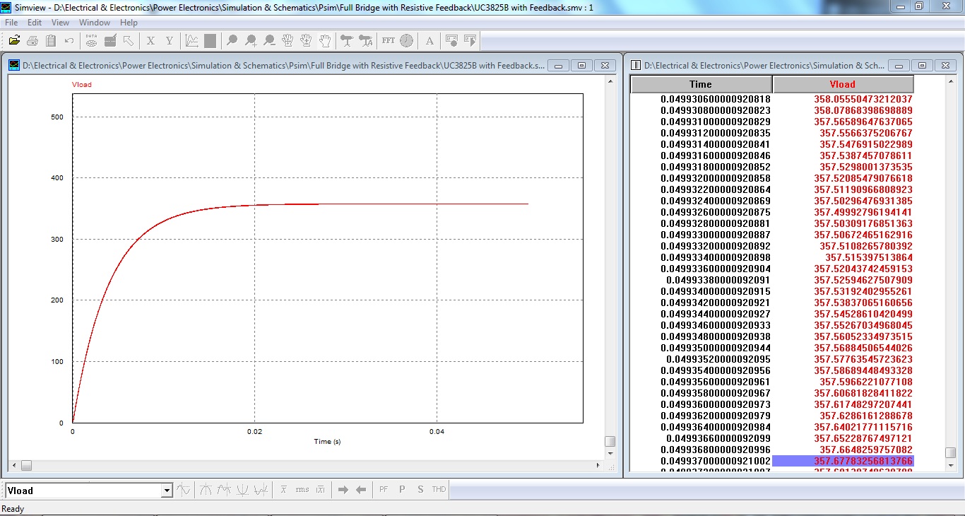

Psim and OrCAD Full Bridge Feedback & Output Voltage Problem
I've simulated my full bridge circuit via Psim but i cannot get a stable 370VDC at output. I calculated my feedback network according to Switching power supply design and Power supply cookbook. I've also used Basso's book. When i set the input voltage to lower value, output also goes down, and if i set the input to higher value, output also goes up, so feedback does not work. What's wrong with my circuit ? Could u pls help and give some advice ? I also do not know how to calculate the feedback network accuretly without having any network analyser. I've also tried to get bode plot but it will get something like 8 hours to get whole bode plot.
http://oi61.tinypic.com/b80lf9.jpg
Here is the result in OrCAD

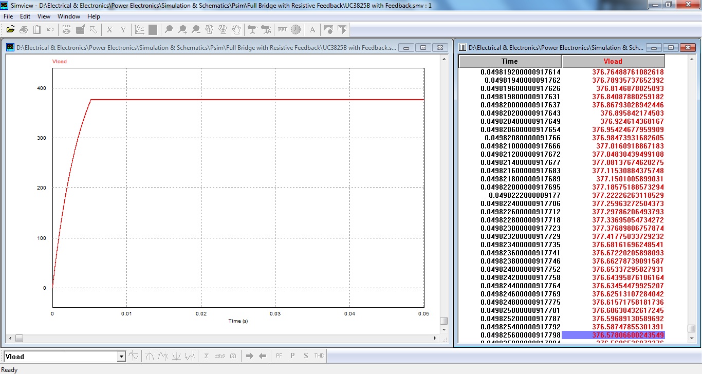

Even i put simple voltage divider feedback, output voltage never sets itself to 370V. I used 1k and 147k for voltage divider. When the input voltage is 30VDC, output becomes 357VDC, when the input voltage is 43.2VDC (three batteries in series), output becomes 376VDC. So, duty cycle cannot be set. It's always fixed i think. I cannot change it accurately. By the way, i didnt use anything for pin 3. So, error amplifier is now being used as open loop.
