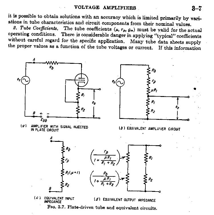

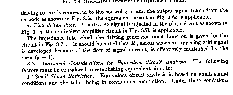

Originally #48 posted by SY
Landee, Davis, and Albrecht just refer to that topology as "plate driven tube." It doesn't sound as mysterious that way.
We have three well known topologies for transistors, pentodes ...
and :att'n: a fourth one for triodes. Thus it don't sound mysterious.
Please note, this is only possible for triodes not tubes generally.
I am very interested in Landee, Davis, and Albrecht text
and schematics about coupling triodes.
I'd like to add this to the blog.
Please show it to me. 🙂 Thanks.
Kind regards,
Darius
I looked in my Electronic Designer's Handbook by Landee, Davis and Albrecht and found this for "plate-driven tube" on pages 3-6 and 3-7:
Originally #50 posted by smoking-amp
Hello Don,
YEEP, thank you very much, this is excellent! :up:
Can I use this attachment in my blog?
I am sure this will help understanding the coupling triode
(i.e. fourth circuit topology).
:cloud9:
Kind regards,
Darius
Hi Darius, "Can I use this attachment in my blog?"
Fine by me, I see the book was published in 1957, so is most likely out of copyright by now. I think Pete Millett's site has some link for checking on copyright status if you want to be certain.
