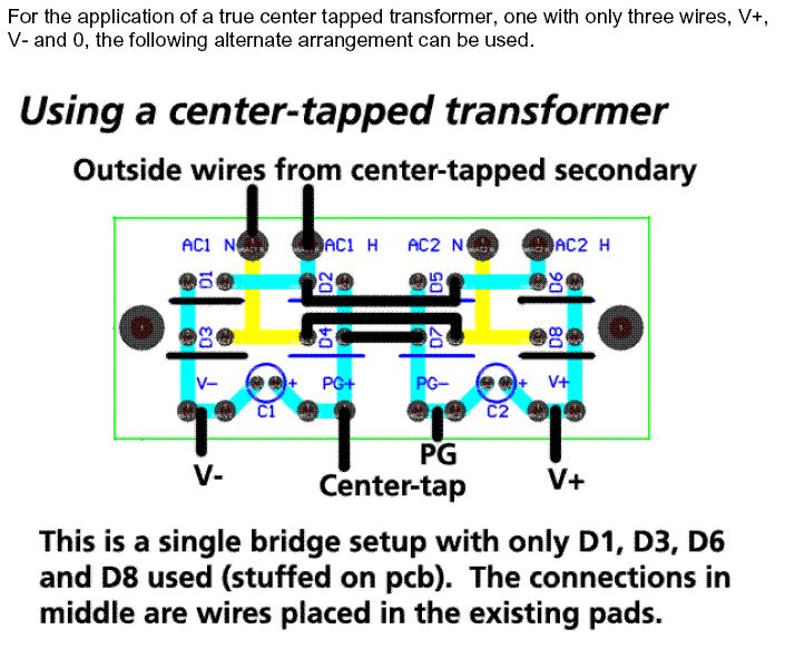

ok so im having an issue. im using brians LM3886 boards. i have a 24v-0-24v ct transformer.
i read on a post of someone using a ct transformer and basically said send 24v(A) to AC1, 24v(B) to AC2, and the CT to both. so i did that and the psb seem to power up good. LED lite up, V-,PG- =34vdc, and V+,PG+=34vdc.
problem is once i hook up the amp board and power up the psb vibrates, basically sounds like hair clippers.:xeye:
ha ha laugh it up. as long as you all find it amusing. jk,
i dont know what the deal is. V-psb to V-, V+psb to V+, &PG+- to corresponding pg's+-.
id appreciate the help if aanyone understood me
From PD's 3875 document...
positive and negative rectifier + center tapped transformer = short circuit... Draw it up and you see that the diodes short the transformer during one of the half cycles. If you have a centertapped transformer, connect the center tap to the common after the rectifiers instead.
The picture Brian posted will work, connect it like that if that is the board you have.
