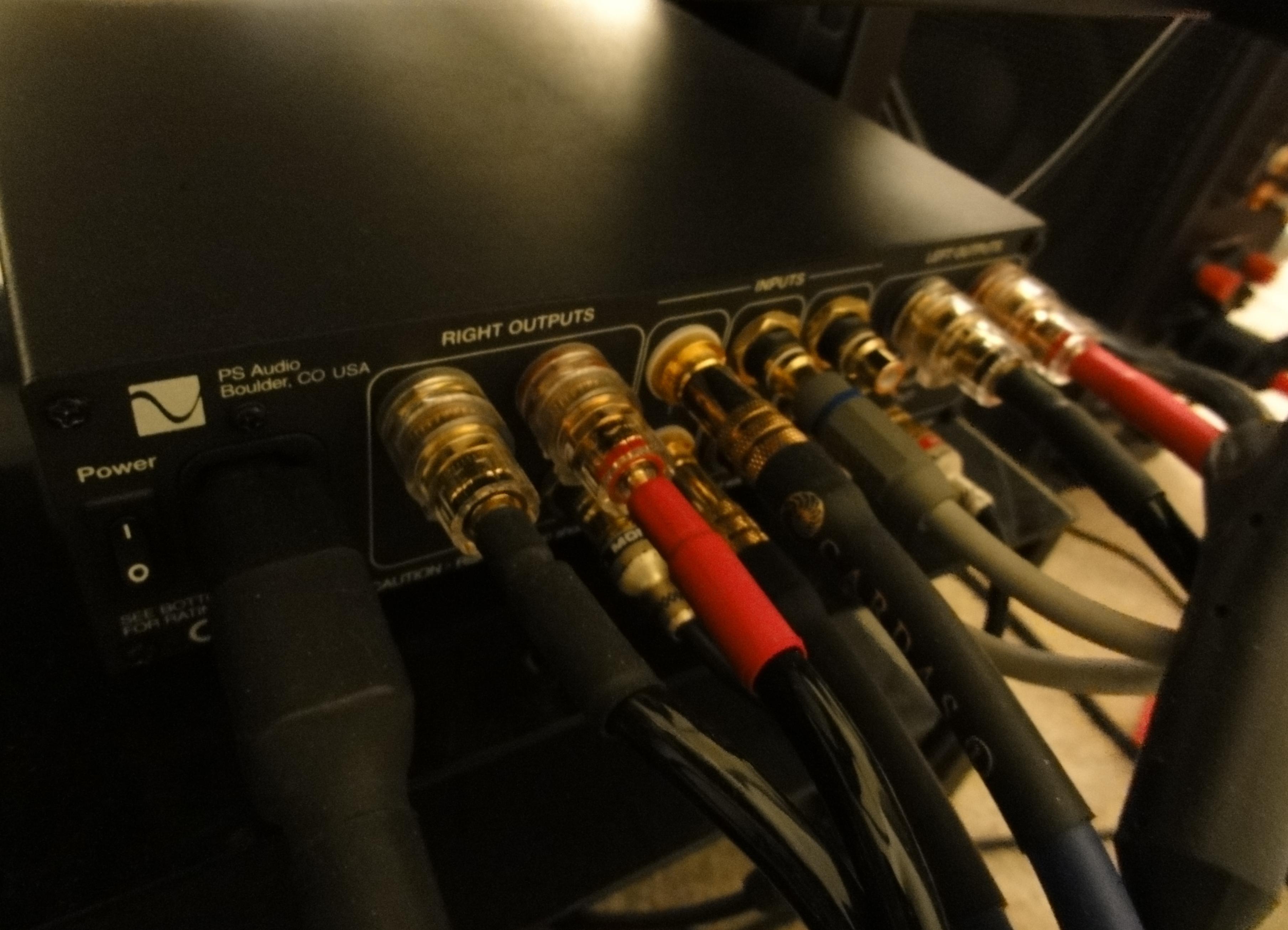

PSAudio Trio C100 with IcePower 300ASC 300W modules

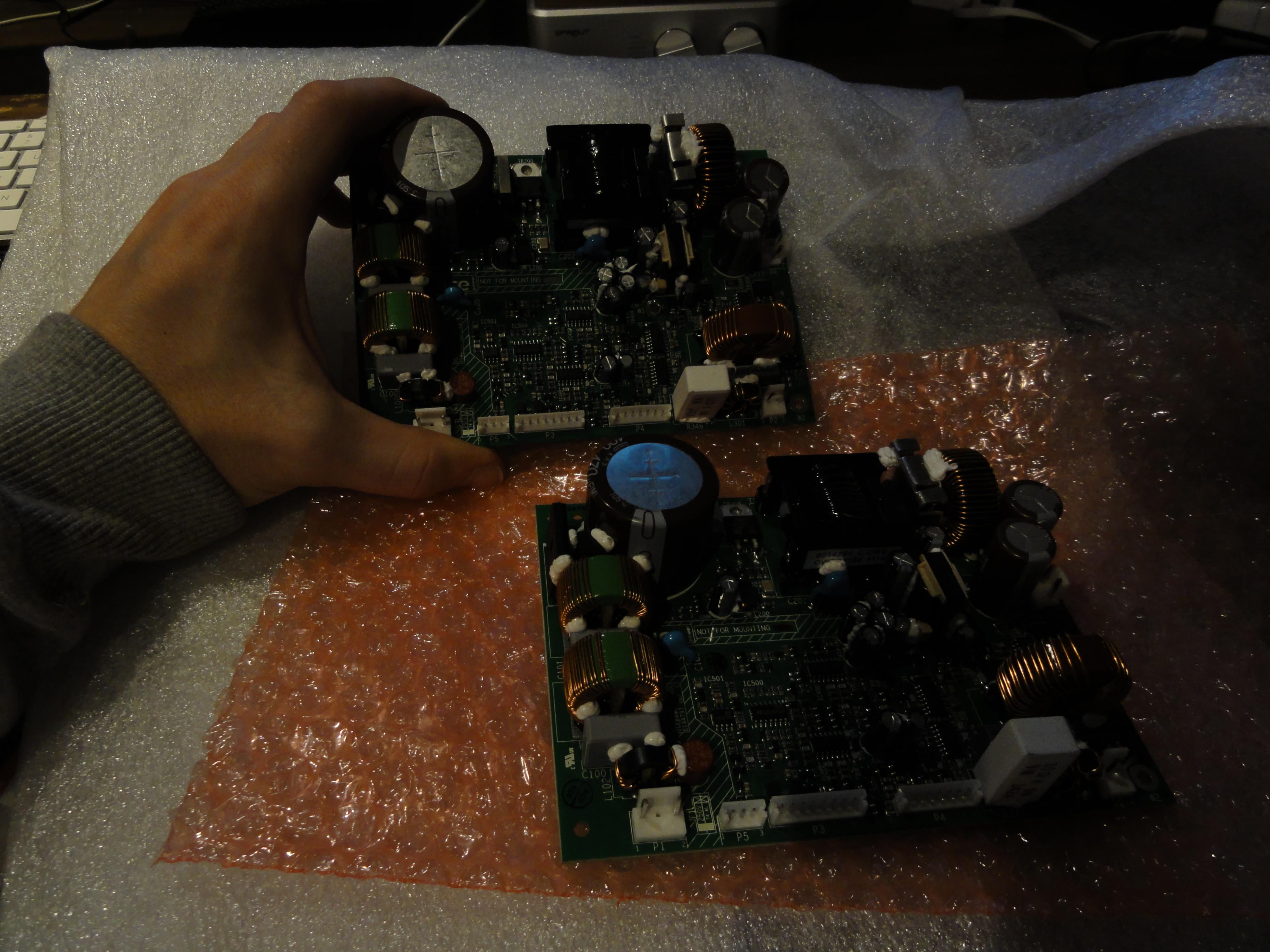

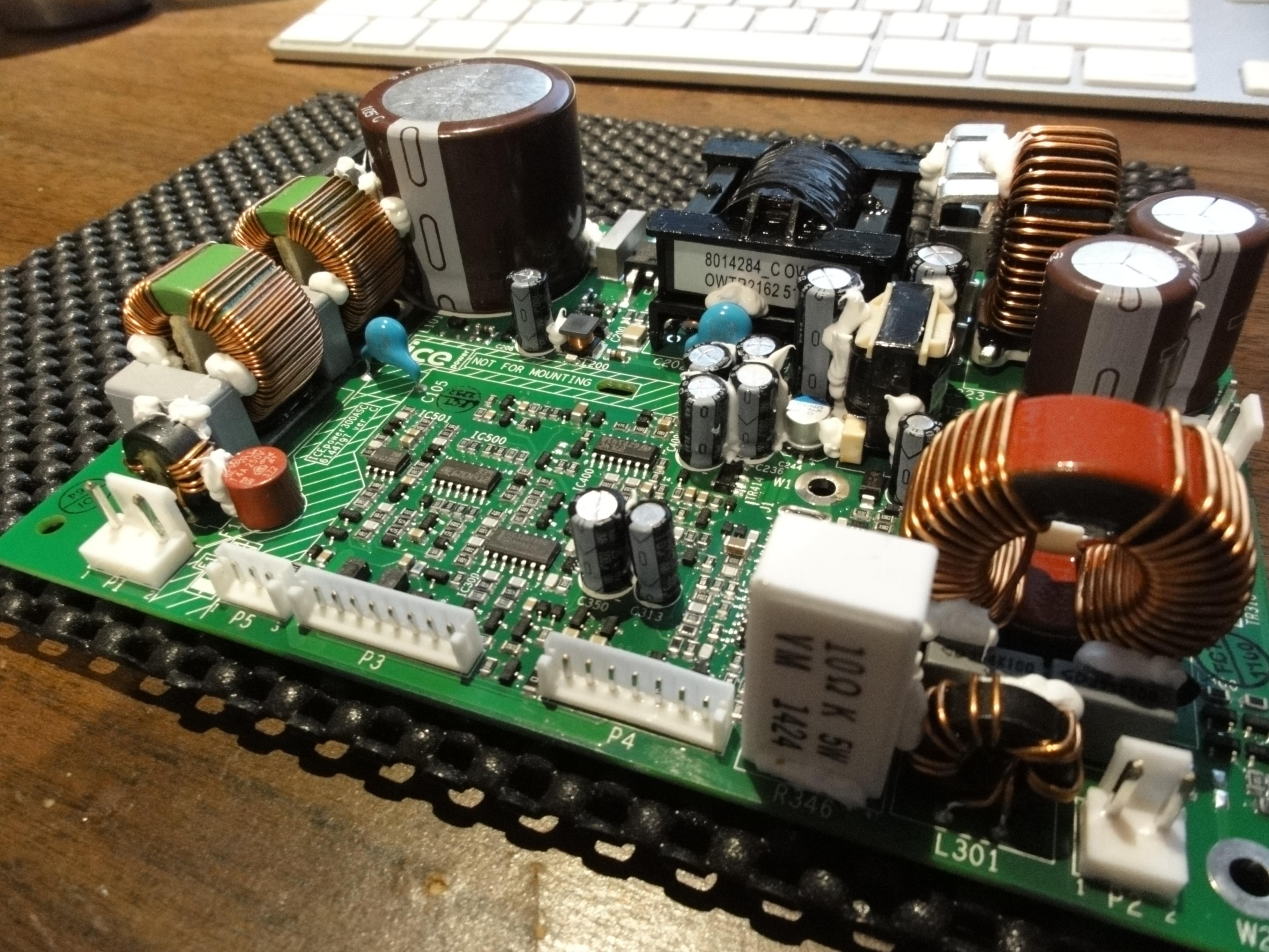

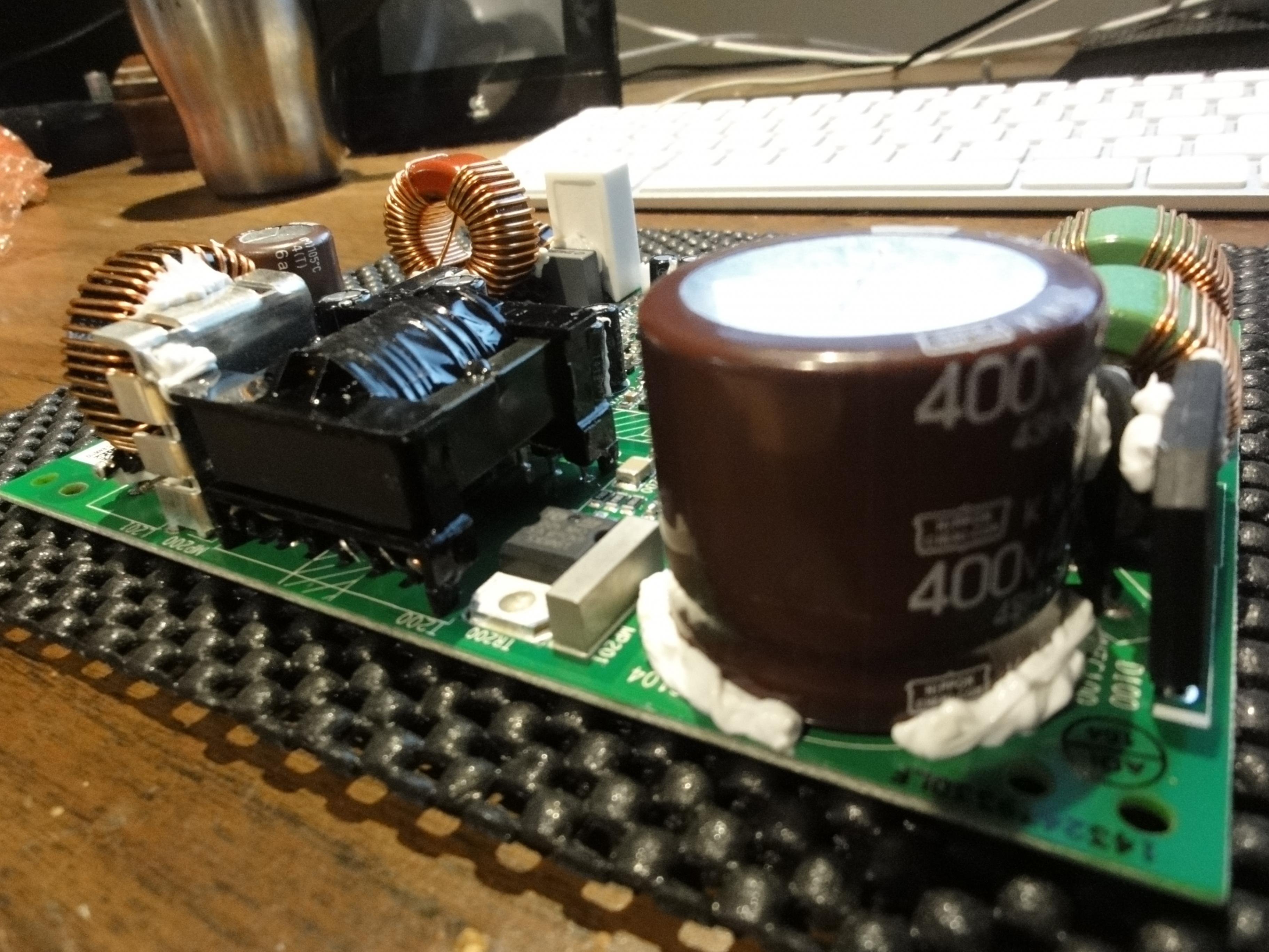

Has anyone tried or listened to the new Icepower 300asc modules? They are drop in replacements for the 200asc (these are in the Trio)

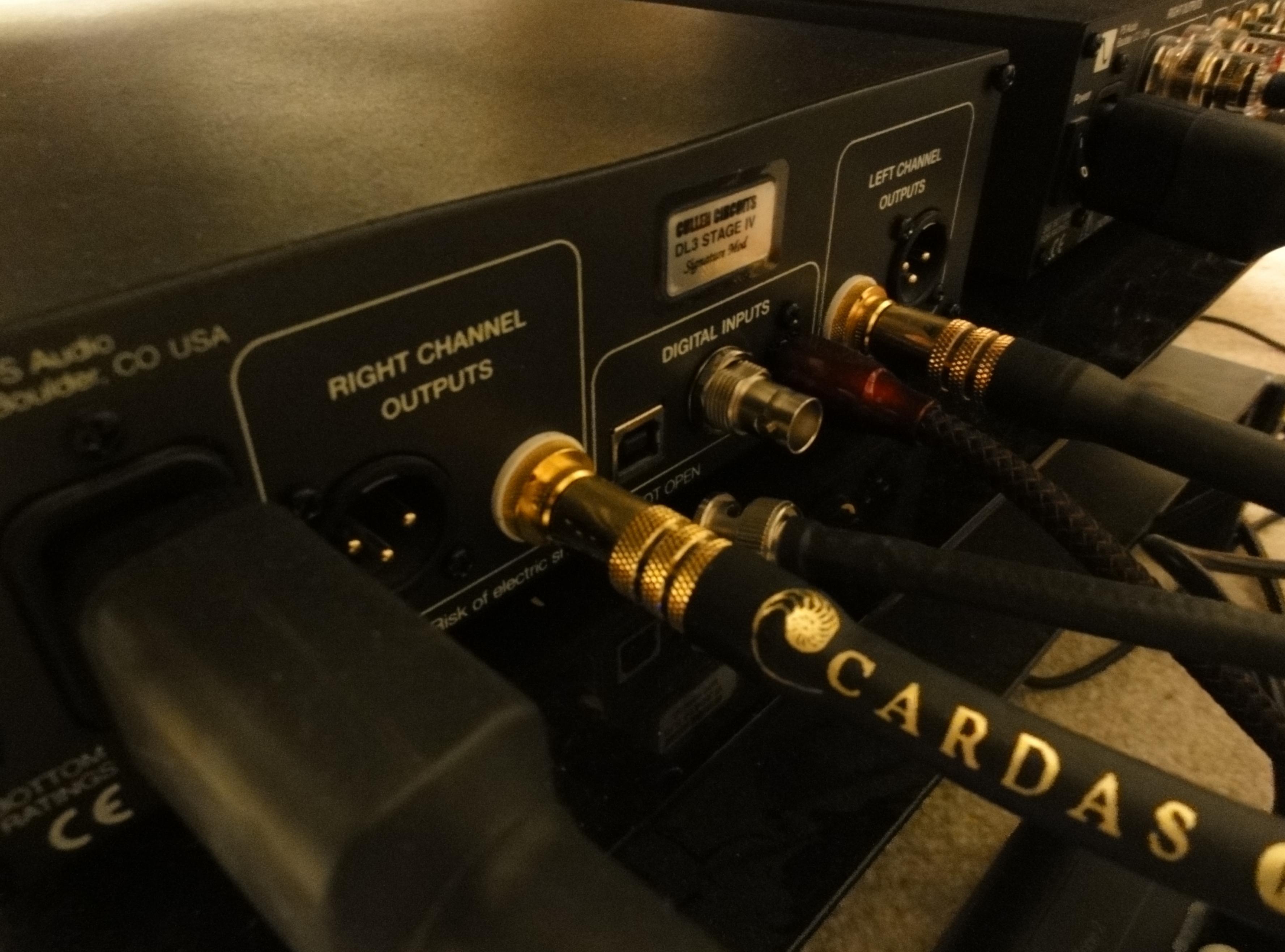

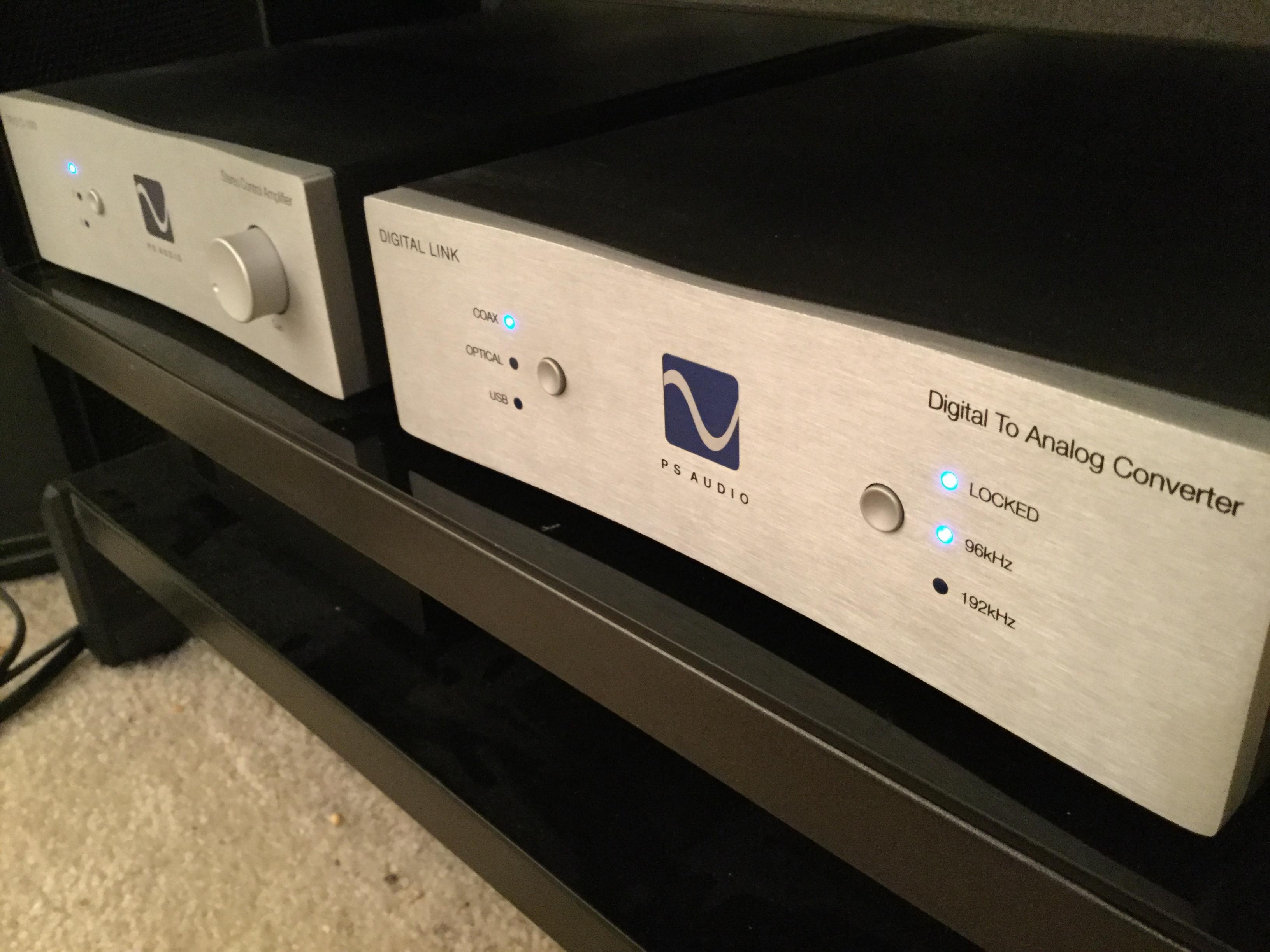

I ordered a pair to give it a try, I have the Trio with Cullen upgrades.

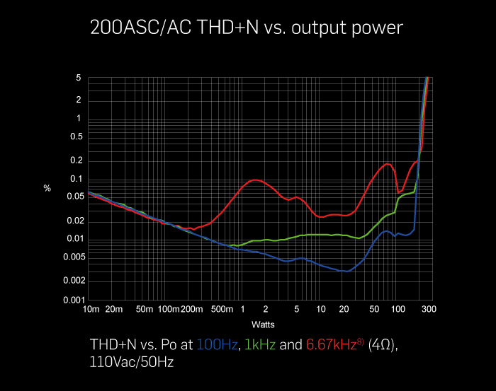

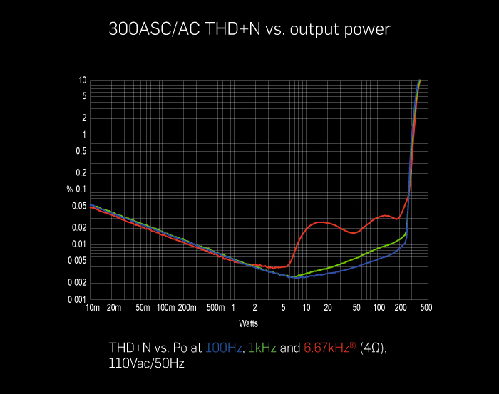

Also looks like the 300asc measure better (distortion, idle noise, dynamic range), in addition to just more output power.
